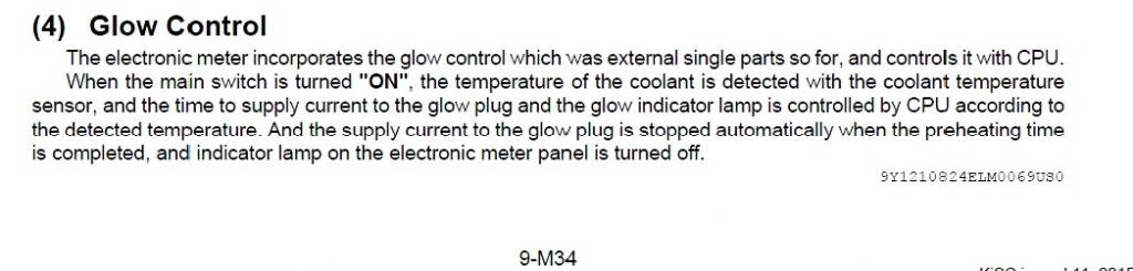

Dave_eng Well-known member Lifetime Member Equipment M7040, Nuffield 465 Oct 6, 2012 5,254 1,038 113 Williamstown Ontario Canada Mar 22, 2020 #2 See attached photo from WSM Also operating description Dave Attachments forum L4760 relay.jpg 47.2 KB Views: 181 forum L4760 glow.jpg 41.7 KB Views: 153 Last edited: Mar 22, 2020
