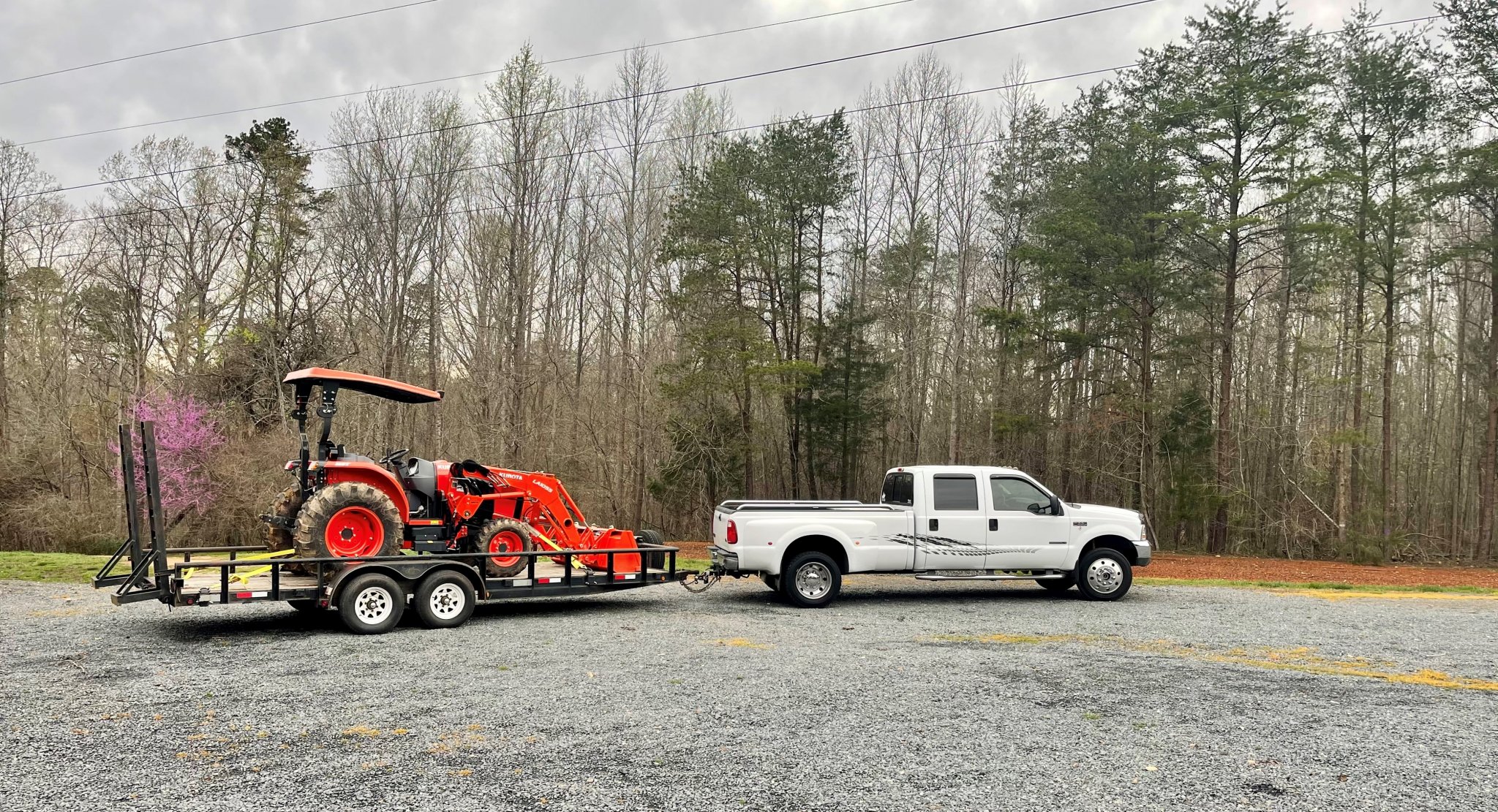

My L4760 on a 20' 10k rated trailer. I have room left over for implements. Make sure you get brakes on both axles, lots of trailers out with only one set of brakes. Also look at ramps or jacks that support the rear of the trailer when loading. The weight of the tractor being loaded can pick up the rear of a pickup truck. My dealer says it happens enough that they have the equipment owner load the equipment. IMG_2454.jpg

yes, 'feet' on the ramps are a must ! BUT..paint them bright friggin YELLOW immediately. If you don't know why.....report back in 3 months with YOUR shinscar pictures....

It also helps to remember to raise the jacks before driving off.
