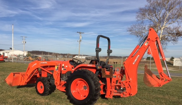

I own an L4701; I need a backhoe. I was looking at a BH92 or BH77. However, going to the Kubota website, it's hard to get any available attachments for my tractor. I would assume it would be a lot easier. But what list (if any) of available backhoe attachments for a L4701? I need a good backhoe attachment, long reach, beefy. Is the BH92 the best I can get?

your dealer should be able to get you the list of all available backhoe parts and pieces you will need. The BH92 is beefier than the BH77. I own a BH77 and used to own a BH92.
Or you could try another makers stuff or even a non OEM and try and Frankenstein something together if you are a good fabricator but pretty sure in the long run this will end up costing more.
3pt hitch hoes were popular at one time if you are looking at fab'ing something together. Not so much now as definitely not as beefy and for some would actually damage the tractor.

Standard backhoe for the L4701 tractor is the BH92... Tractor Data

"I need a good backhoe attachment, long reach, beefy"
You need a different model Kubota tactor!
An L47 TLB.....10' dig.
or
An M62 TLB.....14' dig.
