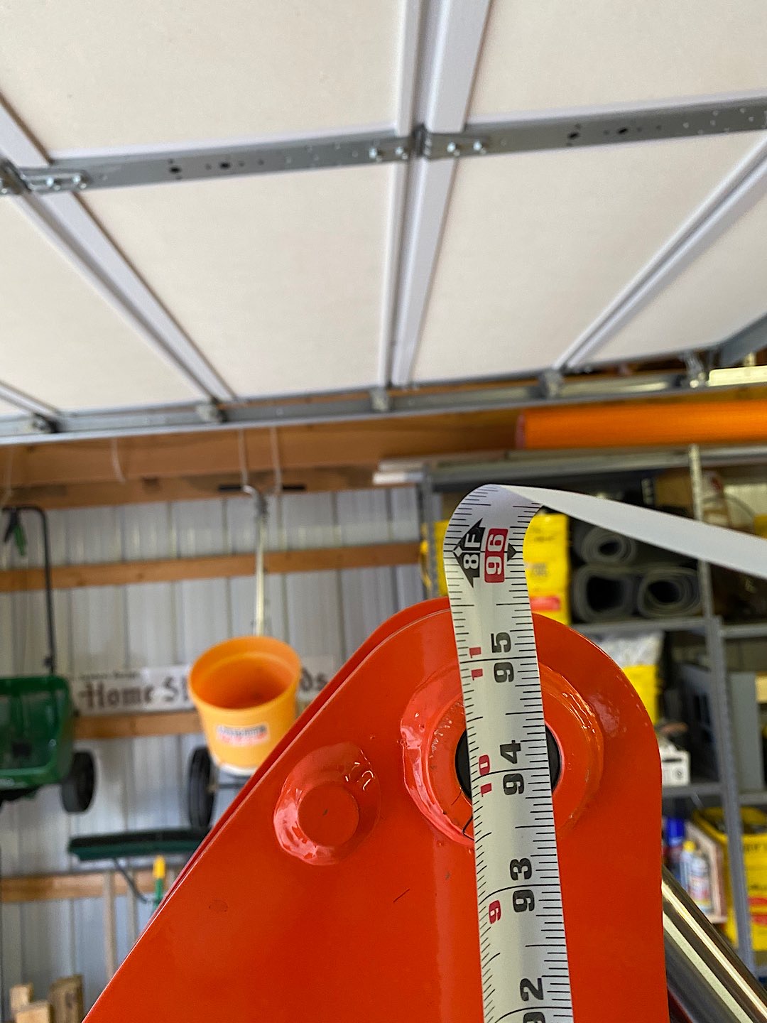

Well, thanks for the replies, I should have been more clear why I was asking. I'm looking for temporary storage on my property until I build a garage next summer. I'm considering building a temporary lean-to just to shade & keep the snow off. So dimensions are flexible, but I was targeting the 8ft height of the cab and realize the backhoe comes into play as well. I'll check youtube to see what i can find.

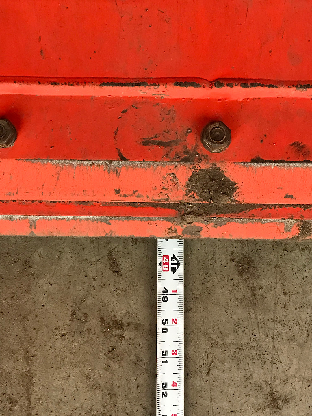

Here’s height of BH in transport mode. I have R4’s.

Awesome! Thanks for finding the video. Just watched it and he measured exactly what I was looking for. Thanks also for measuring the height of the backhoe when it's in transport position. I also ordered the R4 tires, so it will be very close. I can't thank you enough for the help.

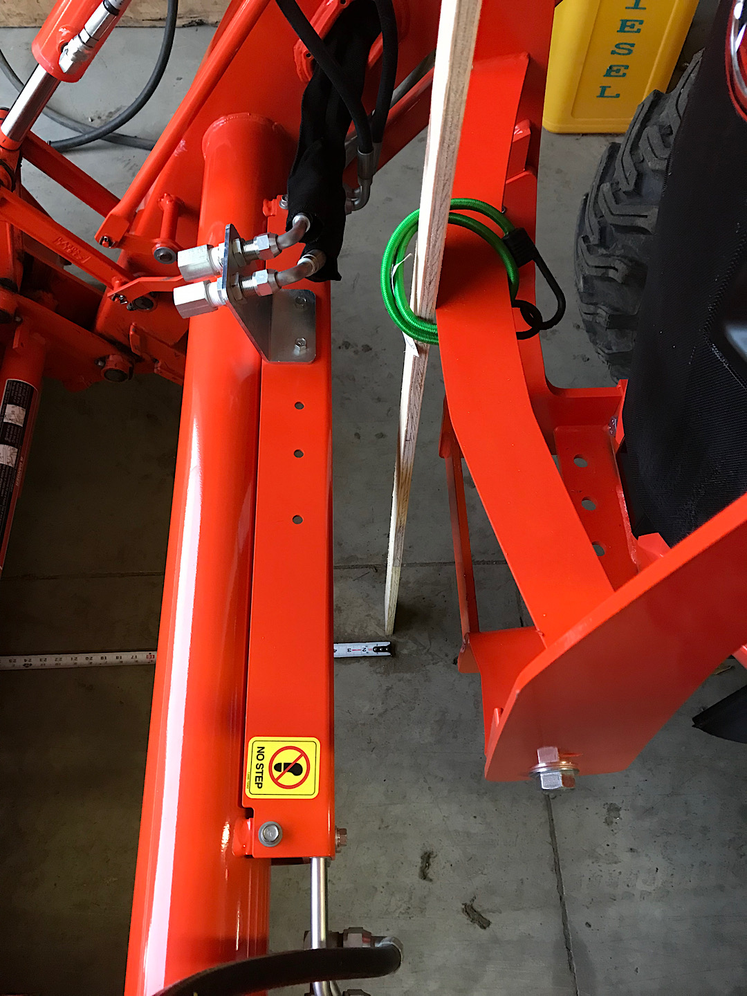

I have the HD bucket with bolt on edge and my bucket is put away, snow pusher is on. I think I measured from the front of the bucket to the brush guard for someone recently - I can take a 2nd measurement from brush guard back to rear tires if you want.
Here's those measurements:
