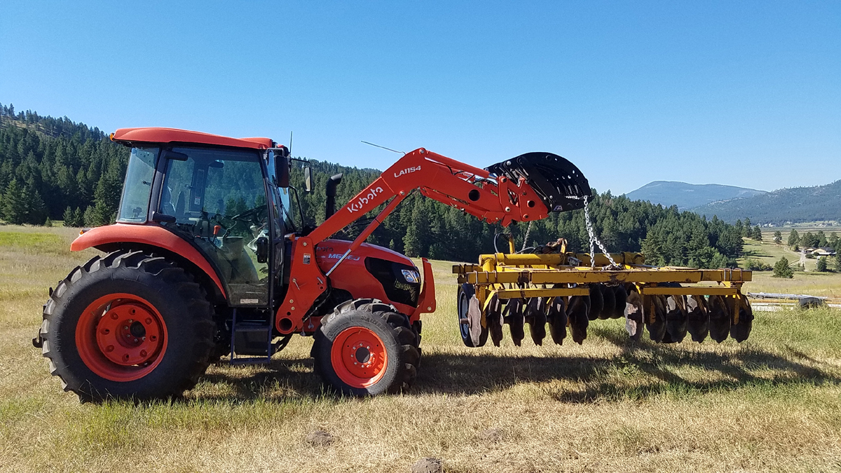

Oh really? I couldn't pick up this disc harrow before the rear tires were filled with beat juice and wheel weights added. Weight on the rear axle does make a difference and it can make a significant difference at that. You want to guess how much that Schaffer disc harrow weighs?
Ok, wild ass guess here, 1580 lbs.?
