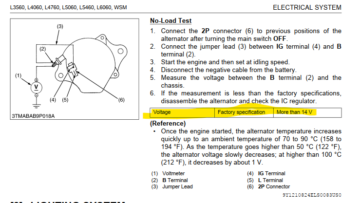

If I'm reading the WSM correctly, it should be at least 14v
