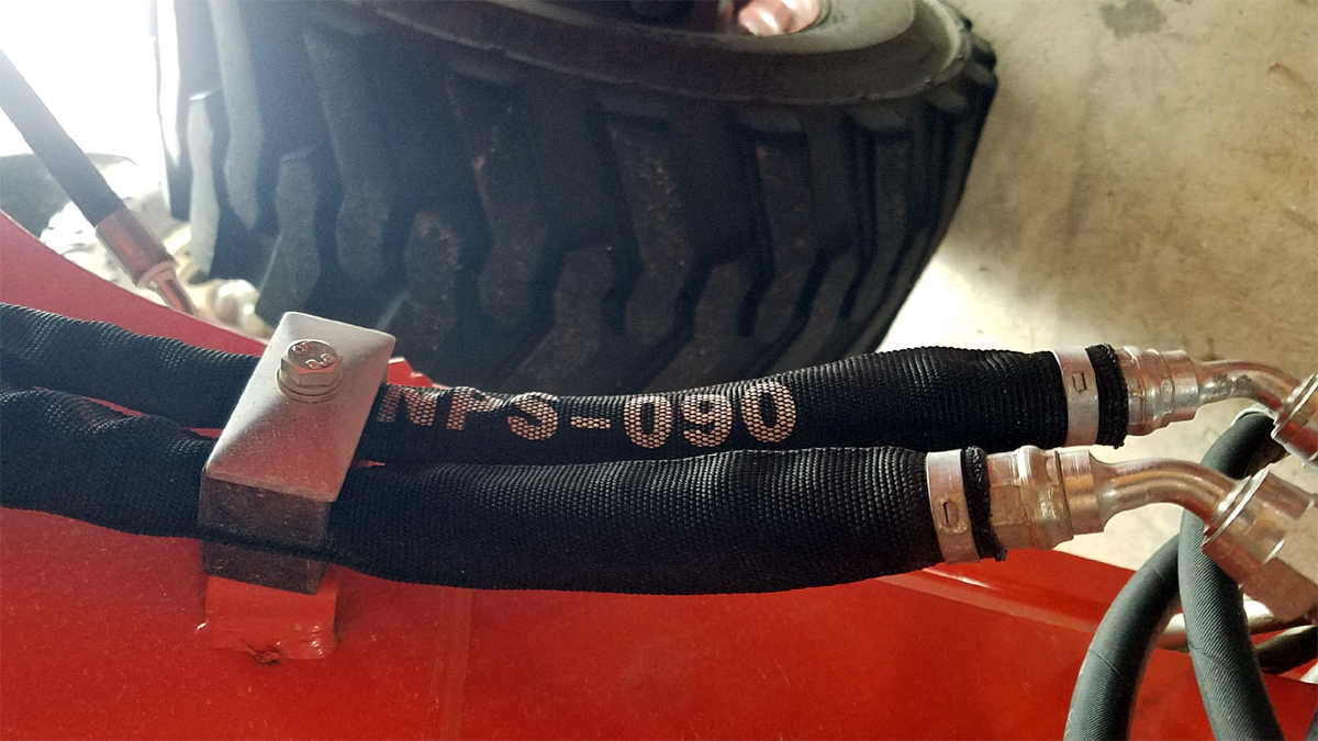

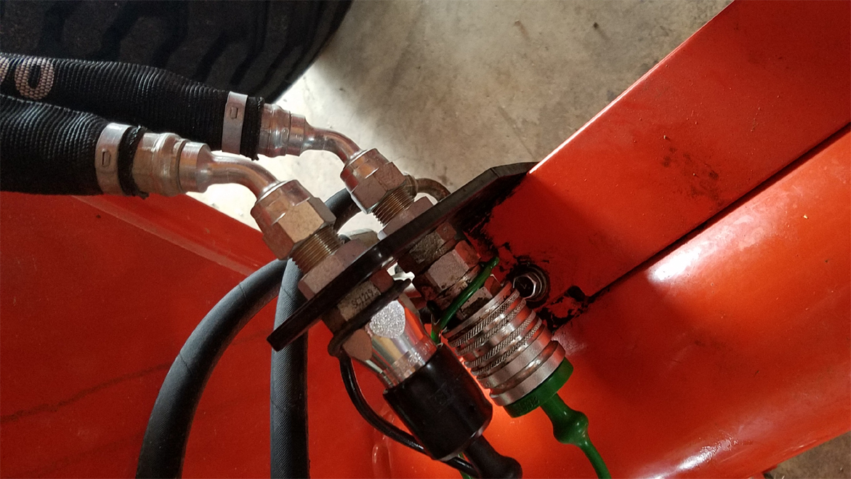

I've always chosen the factory options for all four Kubota tractors that I've purchased, and that includes rear remotes and 3rd function. Is that the most economic route, maybe not, but with the cost of these tractors I'm not focused on the "economic" solution unless the factory one is of poor quality and/or poor execution.
I've found Kubota/LP 3rd functions and rear remotes to be excellent and they look and feel factory. That's important to me and that's why I've purchased four 3rd functions, and three sets of 3X rear remotes all from the local Kubota dealer.
With the factory 3rd function you get a nicely integrated system rather than some generic, thrown together, obviously not factory, product. The protective sleeves, the stainless steel bands, the brackets etc., all look factory.
