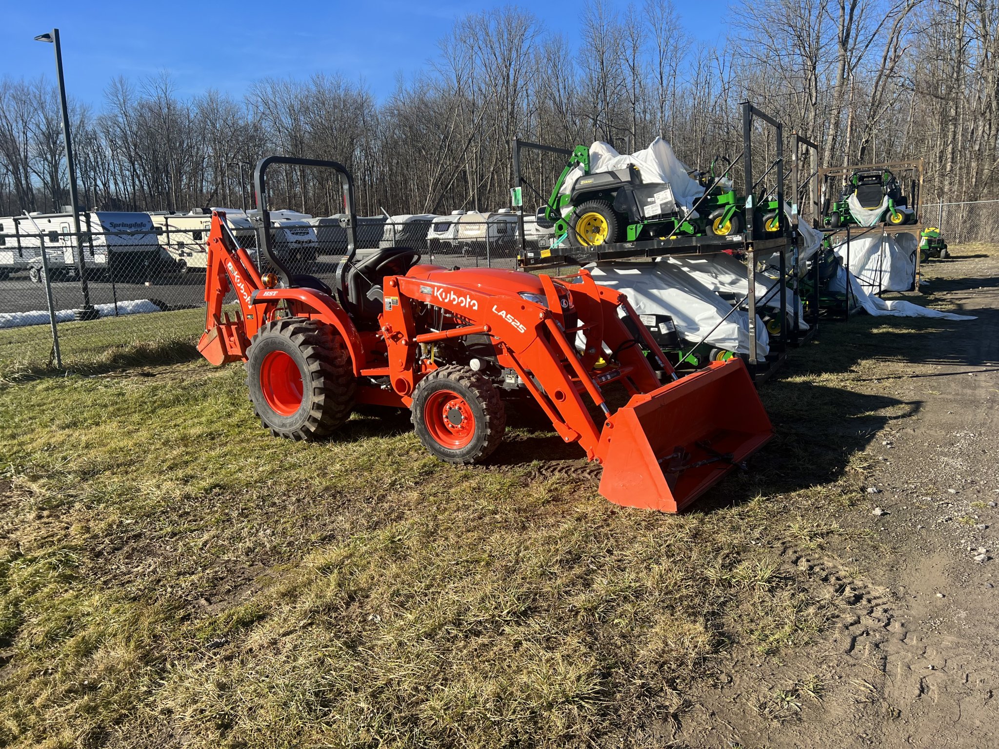

I am taking delivery of a slightly used L3901. It has the bh77 mounted and that’s it.
I have a grapple I’d like to use and also I would like to have rear remotes for top-n-tilt and maybe use one for a backhoe thumb/post hole drill.
I have read through many online posts but none with exactly my situation.
For the front I believe the Summit valve is a good (although $$) solution. It looks like it would install between the loader valve PB and the backhoe feed. I think I really only need an electric valve and a switch. The question I have is the electric valve in the kit has a T port out. Is there something to turn that into a PB like on the P40 valve?
Then on the back I believe I would take the feed from the 3rd function and route that to the rear remote valve. From there the PB out would feed the backhoe and the return from that would remain the same.
Does all of this sound logical and correct? Any suggestions for an 3rd function valve? Any suggestions on mounting the rear remote valve? I’d like to have it under the seat but the levers would be miserable to articulate.

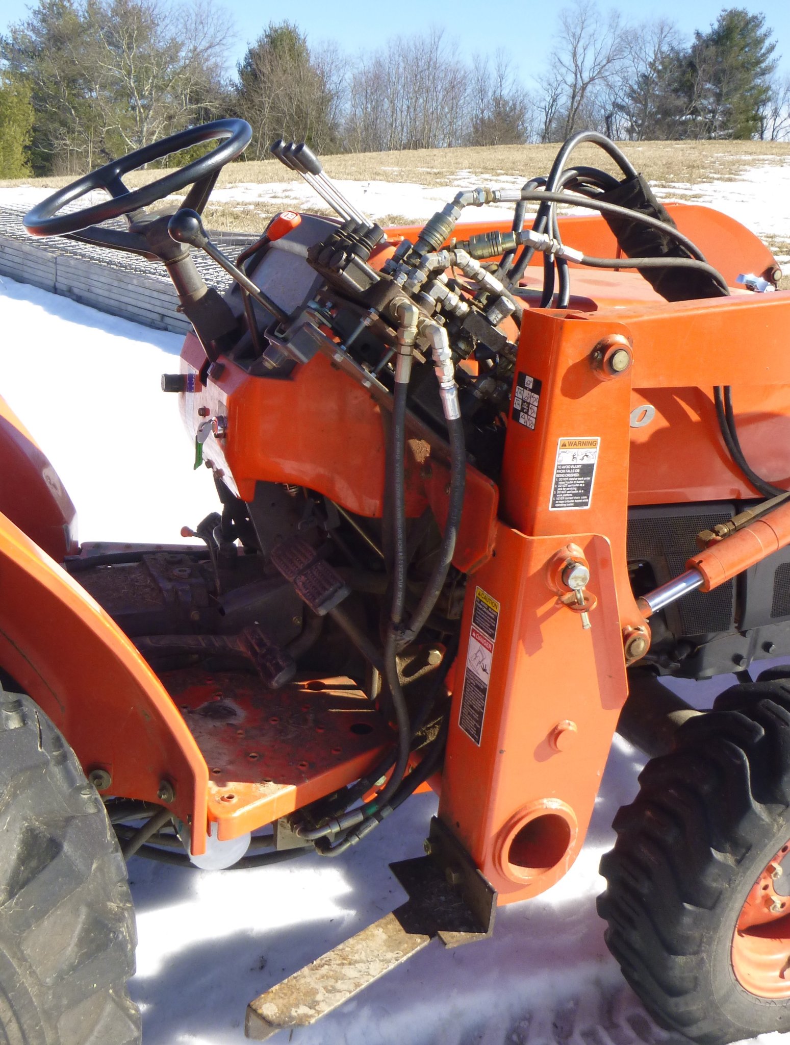

I have been all over my L3901 trying possible locations for the remote valve. Right fender is probably easiest. Under the seat is more doable than you might think.
Spend some thought on how you want the outlets to mount and operate especially with the complication of the backhoe. I am not a fan of the "economy" setup Kubota supplied as OEM.

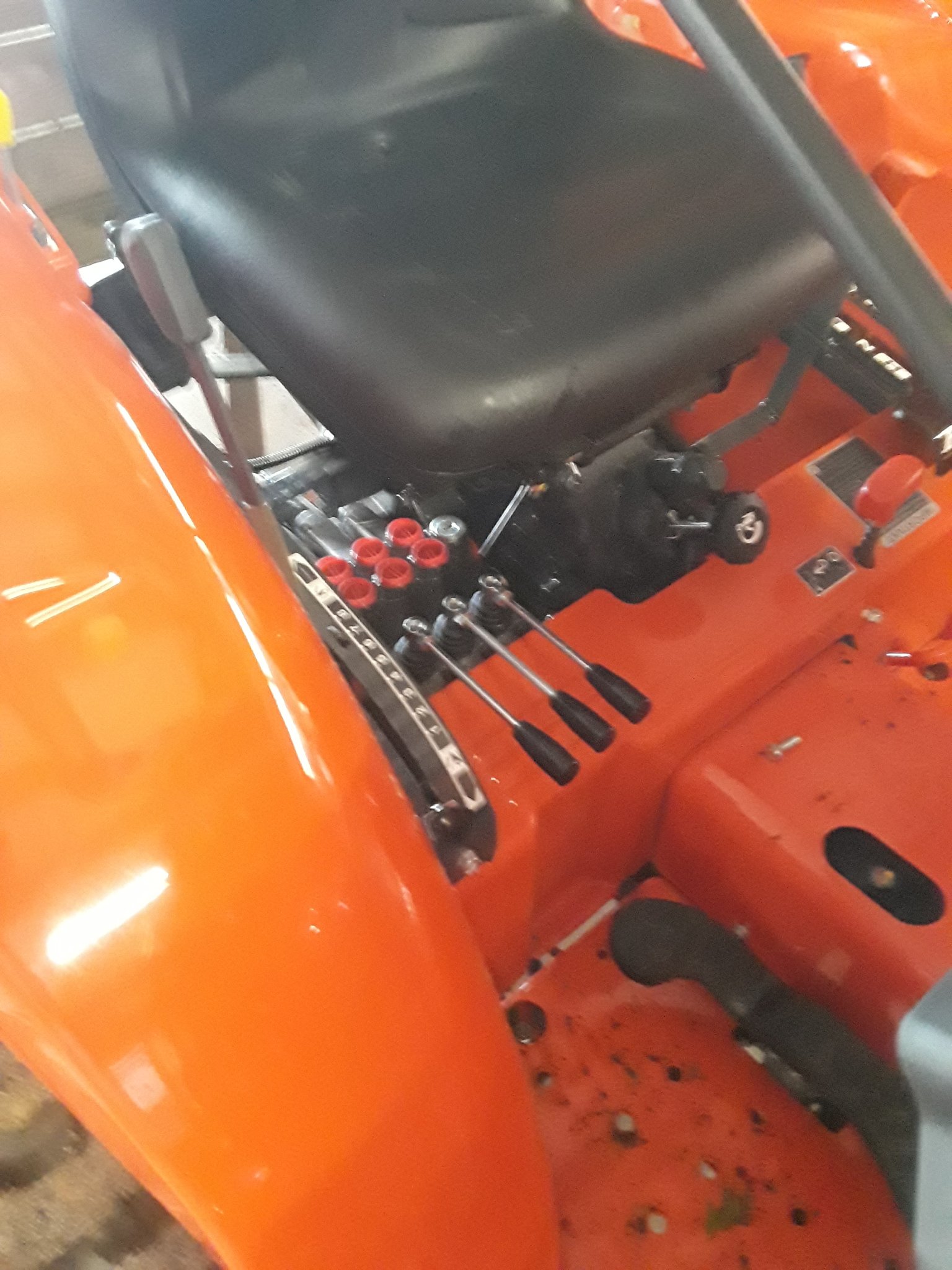

L2800 HST; 2005; R4
This is where I mounted my 3 spools, I mostly use the grapple and it's not a problem with top-n-tilt hydraulics in the back... I used the same hoses from the FEL and attached them to the new spool. Only other hose I had to buy was going from the old Power Beyond (high pressure out) to the "In" or Power in port of the new valve a few inches above the FEL valve... I have needle valves for the Top and tilt so they can be feathered precisely.

Thank you all for the help and the pics! Just don’t want to muck it up.
I’ll probably go with the 3rd function first and spend some time planning the rest.
Any suggestions on an electric valve ? Ideas for switch mounting?
Or just buy the kit as it’s pretty good deal??

That was part of my confusion- why is one T port ok for power beyond and another one needs a PB adapter. How is one supposed to know the difference?!?
I am liking that valve location in your pic. Just trying to figure out how to control if I decide to use a BH thumb.., maybe add another electric after rear valve and before BH?
Im in the process of installing a 2 spool on my 3902. Do you have a photo of yours all mounted and hoses ran? I think I see how Im going to mount mine, but its usually helpful to see the results of someone who‘s done it prior.
