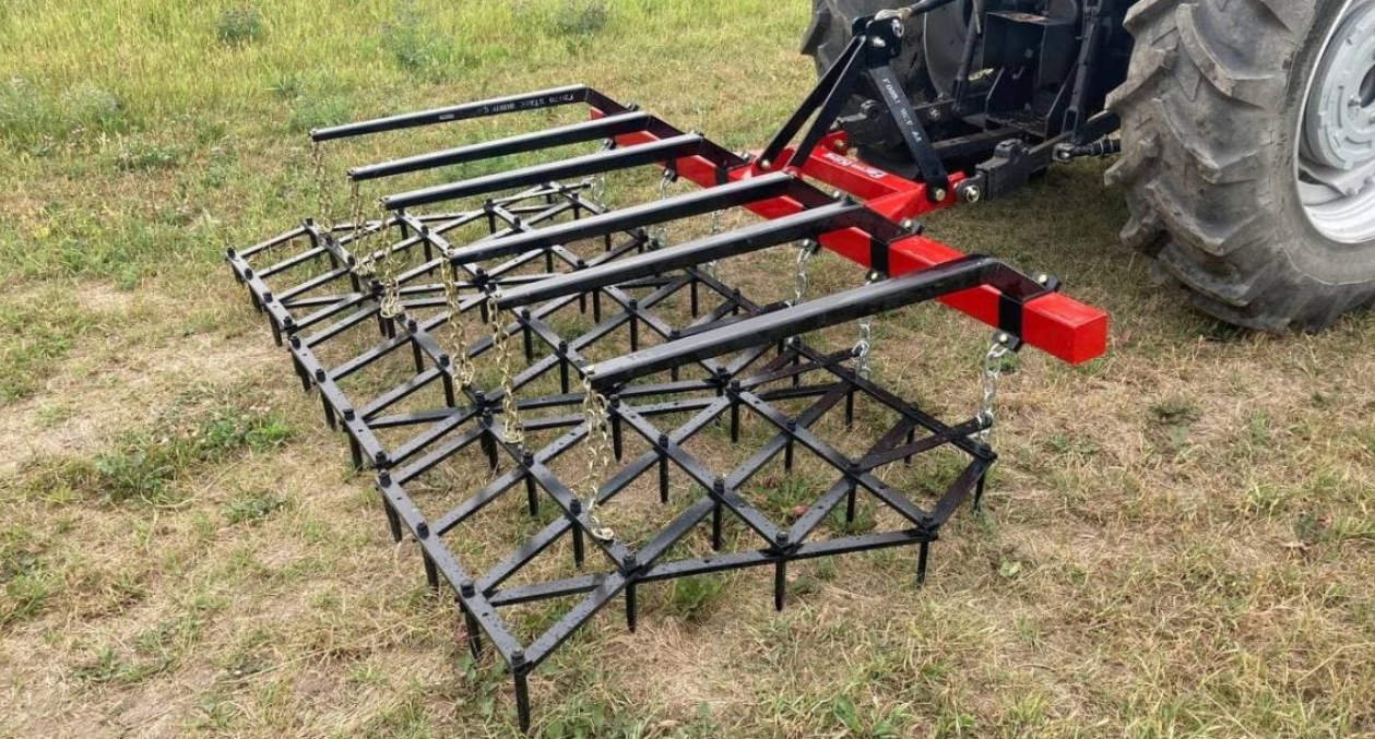

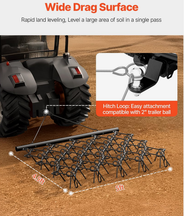

gotcha..... for lighter duty / less penetration would a drag harrow suffice?
About 1/3 of the cost with new ones being found in the $500 range.
this one called a chain harrow in these parts. comes in lots of different sizes and takes almost no hp to pull.
farm king makes one with solid spikes.
I have piles of these in our yard all probaly from the 40's and 50's.
Collected over the decades. Used to be wickedly popular now just scrap and no value here. They guy who runs our local dump pulls these out of the pits for me as for some reason he thinks I need to have everyone ever made. i never use them (haha) but he has a very kind soul and often comes up with some good stuff from time to time.

I've got one of the drag harrows (your 1st pic). It's not disruptive enough. Could you compare the solid spike harrow to a landscape rake? If it's more disruptive that might be a good option.

mine are all stored near my woodsheds under about 2' of snow so some of this is off the top of my head. If you were close by you could take a few and give them a try. $ wise they are mostly worthless now other than scrap but being 1,500 miles west of me likely not worth a road trip.
Spikes about 6" in length. These drags seem to always get stacked with cinder blocks or lengths of firewood for weight to get penetration even though we are in a sandy soil / soft soil area. The extra weight gives us the penetration we need. More weight / more penetration. So max. penetration would be the 6" length of spike.
To stop going too deep some have 4x4 wooden blocks bolted between the spikes. These skids limit the max penetration to whatever the thickness is of the wood blocks. Wood block have 45 degree face on them to let skidding happen easier. 4" thick wooden blocks would mean spikes limited to 2" of penetration.
So add as much weight to top as needed to get desired penetration. I remember more weight the better. Cut 4x4 blocks to desired thickness to limit penetration. That way you can get exact where you need.
last time I remember using them was a while back where pasture seed was broadcast over a disc'd area then over worked after seeding to level ground a bit and cover at same time. Or after we broadcast manure on Mothers gardens we would work in the sh@t just a little. Now days we have to inject all manure on commercial fields. Given price of seed today doubt anyone do that anymore and given the new environmental laws I doubt a trailer mounted manure flinger would be acceptable to the environmental police in commercial sized farms.
Setting depth is simple combination of adding extra weight for better penetration and thicker wooden blocks / skid to limit penetration. This is on the old style. maybe the new ones have way to limit the penetration built in. I have no experience with new designs. i also have no experience with landscape rakes . Sorry
