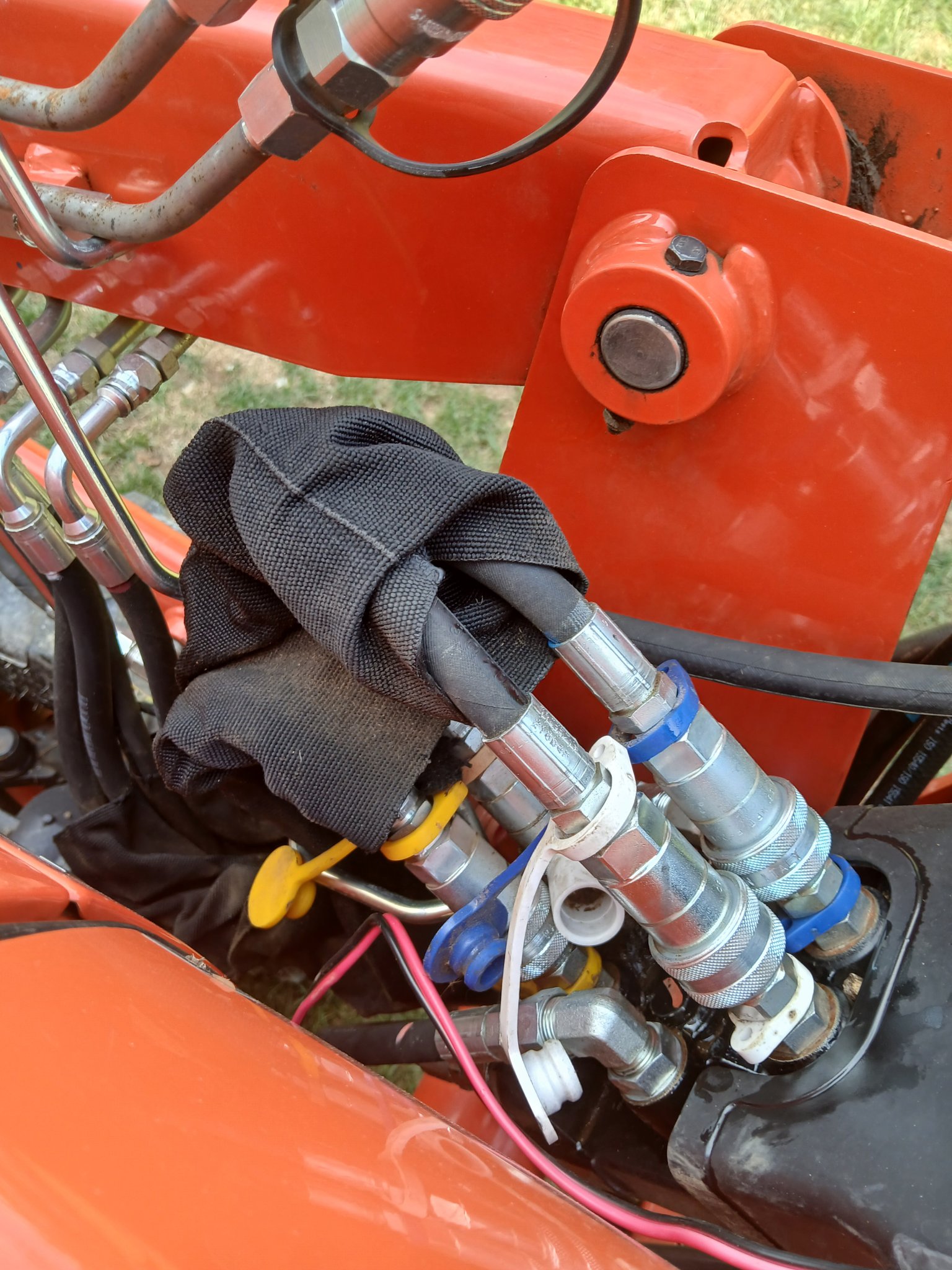

No offense but thats the sort of faulty logic that has lead you astray already.
The color coding is on the nipples and sockets and you had them all off the valve and could have scrambled the positions up. The nipples and sockets are matched but on what ports?
Here is a picture of the proper placement. Verify that matches yours and then we will test the boom operation. Its quick, easy, and definitive.

Alright this is how to test the couplers and the valve.
Put tje loader on the ground, shut the engine off, and jiggle the joystick to relieve all pressure as best you can.
Disconnenect the white female coupler
Remove the white nipple from the valve and put some tape over the port to keep dirt out.
Connect the white couplers and put the end of the hose in a clean coffee can.
Start the tractor and very carefully move the joystick to the raise position. DO NOT MOVE IT TO LOWER OR YOU WILL GET A HYDRAULIC OIL BATH..!!!
If the valve and both sets of couplers are working the loader will raise and the coffee can will fill with oil. Stop before it over flows, put everything back on the valve, and dump the oil back into the tractor.
If the loader does not raise remove the hose from the female coupler, put the hose in the can, and repeat the test.
Lets stop here and wait for your results.

Did as directed but results not expected: very, very careful joystick movement kept oil spill to a minimum but it came from BOTH the hose and the open valve port. Interpretation?

Yes - direct observation not deduction.
By all means go slow and be careful with that port open. Idle speed would be wise. If it was here I would put a plug in the port not tape.
12,566
7,157
Open port is connected to power beyond which should be open to tank so may be enough back pressure to pump oil that direction. A plug would be nice.
Oil came out the couplers or out of the hose?

I did the test, at idle for sure. I covered the naked port with a cap too large to screw on but covered the naked system. Results were unexpected: fluid rushed from both the hose and the naked port. I was very careful pulling the joystick so only my hands and arms were oiled.

Out of the hose through the couplers
12,566
7,157
Put the male coupler back on the port to block it. Remove the femaĺe from the hose and try again
