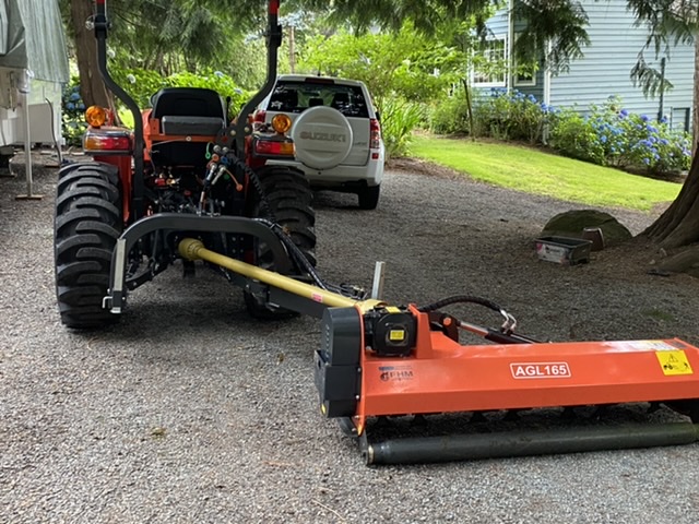

I have an L3901 and a Betstco 65” ditch bank flail mower.
I have no extra weight besides filled R4 tires, and the front end loader.
It handles it just fine, no power or stability issues at all.
It will lift the mower when extended, but when you’re mowing you have it riding on the ground on big roller under the rear of the mower. You only lift it when you’re gone run over rocks or something that will bust hammer teeth.
I’ve used it as counterbalance when on a side hill, I extend it out on the uphill side.
The 3901 does fine with it, I’m actually pretty sure a 2501 would be fine.

Have you used it trimming with it at a 90 degree? Any problems with the weight then?

Joemonstermaker
Kubota L3901
Oct 10, 2020
10
Seattle WA
It’s still ok. The bigger issue is the flail doesn’t really mow as well when it’s up in the air, it works a whole lot better when it’s against a surface. But when it is, it’s amazing. It turns everything to mincemeat.
I also have a 5” rotary mower, most are familiar with them, and it has it’s good points, but nothing leaves a clean pulverized surface where there was stickers, overgrown grass and who knows what else like the flail does.
Even on level ground the offset is cool. Once you have one pass cut, you can drive over the mowed part, with the mower off to the side grinding through whatever it is, and you don’t have to drive your tractor through it.
