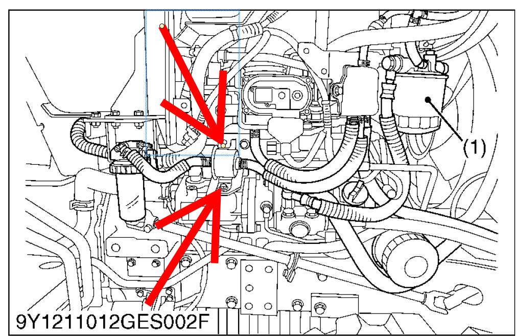

L3901, 2017 Fuel System Component, what is this component?
Dchemphill1
L3901HST, brush hog, L525 loader, rear blade, forks and bail spike
Jun 9, 2016
110
46
Fort Calhoun, NE, USA
It almost looks like a pre filter...because 1 is the diesel filter and to the left of your arrows is the water catchment.

Well, thank you for taking the time to educate me. I have not seen the wires while going over the actual part but I have not taken it apart.
I replaced the fuel separator and the fuel filter. I had an algae problem, but after replacing it never starts, while turning over. I will take it apart and try cleaning. hopefully it does not need replacing.
Thank you again.

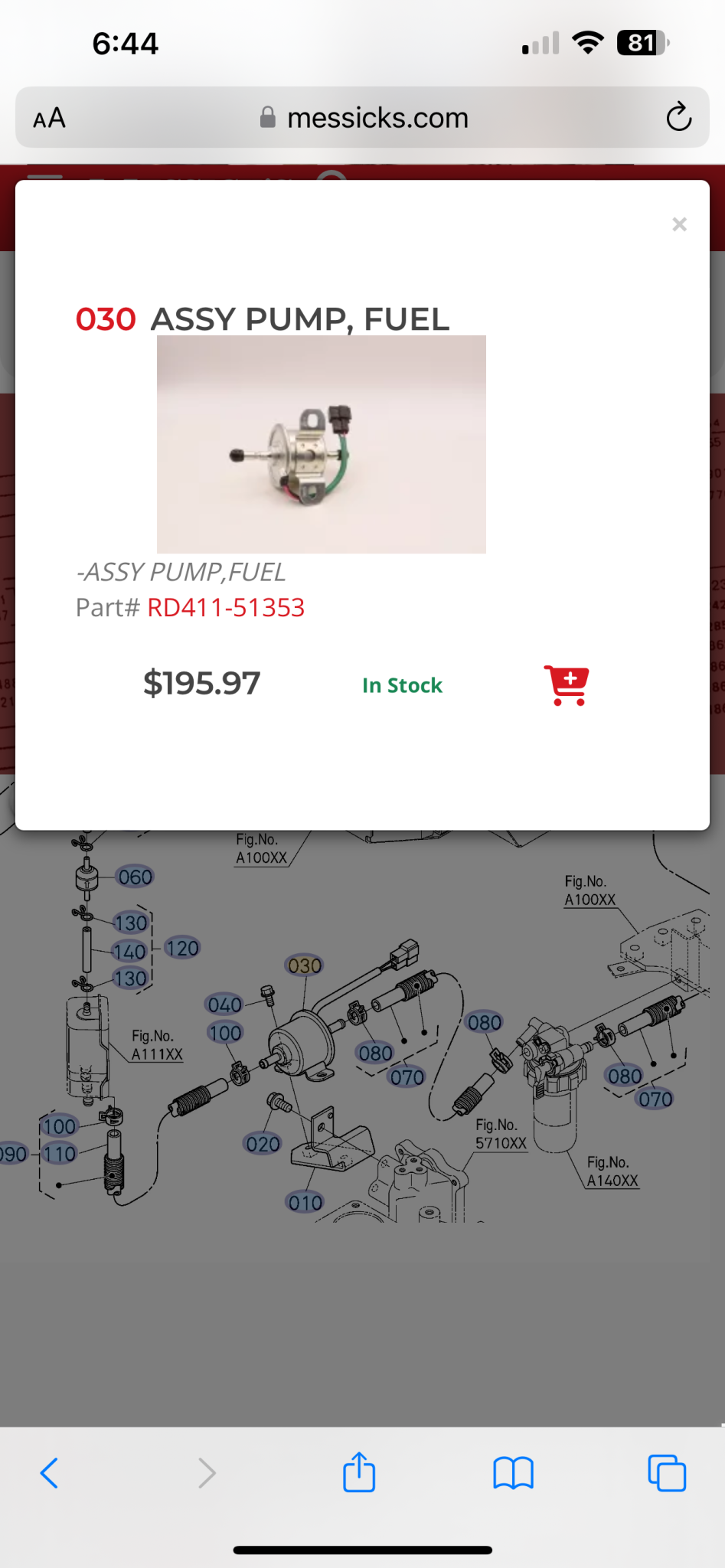

that pump could be full of algae. see if you can clean it, bench test with fresh fuel,you should get good pulses of diesel.
I've used these...
as 'transfer' pumps in the past and ran a 30HP forklift for several years.
Might be worth the $10 CDN, if only to prove you may not need the $200 pump.

If you would help me with something stupid, I bought the fuel lift pump but cannot figure out how the electrical connector comes apart.
Can you post a clear picture or two of the connector? Could be a push button to release or you may have to pry a tab up to separate them.
