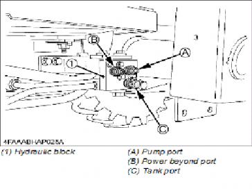

I just got an aftermarket loader and I can't seem to get the hydraulics connected properly or the control valve is defective. The instruction is only a picture which is hard to follow. The loader looks well built and because the tractor is older I didn't have a lot of choices for a quick detach loader so I got the one from Ansung-USA made in Korea.

Is there a valve lock on the control?
Pictures of the hydraulic block, and control hookups would help.
Also relevant instructions.
And model number for Ansung front loader.

Diagram of hydraulic block for L3800. Control for the front loader should be marked P for pump, BY for power beyond, and T for tank.

Ansung instructions did not help me. I called and talked to a lady at Ansung and she was no help. Finally my brother in law and I moved the line for tank and it started working. Good thing I had the internet to help me to get it working. Thanks for the comments.
