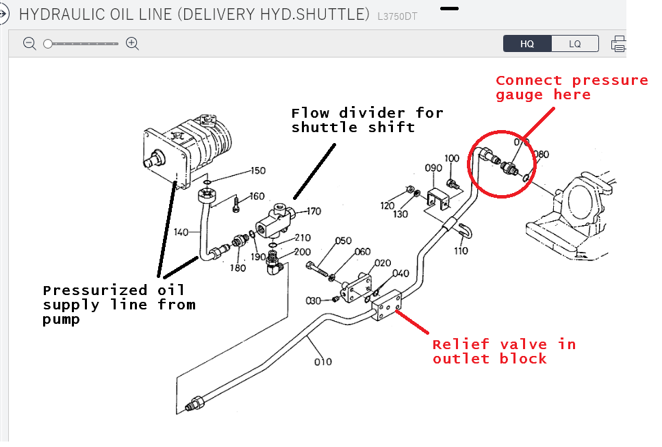

I prefer to do some diagnostics before launching into any major disasembly.
You trouble shoot hydraulic circuits much like electrical circuits. First identify the wiring/plumbing and then start testing as you move along the circuit. You had poor function before you changed the filter and now you have none. That suggests a flow//supply problem at the pump. So the first thing I would do is check for output flow from the pump. You can do that quickly and easily at the point indicated in this parts diagram. Disconnect the pump supply line at fitting number 180 and slip a length of cheap clear vinyl tub over the end of the pipe. A small hose clamp is good insurance againd it blowing off and making an oily mess. Put the pther end of the tube in the hydraulic filler hole and secure it in the hole for the same reason. Now start the tractor and observe the flow coming from the pump. If you have a good solid flow we move on to a pressure test. If poor flow we start working on the suction side of the pump. This should be easy and fast to nail down.

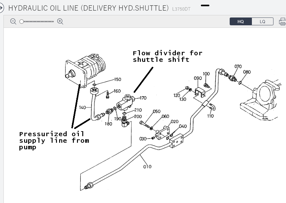

Oh the joys of the English language. I try to make a point of avoiding ambiquous references but I don't always succeed.
Its the oil line coming from the pump that supplies pressurized oil to the tractor as shown/described in the accompanying parts diagram and identified wiith reference number 180.

Probably not at that point. We need to know where the main pressure relief is and test immediately down stream of it. We went down this rabbit hole in a previous thread - I will have to go back and see where that was finally located.

OK - had to go refresh my memeory. On the L4150 the releif is in the hydraulic outlet. I would doble check that before proceeding - there should be a hex head plug on teh front back side of the block.
If so it looks it like the easiest place to pressure test is at the end of the 3pt supply line.

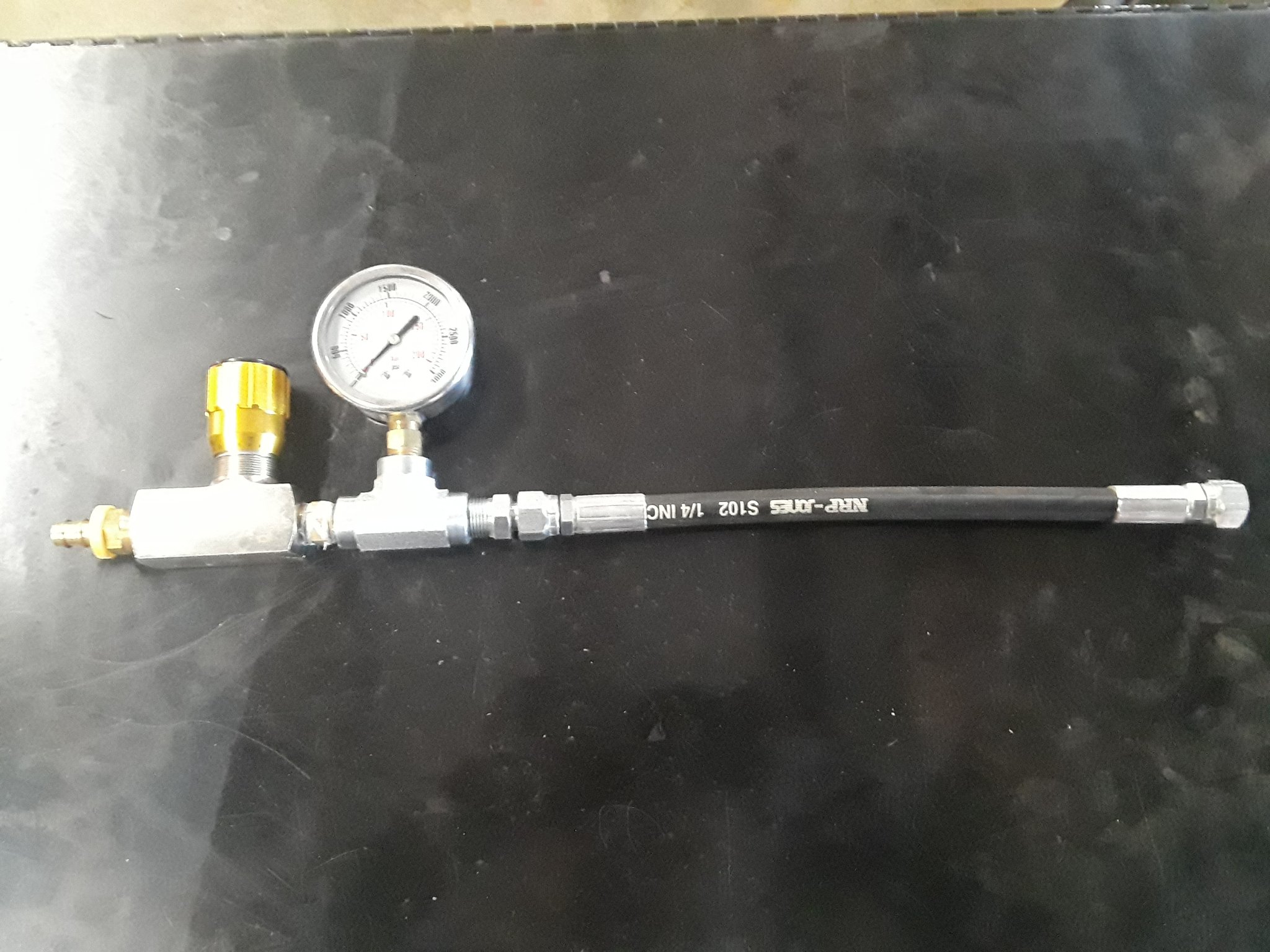

My crystal ball is far from infallible but its telling me that your pressure test is most likely going to indicate low oil pressure. So then the question becomes why and what component is causing it.
At that point you will need to start working back towards the pump and pressure testing on the pump side of the outllt block will require a more sophisticated apparatus. You might want to keep that in mind when purchasing a gauge and fittings. Since you will be testing on the pump side of the outlet block there is no pressure releif in the system and you will need a setup to allow you to control pressure so you don't deadhead the pump. The setup shown below is a little flow control valve and gauge manifolded together with a tee and makes a simple and inexpensive test rig.
To conduct a test:
  1. Hook the hose end to the pump side of the hydraulic circuit and run a piece of (clear??) low pressure tubing from the barb back to the sump filler.
  2. Fully open the flow control valve and start the tractor. DO NOT EVER FULLY CLOSE THE VALVE WITH THE TRACTOR ENGINE RUNNING
  3. Now gradually start to close the flow control valve and watch pressure build.
You should get to full operating oil pressure (~2000 PSI) with the valve partially open. If you can't either the pump is bad or something between the test point and the pump is bleeding off pressure. Move the test point closer to the pump and try again. If you get all the way back to the pump and still no pressure the pump is bad,

Thank you so much for all the great help and time and hopefully a thread that others will find in the future. Will build out this test rig and will follow up in several days with the results.
9,370
4,899
You are more than welcome. I did not invent that procedure. You will find that same test setup and procedure in the Kubota work shop manuals.
