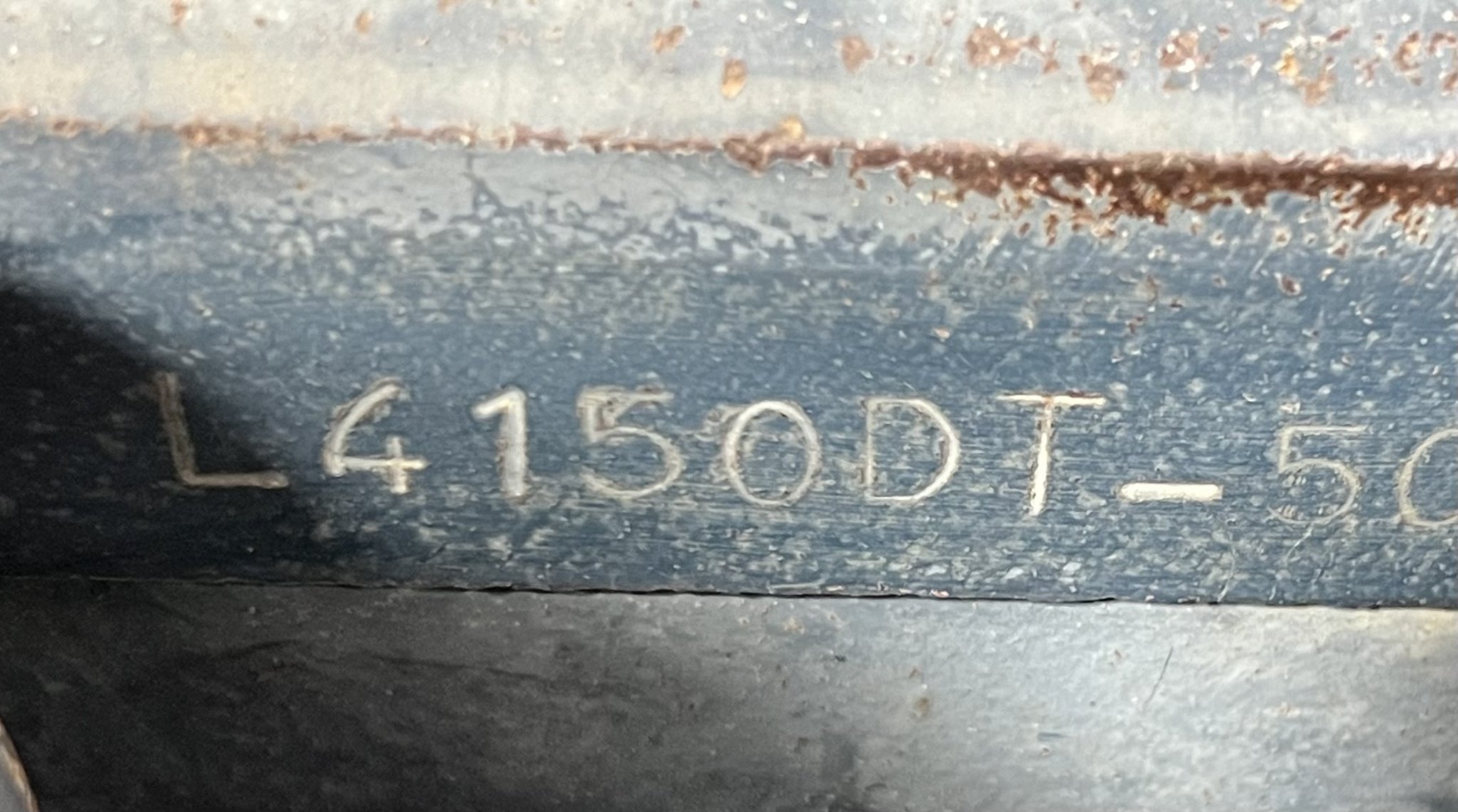

On mine it is part of the serial #. Have you checked that? Or will the dealer look up your serial # and tell you what it is?
