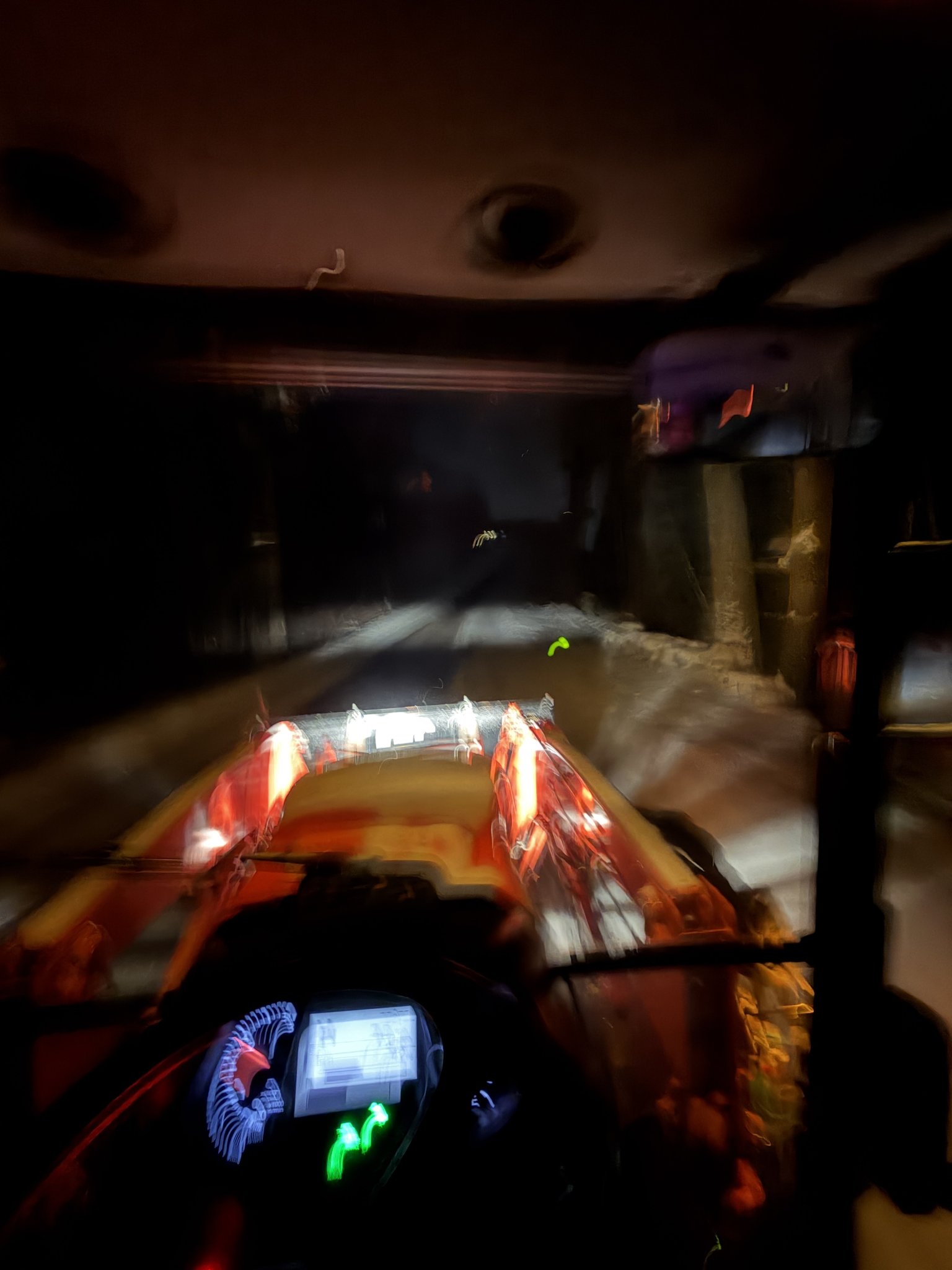

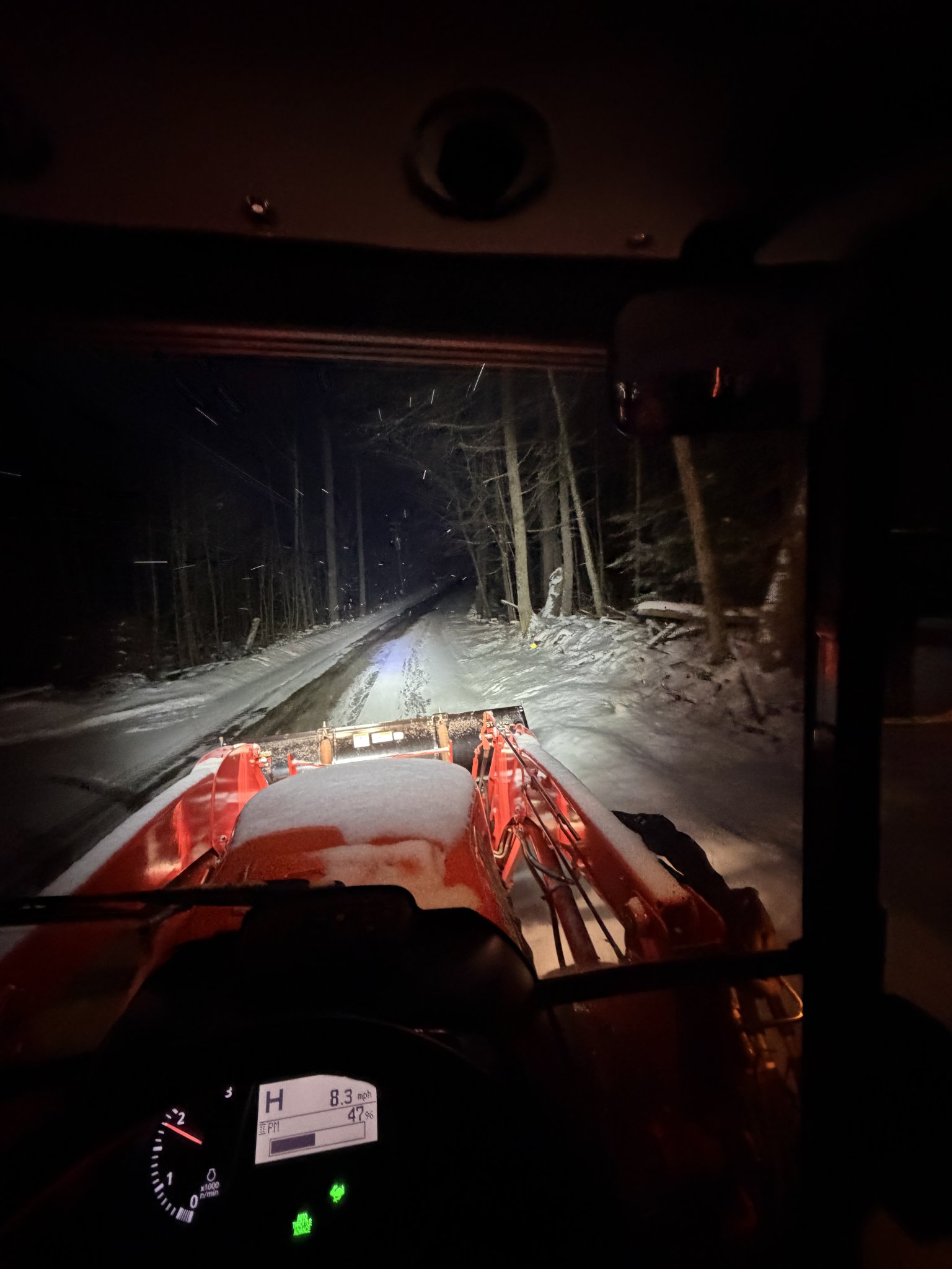

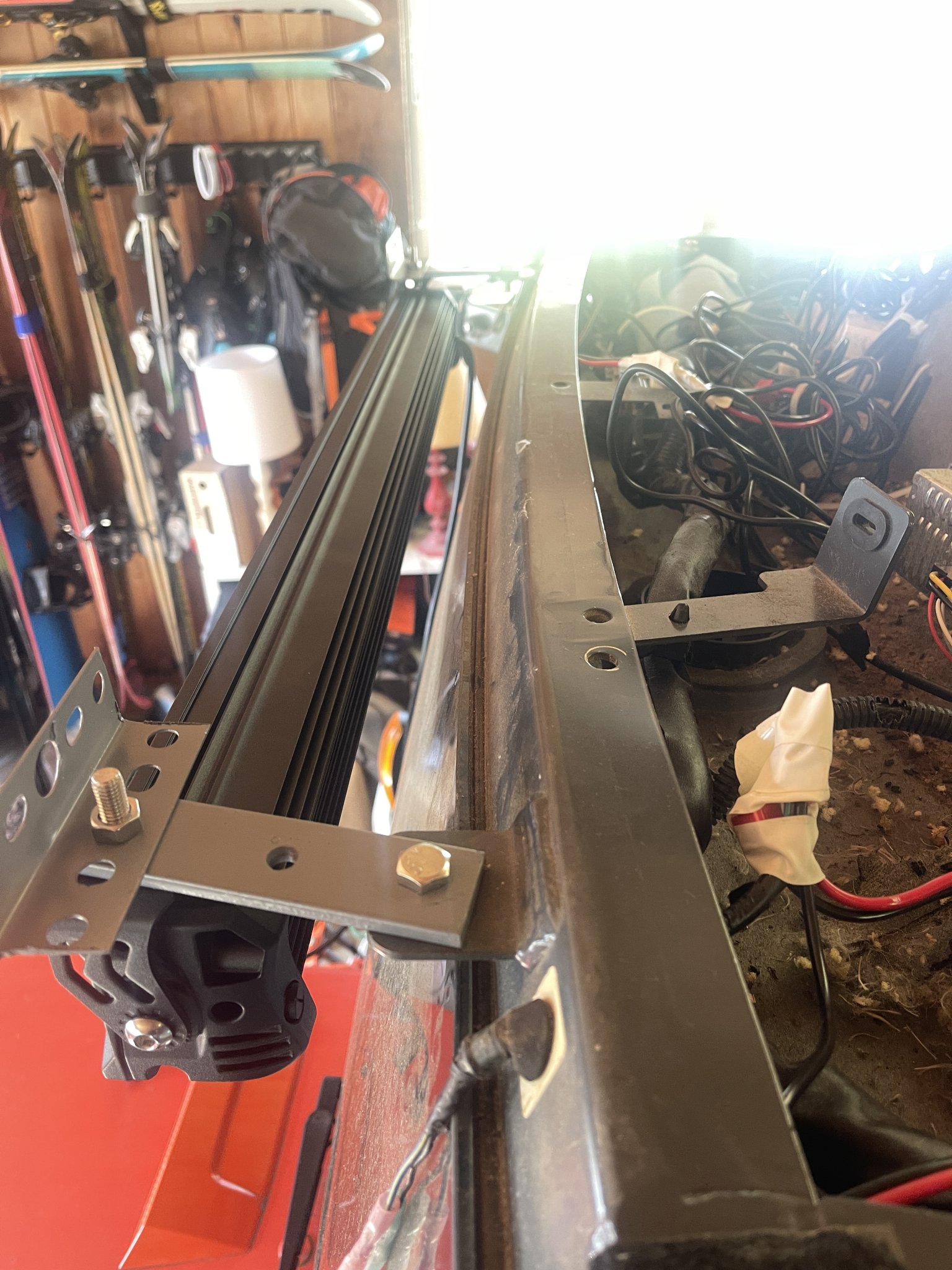

I picked up a 32” light bar from Harbor Freight and mounted it using the factory tractor mounting brackets. From there, I added an extension bar and a piece of angle iron to mount my strobe lights as well.
The light bar is wired into the factory front light switch inside the cab, so it turns on just like the stock lights.
I’ve seen a lot of threads asking how to add a light bar without overcomplicating things, so hopefully this helps someone looking for a simple, budget-friendly solution.

Nice installation.
I wonder if, at night, it doesn’t give you a lot of “back-glare” from the hood…?
Did you place it on its own fuse and/or relay?
