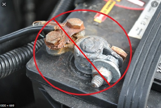

How about some photos of the top of your battery.
Because you say you cannot jump start the machine, assuming you did the jump correctly, it really narrows down the problems to cables and their connections to the tractor frame, starter and battery.

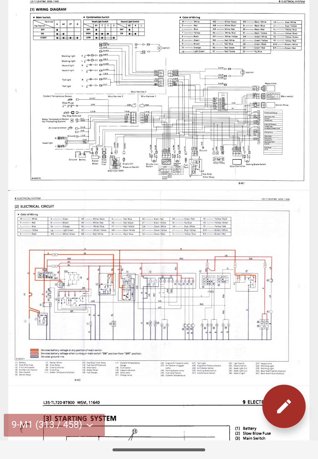

Honestly ,you NEED a good,accurate wiring diagram to even try to troubleshoot.

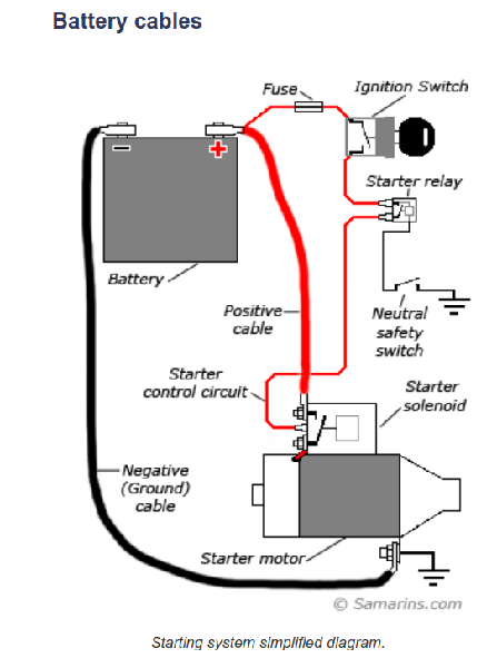

Your symptoms are classic bad connection. Might be something else, too, but cables and connections are the place to start.
Start with the battery cables. Both cables (positive and negative), both ends. And "check" doesn't mean look at them. Disconnect them, clean the terminals. Flex the cable. Sometimes corrosion can wick up into a cable and hide there. If it's there, the cable will be stiff. Flexing it will break up the corrosion. Listen and feel for that. Crunchiness = corrosion. You might break the cable completely. That's good. If it's borderline, you want to break it so you know where the problem is. Get rough with them!

I have downloaded everything I can find. This is a 1994 L35 TLB Ser # 70760. I replaced the alternator, start key switch assembly and we installed a JD starter relay to protect the voltage drop. I worked on sewage lift station control panels and have several Fluke meters. I have been research relay diagnostic information for the various relays. In our field when we get these weird electrical issues in the panels, we call it MES...Mysterious electrical shit. I know it's got to be some simple stupid issue. I just don't understand why I get dash lights sometimes and when I do and try to start, I hear one click and then nothing. I did some feedback about the fuel shut off switch and will try to find a test procedure on it as well.

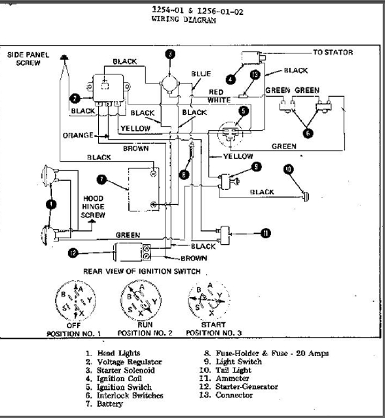

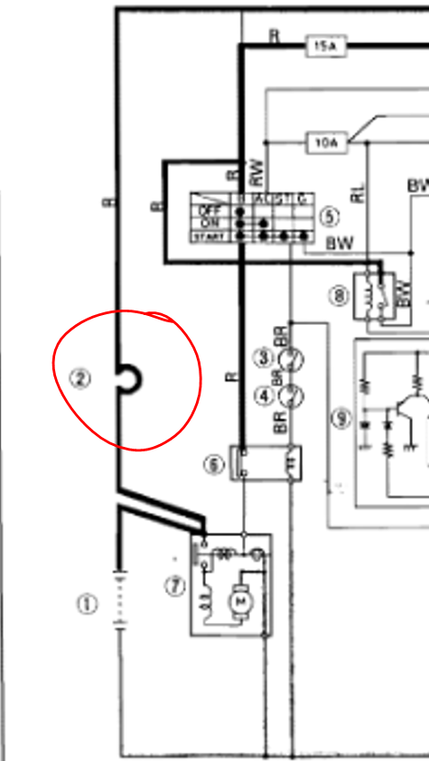

I don't know if this diagram will be legible. You're making this too complicated. The glow plug timer, key stop timer, none of this prevents it from turning over. You say you replaced the cable ends, not the whole cable, so like others have said, I'd say you have a bad connection.
