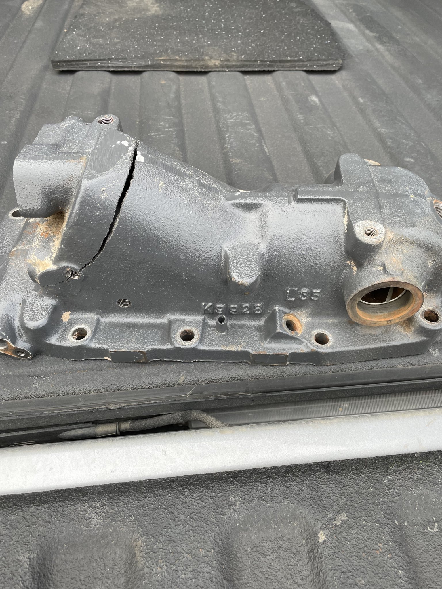

I have a cracked hydraulic cylinder case part #32751-34114 which cannot be repaired and I can't find a new or used one. Does anyone know of a workaround where I could use a case from another Kubota tractor that might work. OR ANY OTHER IDEA TO GET ME RUNNING AGAIN. THANKS

@bigtrough Could you send a couple pics of the area that's cracked? Maybe someone here could suggest something.
I don't know if that particular part from the L35 is used on other Kubota models, but you might check other L-series as a start - maybe you've done that already.

I gotta ask, how did it break?
not sure how it broke just started shooting fluid out.....could have hit a stump when shredding and jarred it or could just be a weak cylinder. I will post photos if I can figure out how to do it. Thanks to all who have suggested places to call for new or salvaged parts. I've called them all. What I need is a Kubota guru who can tell me what hydraulic cylinder case from another tractor will work and what modifications will be needed.

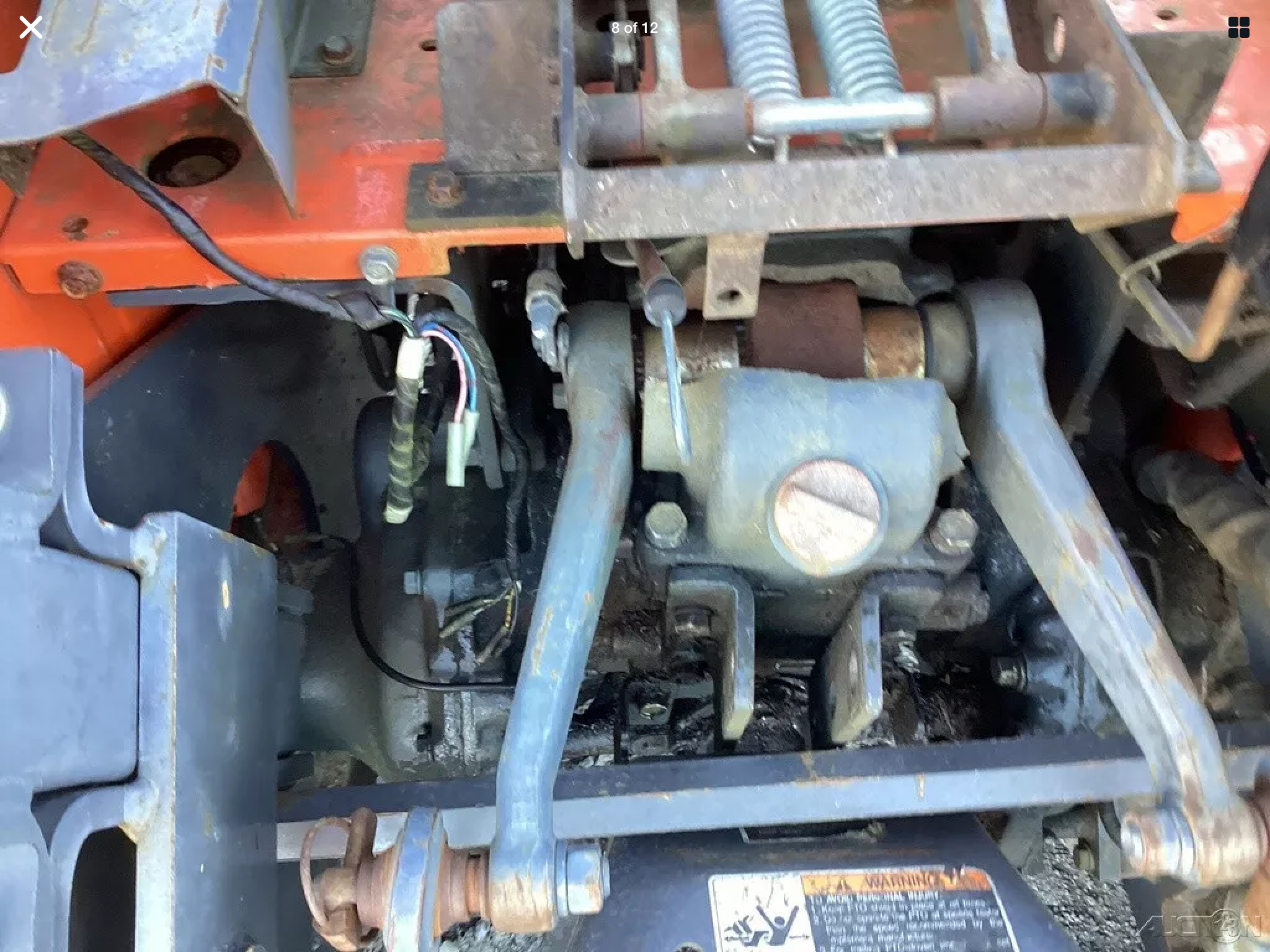

Man that scares the heck out of me I’ve seen more than a few busted. So you were brush hogging?

This guy went all in

And another one

I'm wondering if a poorly adjusted/missing feedback rod could cause this?
Had a friend with an old JD2010. He said his 3PH once raised more than usual, and popped the case when it hit top. His damage wasn't as severe.

I think it has more to do with the way the hydraulics are pressure relieved. The TLB has an added check ball/valve on the head line connections. I have found comparable housings, they are very similar to the vintage L. A custom hard line setup/housing face machining will be required. Its totally doable, I dont have the rig myself, but I would fix if i had that issue. Might even change up the hydraulcs a bit if I needed to provide the appropriate protections.

I had to look up the feedback rod function. This seemed like a simple explanation in case anyone else is in the same boat:
