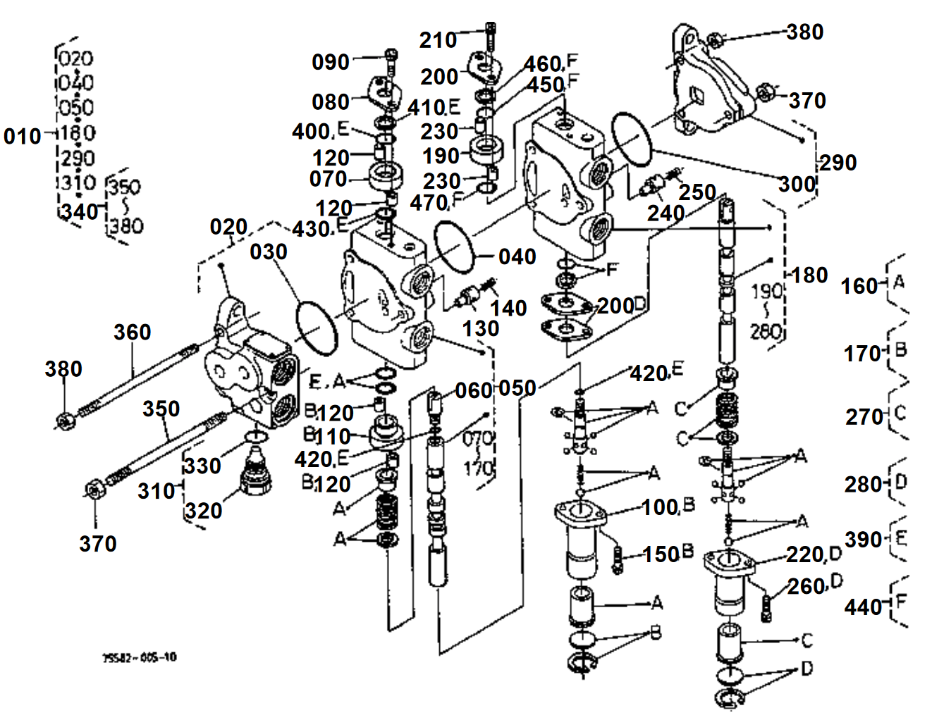

The valve is self contained. If you have flow into the valve it should have the same flow coming out.
You have one in and two outs.
One out is power beyond and it should have the same flow as inlet.
The other out is tank and there should be no flow on it.

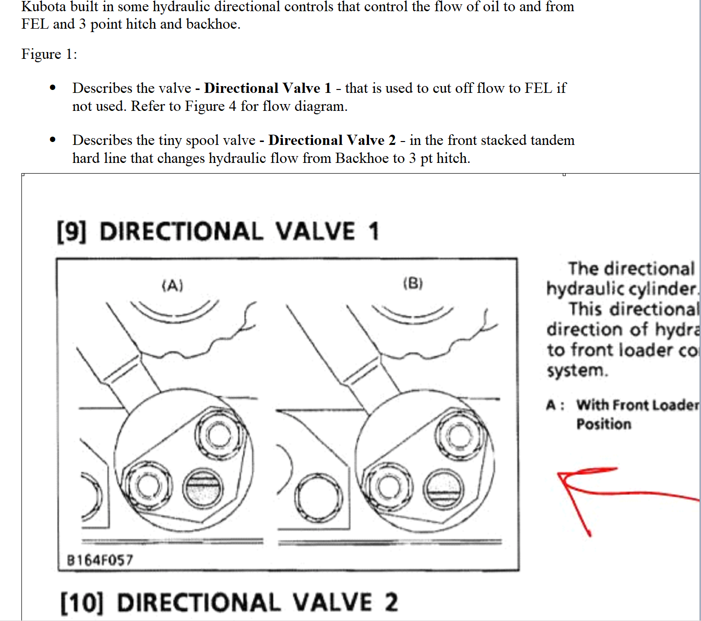

This is a long shot, but is it possible that Directional Valve 1 (4) in the diagram got switched? This is not the same as (7), the one you switch when you remove the backhoe to use the 3ph.

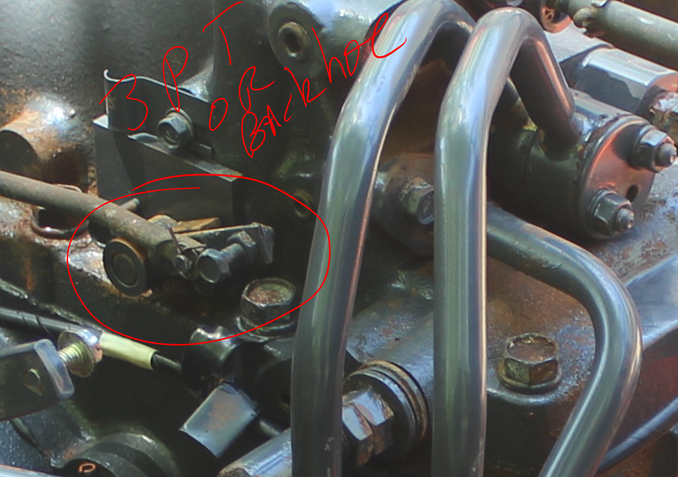

As @PoTreeBoy says, there is a valve that splits the hydro between backhoe and 3PT (the lever is behind the seat and connects to the valve which is under the seat) that does the splitting. For 3PT, the lever should be pushed toward the front of the tractor. (In this pic, it is pulled to the back for my backhoe)
There is also a valve built into the hard lines (under the seat) that controls pressure to the FEL

He says he has flow in at the loader valve but no/diminished flow out.
How does that happen?
I have no familiarity with the plumbing on this machine so help me out here. I assume that when DV1 is in the loader position and DV2 is in the 3pt position the flow is into loader and then out to 3pt. I also assume there is an additionsl tank return from the loader valve to tank.
I also assume that when DV2 is moved to the backhoe position the flow going into the 3pt valve is diverted straight to tank disabling the 3pt.
Is that correct?

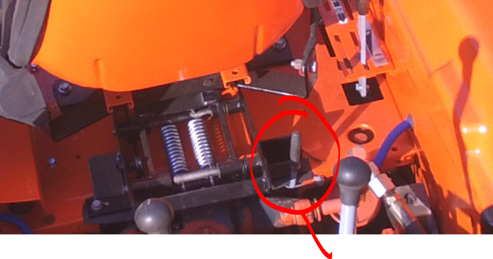

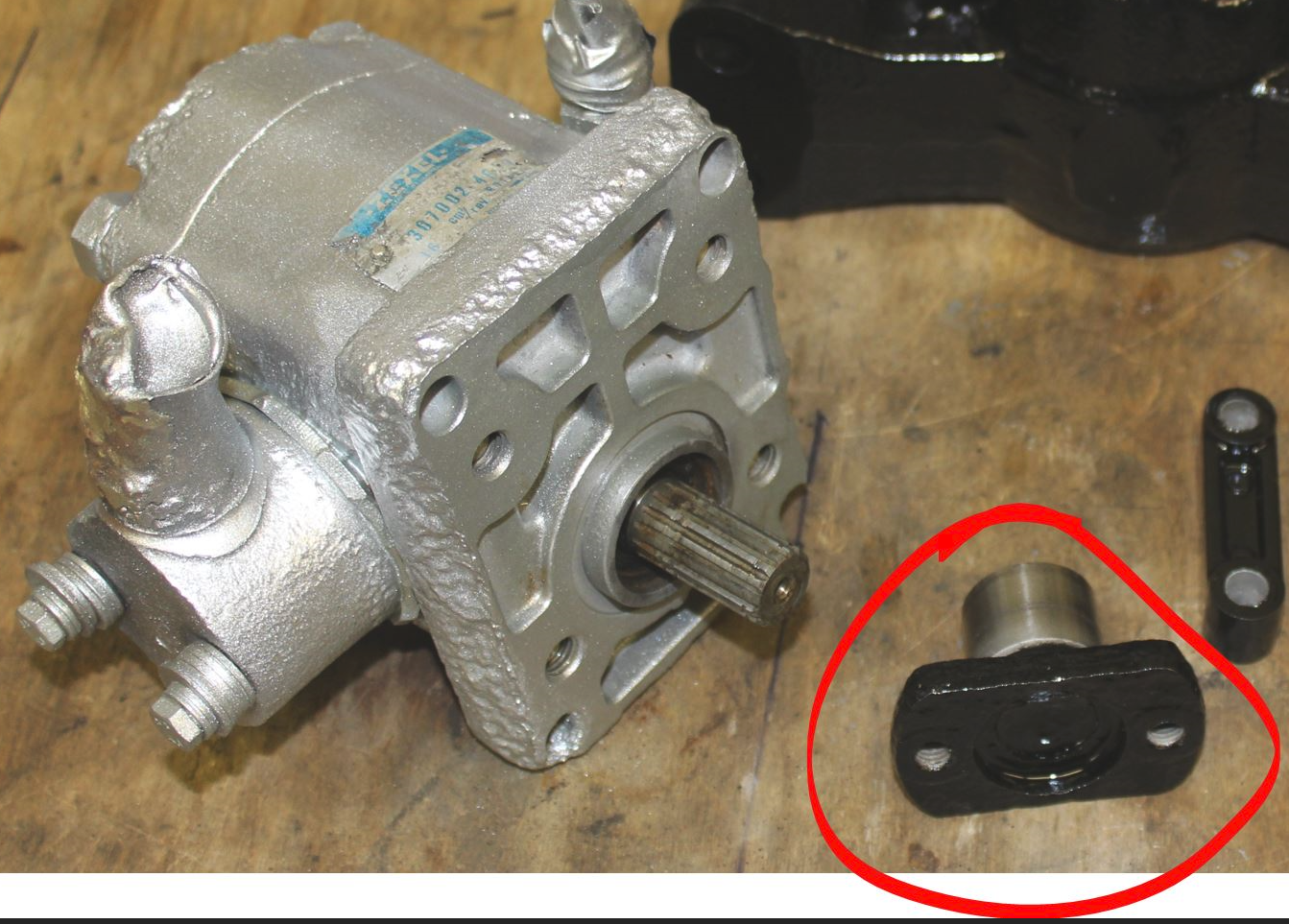

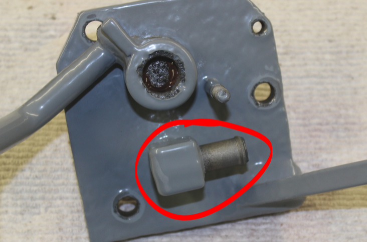

Yes to your assumption on the Flows. The L35 has the hard line blocked if there's no loader on the machine and there is a relief valve - See pics below.

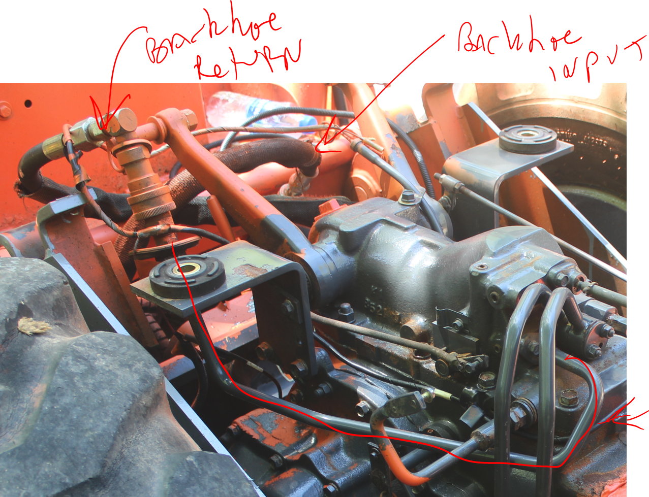

LOADER SPOOLS

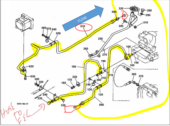

Power to the Backhoe comes from the hose you look at straight on in the photo

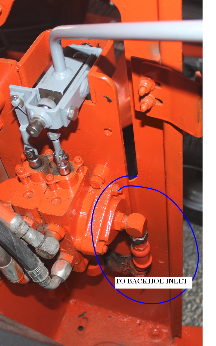

I am a slow learner - lets take this one step at a time, Here is your picture of the loader valve showing the outlet section. Is that hose you circled the power beyond supply hose for the backhoe valve?

Correct. It's just a long rubber hose to the back of the machine along the bottom of the frame
11,116
6,184
OK so there there should be two other hoses on the inlet section of that valve. One is pressure in from the pump (controlled by DV1) and the other is a tank return straight into the transmission. Is that correct?

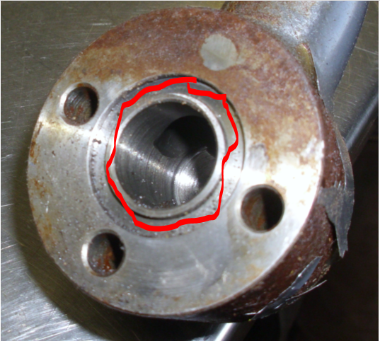

Oops, I've just realized one of my pics is incorrect.
Let me correct and add some info and this will be cleared up:
FIRSTLY - The hose that attaches to the PTO unit is from the SIDE PUMP (power steering and clutch control) - nothing to do with the FEL and front pump.

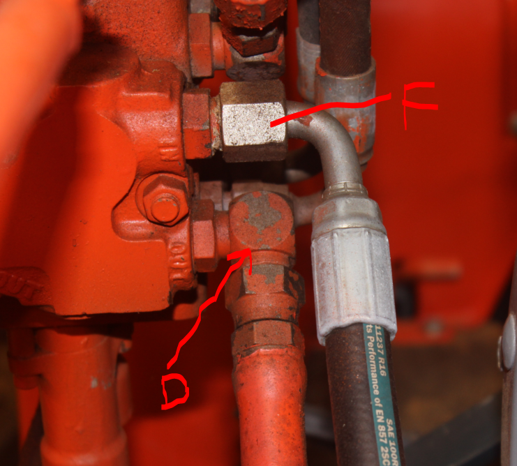

SECONDLY - This will help with your question I think:
THis is the view of the FEL control from the front.
"F" is from the Front pump via the hard lines under the seat. The front pump discharges to the rear of the tractor via a hard line. The flow goes thru DV1.
"D" is the return to the transmission (via hose and JIC fitting)
Sorry for the confusion

Back to what I said initially.
If you have good flow in on P then you must have the same flow out on PB and there should be no flow out on T.

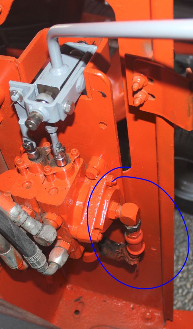

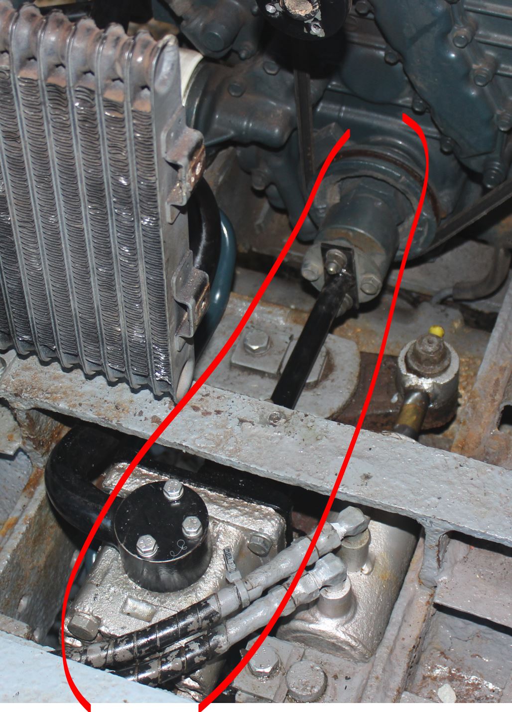

Hi @jt2hunt
Are you saying the coupling (Circled in the picture) is the one with stripped splines?
So you think the pump stopped pumping because it wasn't being turned - correct?
That would certainly make sense. Did you take the pump apart?
When I rebuilt mine, the 2 front bearings were complete junk - I wonder if those bearings are ok in yours?
I doubt overfilling would hurt anything - the transmission does have a vent hose on top left side which I suspect would overflow if it were necessary.
Do you think the "pop" sound was from the failed coupler?
If you have a leak in the suction line (Large one on the front pump). That line from the sump, feeds both the front and side pumps.
If there's a leak anywhere in the system, the FEL won't work well or at all.
A leak could be the pipe itself, the rubber suction lines at the filter or even the suction line for the side pump (power steering).
If the steering is working correctly, then the side pump is working and likely no suction leaks.
FYI, for those concerned - this is the L35 Front pump arrangement

Hi @jt2hunt
Thanks - I had no idea that pump was mounted like that.

Hi @jt2hunt
Yes the coupling pictured in the circle. I replaced the coupling, two bearings, and the cap. No leaks because the transmission and steering are working. I suppose it could be something inside the pump itself. Once I get pressure gauge then I can test in certain areas and see if we build pressure. I am not versed in hydraulic systems so I am learning as I go. No i did not take the pump apart but wishing I would have. How would I know if it is the pump not working properly?
Nicksacco
Kubota L35 TLB, 2014 RTV-1140CPX
Sep 15, 2021
758
496
Bahama, NC

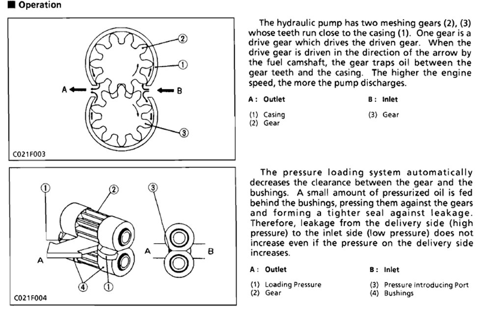

Yes, would've been good if you'd taken it apart.
It's just a gear pump nothing fancy inside.
But something went haywire - just don't know. But does seem to point to the front pump.
Could've been something that broke a tooth or something in the pump - but somehow that just doesn't seem likely to me.
When you reinstalled the suction pipe (top pipe) and the delivery pipe (smaller one) did you ensure that the rubber Oring was situated in the recess?
You could disconnect the delivery hose to the FEL and put in thru a hole in a 5 gal bucket lid (see above posts for location) and see if the pump pumps fluid into a bucket when started briefly.
That might be a lot of trouble since you have to disconnect a swivel fitting and not sure where that is on your tractor. This is of course in-lieu of a gauge. At least you'd know if the pump was drawing fluid.
Maybe someone else has a better idea.

I dont think taking the gear pump apart is a productive use of your time. You can learn all you need to know with external testing. Do you know how to test pressure with your new gauge?
