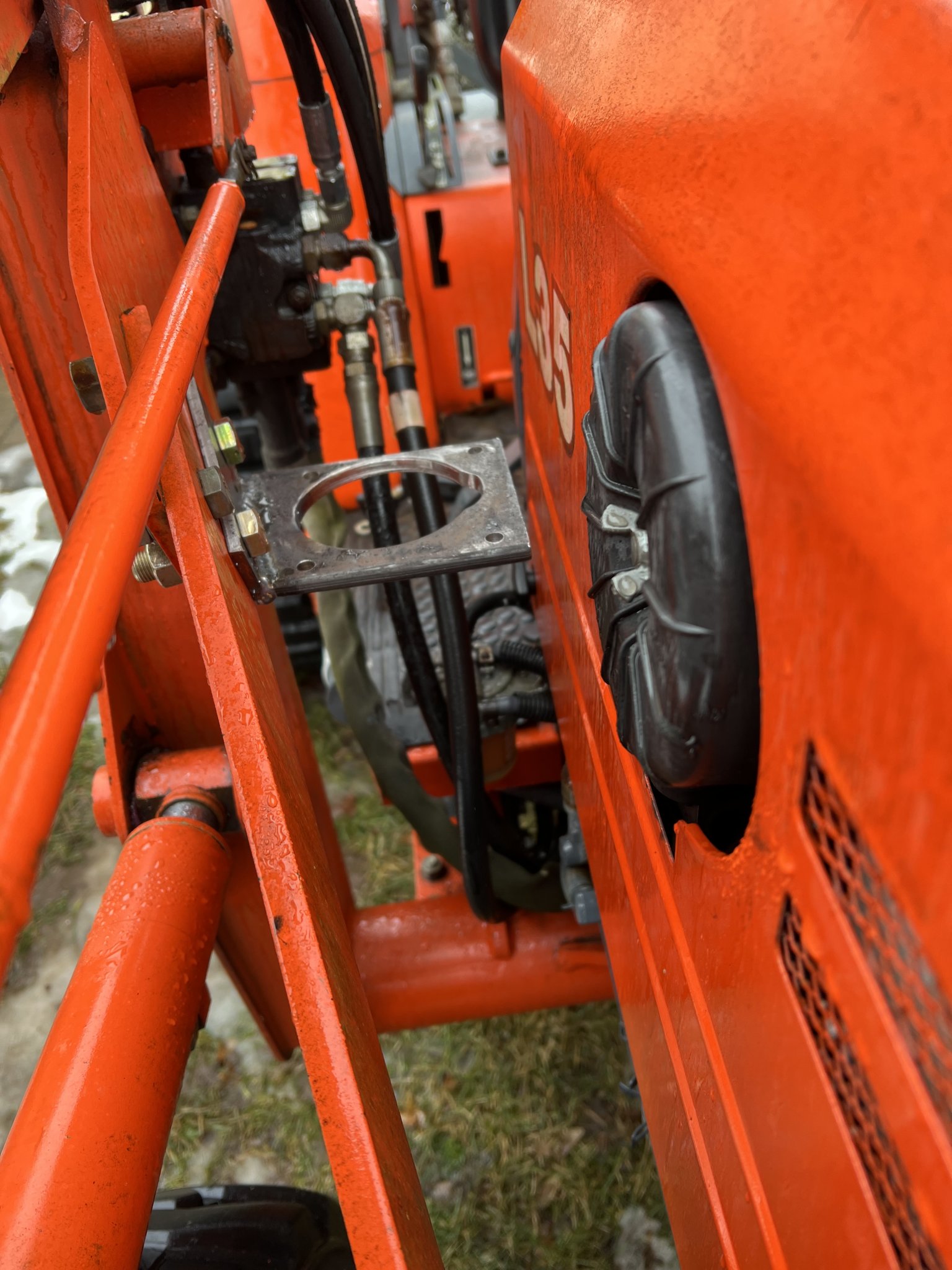

i had some steel plate and made a bracket to bolt onto the loader support. The hole was made by a 3 1/2” holesaw and slightly opened up with a carbide bit to allow clearance for the fittings underneath. I purchased 2 longer 9/16” bults to mount the plate to the loader support.

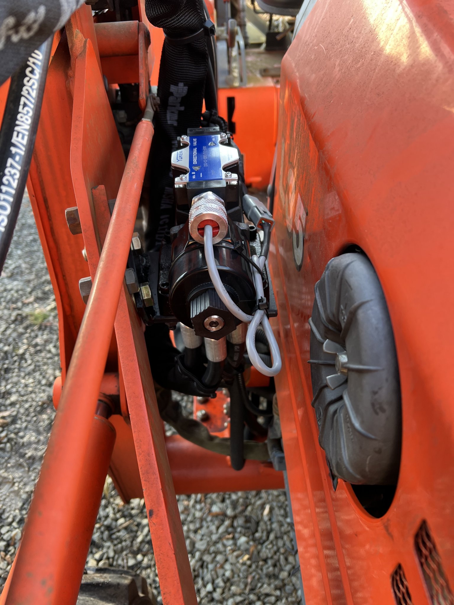

i then installed the joystick handle and routed the cable down to the valve location with several zip ties and allowed plenty of extra wire for movement. The handle requires 12v power. I routed the wire over to the fuse panel where i used the LH Work light circuit with 10amp fuse. I had abandoned this circuit earlier. I installed 4 new led lights on the ROPS and i used the RH work light circuit to power them. The ground for the handle was heat shrink ring terminaled and bolted next to the factory ground by the fuses.

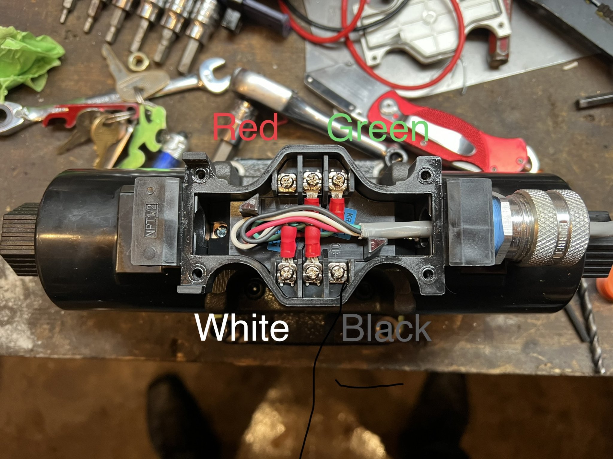

The yuken valve has a conduit box for connection unlike the Din connectors of many valves. I simply cut the Din connectors off and wired accordingly:
Valve a: (green +) (black -)
Valve b: (red +) (white -)
Always double check your wiring on your particular harness. The junction box has a 1/2” npt thread. The Hubbell adapter was sourced from Grainger. It accommodates a .19-.25 diameter wire. Inside the junction box i removed the common jumper tab that ties both a b coils together for ground. Seeing as the handle had its own 2 grounds i though it best to leave it as such.
I verified the valve function was working via red lights on the valve.

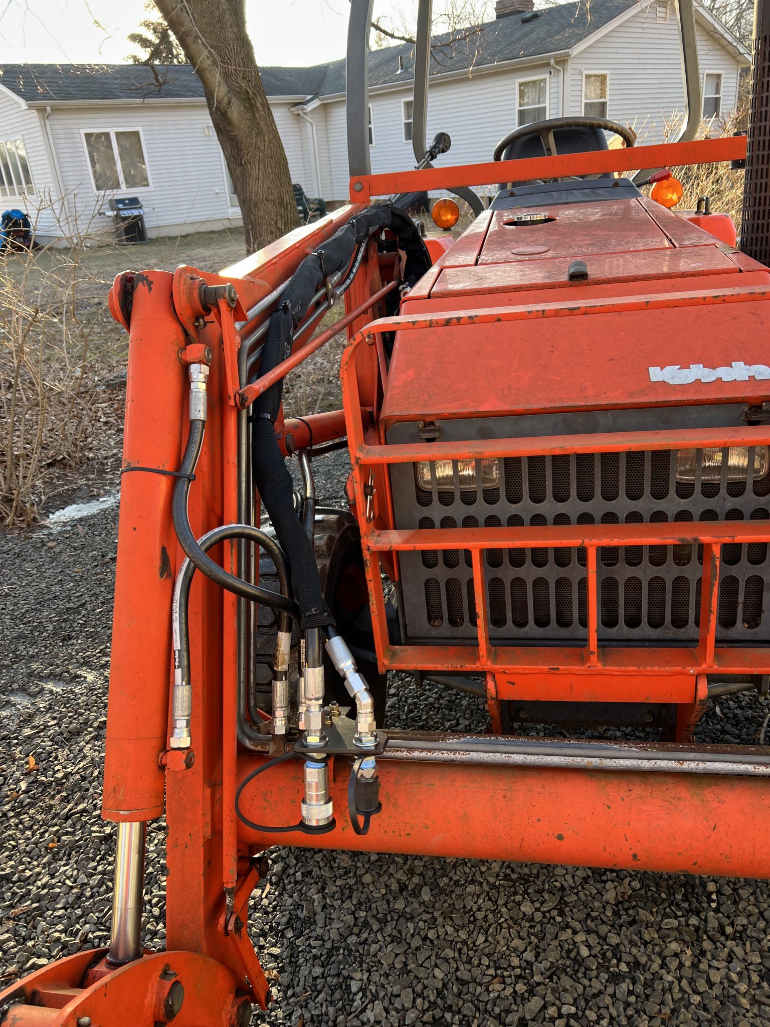

Went to parker hose this morning and got the hoses made. The guy wasnt too thrilled about trying to do steel so i settled on 1/2” hose in protective sheathing. I will make a bracket for the quick connects and get everything buttoned up this weekend. Might have to get 2 new hoses for the 4in1 bucket made but we shall see.

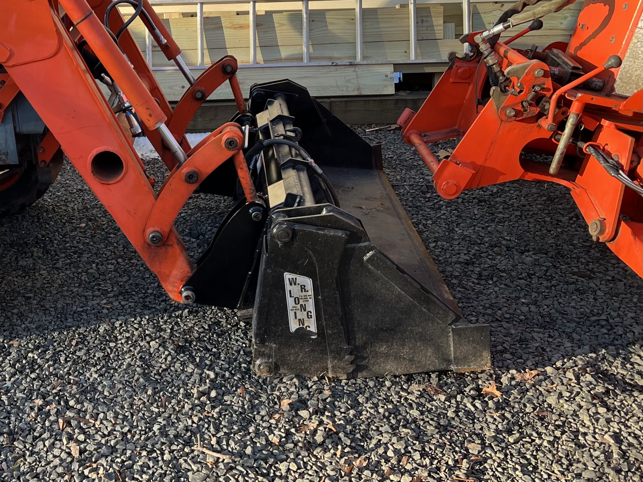

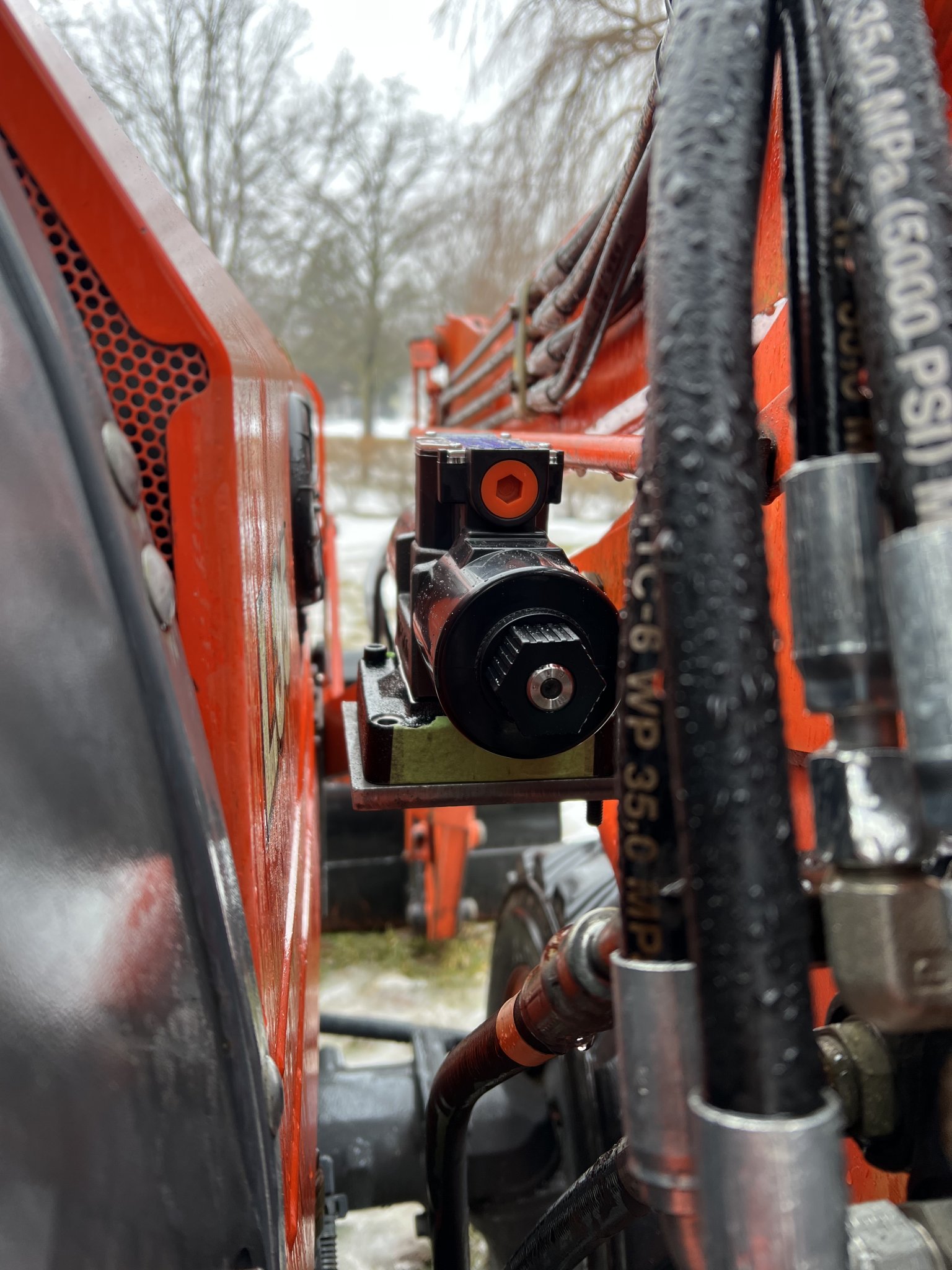

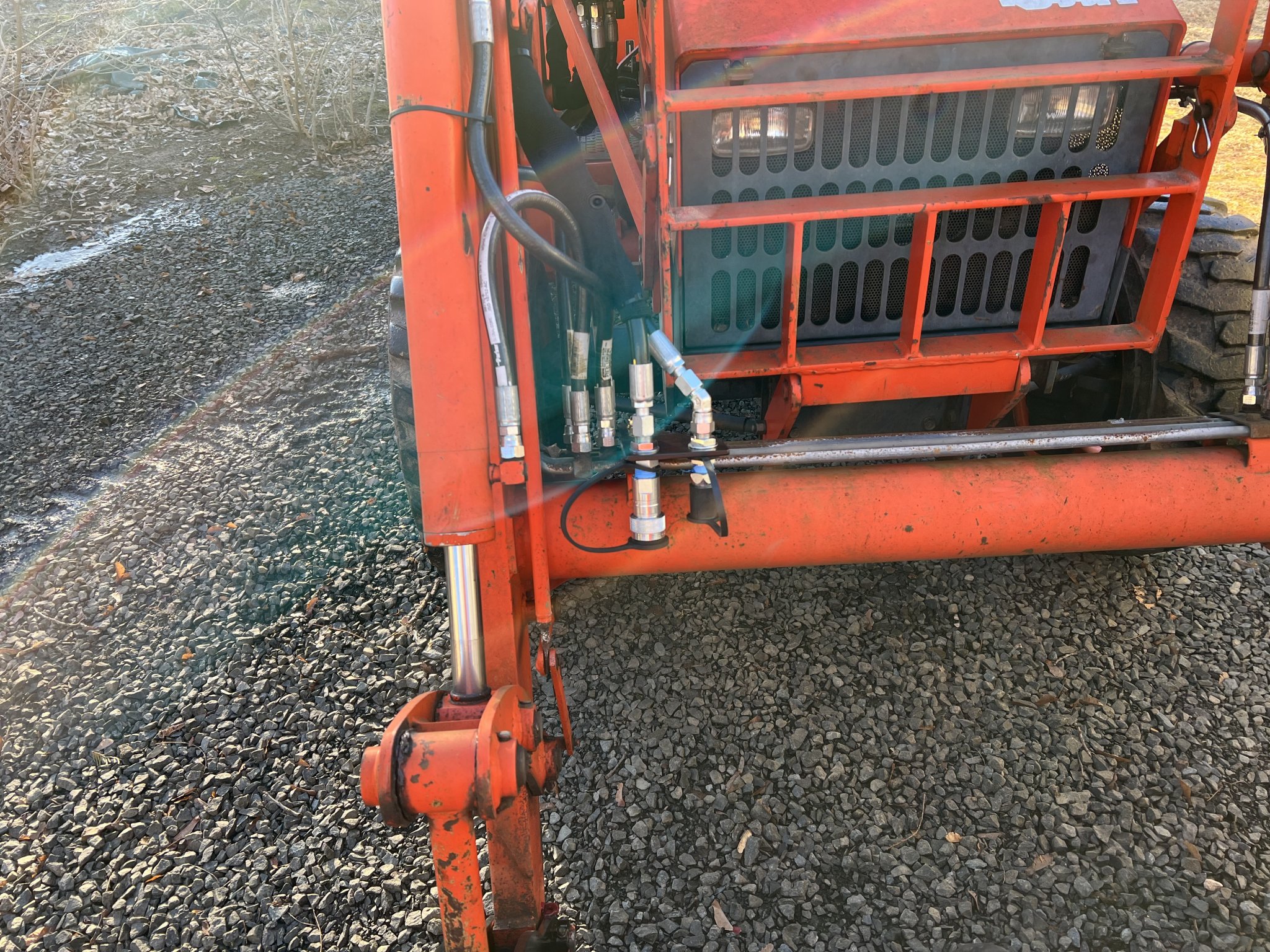

Got the valve on and mounted, hoses routed, and plate/bucket on.
hoses went on flawless. The short 32” hose that goes from loader valve to 3rd function fits great. The 2 hoses that run from 3rd function to front are 7’ 10”. Just long enough to make it nicely.
The front plate where the quick connects are is made is 1/4 plate steel. Holes are 3/4” for the bulkhead connectors. I chose the pioneer style for cost. Bucket will rarely be removed so the dripless style i did not need.
i need to get 2 new hoses made from bucket to connectors. I will get them tomorrow.
the ATI SSQA went on flawless. Perfect in every way. I am impressed, and that is not easy to do.
the long bucket will need to be modified with a back stop and add some 3/8 chain hooks and d-ring.
overall im happy and cant wait to use it.

Make it a reality. After 14 years of ownership, i did. Im not getting any younger and might as well have the machine to the work.
i got 2 new 41” hoses made for the bucket to quick couplers. Everything works perfect.
i need to re adjust the loader feedback bar. Seems a little too curled when i raise empty. Do not want mud and rocks all over the hood if im not paying attention lol
