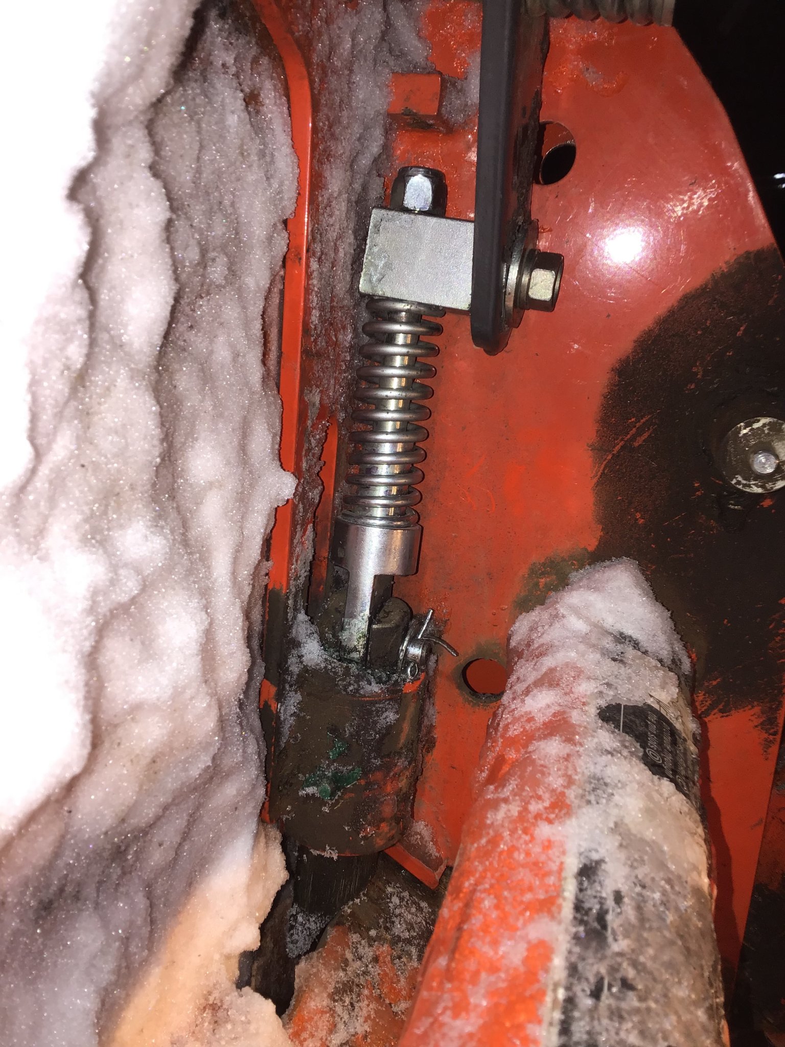

There was a development since posting my original message. I backed the nut(s) off on either side just about as far as I could without losing the threads and managed to seat the pins down further into their respective holes (see: attached). I think I was tightening the nuts because I thought it best to compress the spring but, rather, I needed to extend that bolt inside the spring as far as I could. All that to say the pins are now seated a bit better.

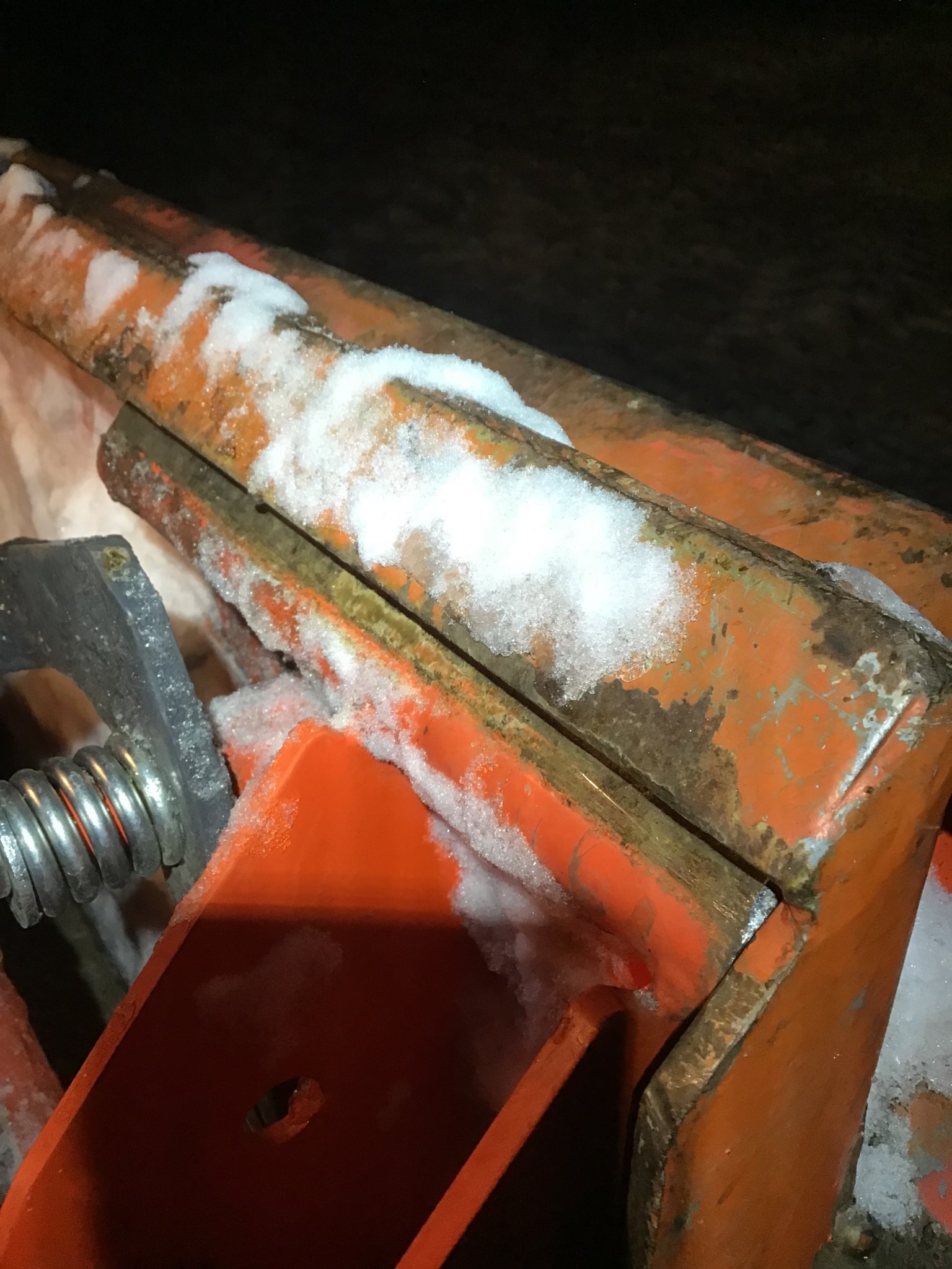

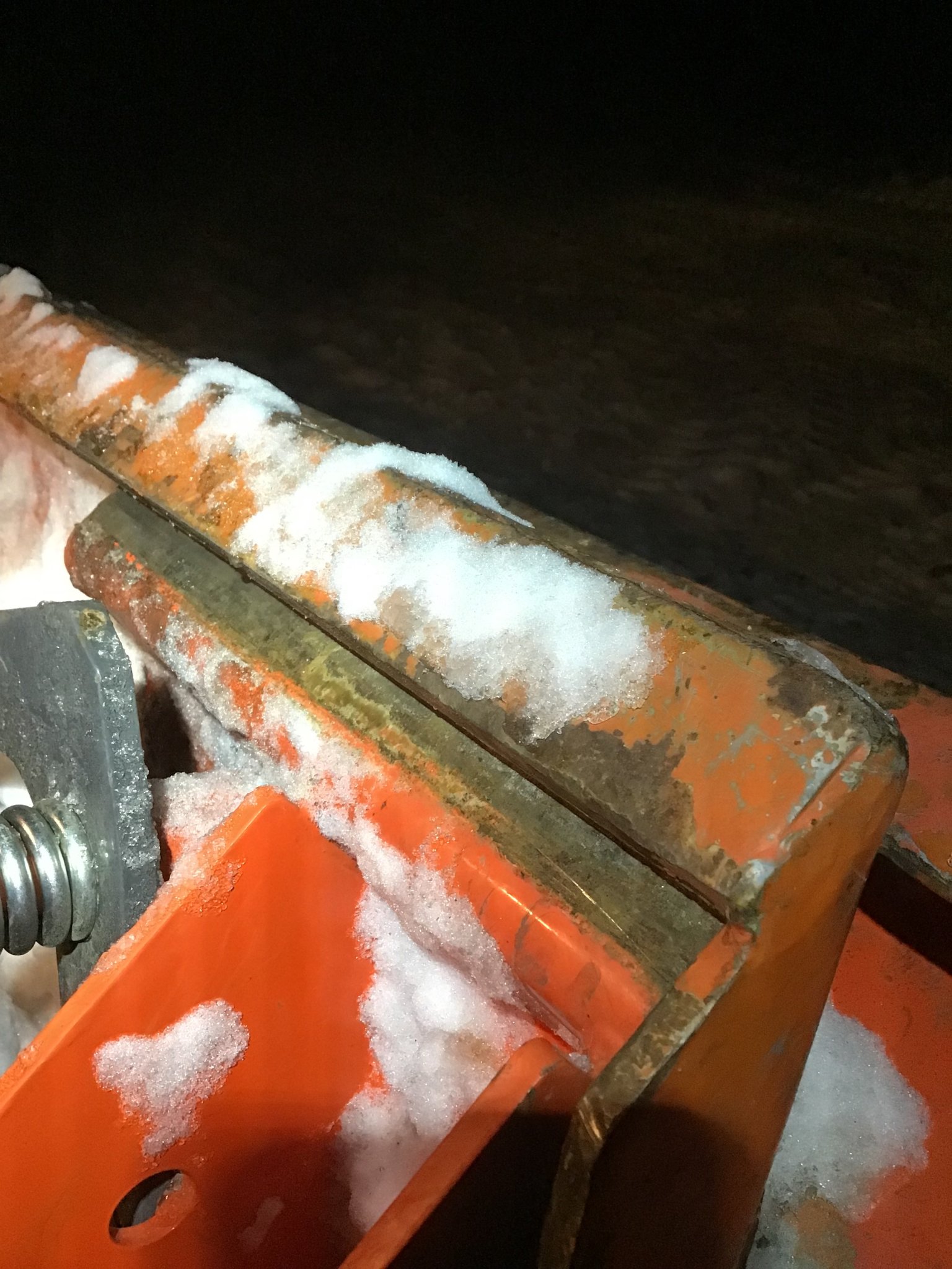

That being said, I'm still experiencing a bit of "slop" between the QA plate on my bucket and the SSQA on my tractor's loader. I can't tell if this is something that's been going on unnoticed all along or if it's related to the issue I was experiencing originally. I attached 2 photos that hopefully illustrate the amount of play I'm experiencing when applying downward pressure on my loader. More or less it seems like the loader is overpowering the springs on those pins, allowing the bucket to ride up the SSQA on my tractor.
Any thoughts? Do those springs ever wear out? I pulled my pins apart and didn't find any abnormally worn holes for what that's worth. Is some movement between my bucket and tractor's SSQA plate to be expected? Sorta seems like it shouldn't be.

I would say your SSQA plate is bent and not letting your pins to seat properly.

I don't have my tractor near me, but from memory, your "pin engagement" looks to be just about what mine is.
From the pics above, your engagement seems to be even a little deeper than I remember mine being.
I specifically do remember looking at it once, and wondering if something was wrong.
It's either normal, or we both have the same problem.
