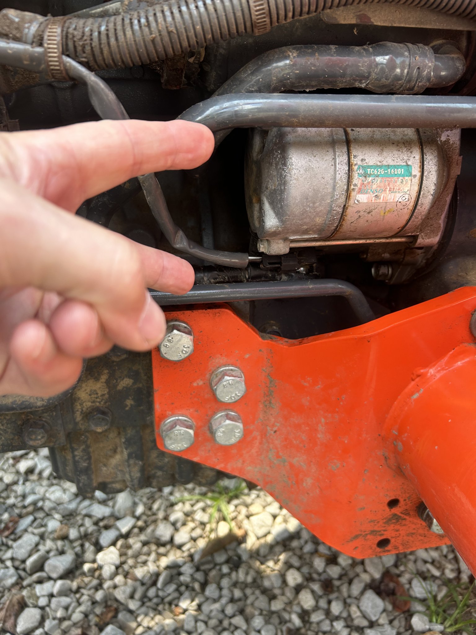

It’s a bear getting the starter off. I can work around the loader, but there is some kind of either coolant, hydraulic or electrical conduit plumbing running right across the side next to it, terminating in a large nut in front of the hydraulic dip stick. I don’t want to remove this without knowing what is in it (such as pressure). Does anyone know what this tubing is? The WSM is not clear on this.
Got a picture?

That metal line is hydraulic. Rubber is coolant. Starter should come out without removing that line. May have to get creative with extensions and wobbles to remove bolts.

Thanks, Moots. Might have to get an assist from someone with smaller hands.

I received my starter way early and was able to replace it today. Problem is resolved. Bench tested the old one and it is shot. Will do a post-mortem on it later today to see what might have failed.
Some observations:
This forum is excellent. I really appreciate all the advice.
As the starter and installation is expensive, time-consuming and frustrating (I lost about half my Christianity on this), much troubleshooting preceded the final fix.
Installing a new starter is made difficult by the hydraulic “plumbing” running alongside the location, as well as wires in flexible conduit, and the fact that you cannot see the bolt behind the starter.
Bolt holes are roughly at 5 and 11 o’clock. Bottom one uses a bolt going into a threaded hole; for the top one (which is out of sight), the engine block has a stud that goes through the upper hole of the starter yoke. Your ratchet extenders obviously can’t feel a thing, and likely your hands are too big to get back there, so it’s hit or miss, but so is getting the socket around d the nut to remove the old one.
Grease the stud with locktite; put some plumber’s putty in the socket to keep the nut from falling out while you defy the laws of probability and statistics to get the nut fastened back on. It’s just a matter of fishing around back there and cussing a little.
Voilà.
