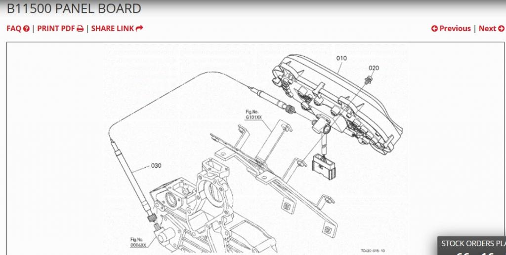

I have searched through the forums and Ive found lots of reports of tach problems, but not like this. Everyone else's seem to stop working, where mine is reading wrong, but only at times. Is this a gauge failure? A cable issue?
Thanks in advance for any light that can be shed on my issue.
