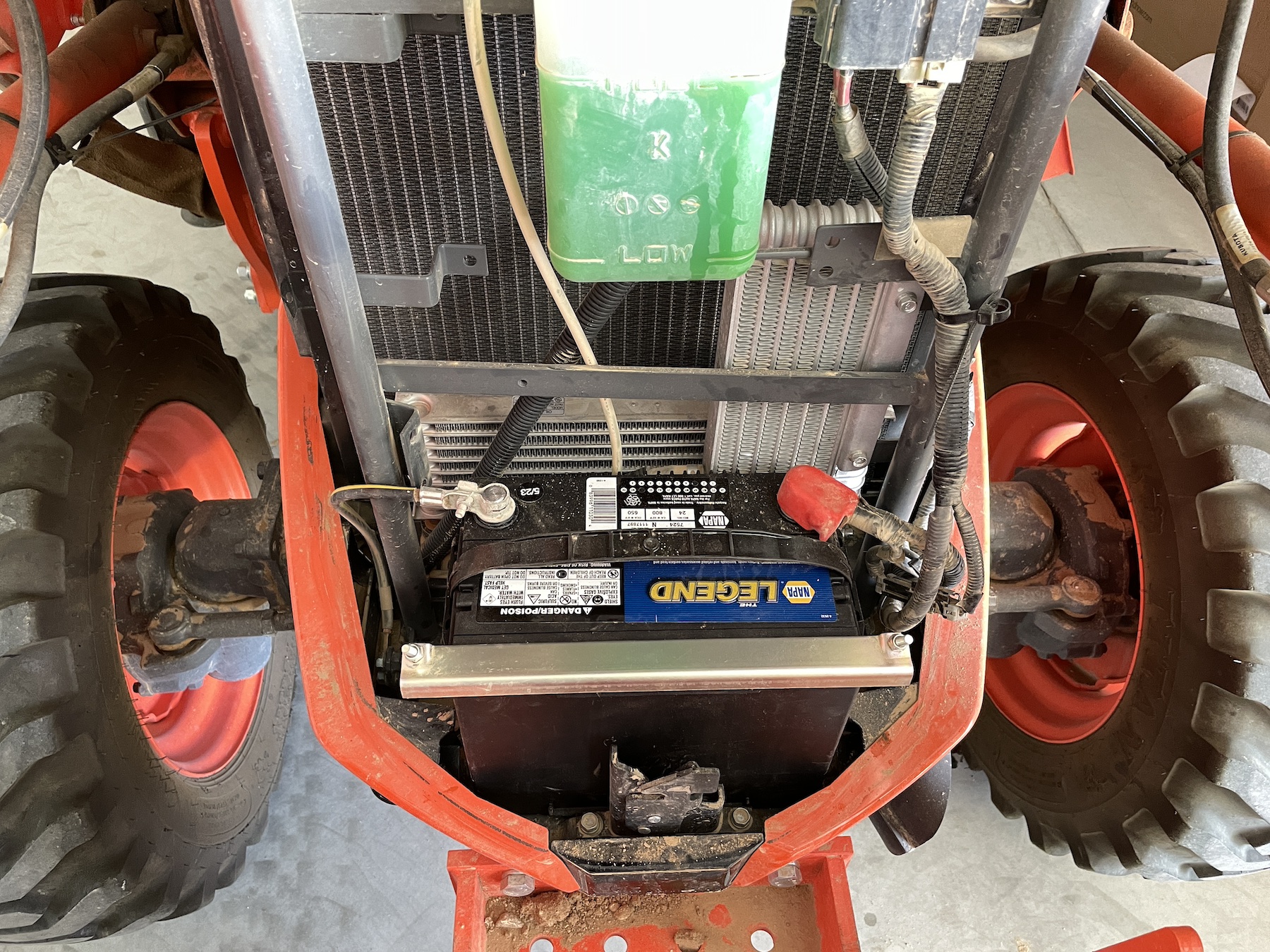

I did a quick Google Search, and this showed up about Group 30H dimensions:
Group 30H Battery Replacements
It depends on whether it is a thick plate deep cycle or thin plate stop/start battery or a dual purpose combination. The dimensions should be roughly 13.00 x 6.75 x 9.5 to 11.9 inches tall.
Opps I meant to respond to the op with the L2850, I edited the post and switched the name. I think the battery may end up too tall.

I definitely need to take some measurements, my L2850 is at my property so I’ll have to head out there and measure as soon as I get a chance. Can’t believe I didn’t think to measure when I went out to pull the battery. Actually I did think of it but didn’t have my tape measure with me. If this fits the ops tractor I’ll probably just order it.

Hey thanks for the link, I ordered the battery from Napa for a $155 and saved $36 using their Fall promo code and joining their rewards program.
Can you please let me know if this fit in your L2850?? I’m concerned about it being to tall and is the tray wide enough so definitely interested in seeing if this battery will work for my L2850.

I like to search threads for answers on things I’m dealing with currently rather it be my tractor, motorcycles, cars, or trucks and have always noticed the people that come for answers never return to follow up. Even in threads where someone is chasing a problem where people have went out of there way to assist then the thread ends without answers??? I don’t get why people asking for help do this?? but it never fails.I make it a point to always give my solution in any thread I start. When I get around to getting my battery I’ll add to this thread what works best for the L2850. I’ll be going for the largest battery I can get in there. Possibly even 2 in parallel being the tray is pretty long but not very wide. I won’t be using the tractor during winter so it will be a bit before I get around to it.
Jaketheone46
Kubota L2850
Aug 28, 2023
20
KY
The closest I was able to find was a group 27 from Walmart, very very close in measurements to the group 30 that was linked at the beginning of the thread from Napa for 170 bucks. It was only 650cca while the group 27 is 810 cca, plus it’s less money at 149 bucks. It has a 3 year warranty while the Napa is 18 months which is exactly half of the warranty. The Dimensions of both batteries are the same except the group 30 is 13” wide while the group 27 is is listed at 12.65. I’d almost bet both are the same length. The group 27 was the largest battery I found at Walmart that would fit so I chose to go with it.
so a great replacement battery for the Kubota l2850 is a group 27. If anyone ever finds something better please let us know here please.
Id actually prefer to find a battery that is 16” wide like the original.
