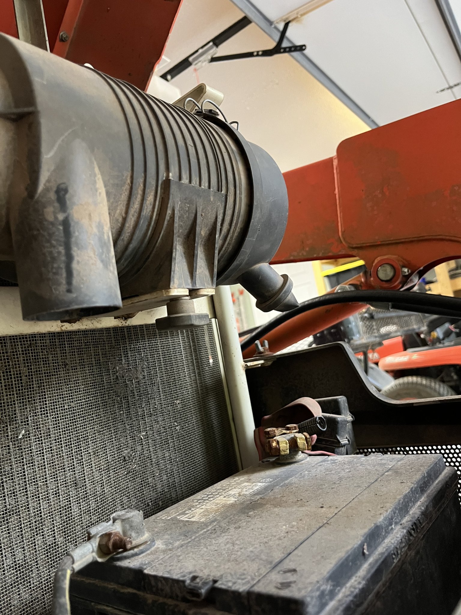

Mine is gone by previous owner and i can't seam to find whatever holds the air filter assembly in place.Any ideas?

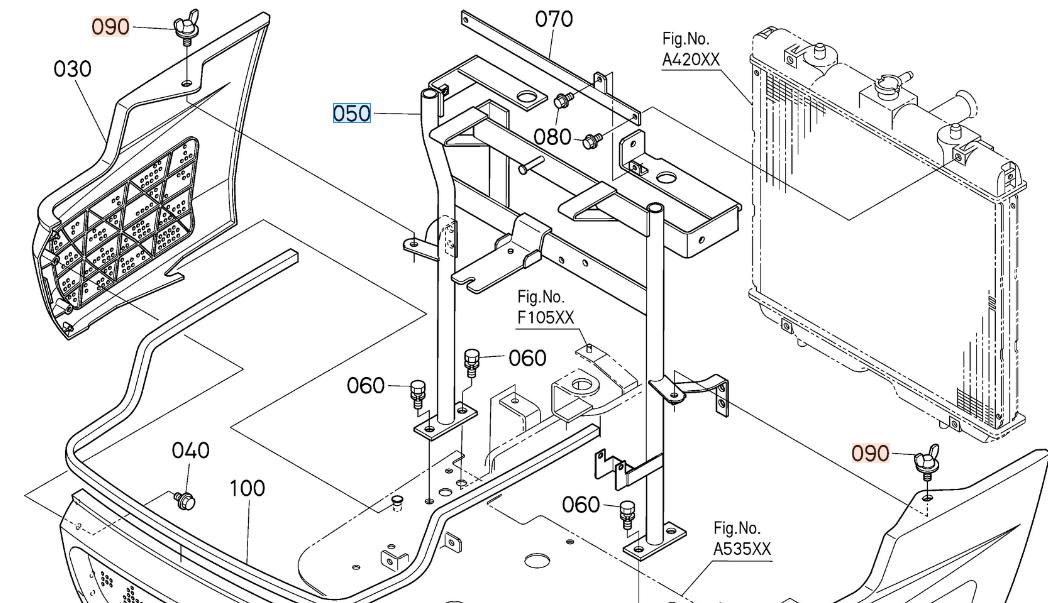

Where did you find a diagram please?My air filter is held up by tie straps right nowParts diagrams show it’s bolted to the radiator support structure on the bottom side of the air cleaner assembly.

There are illustrated parts lists at these sitesWhere did you find a diagram please?My air filter is held up by tie straps right now
That is what I had found when I went to the Kubota site. But I went back and looked it up again and came up with a different diagram. After running thru all the superseded by, the parts number I came up with is TC220-18350 Front support. It is number 50 in the diagram.What model tractor is this from?

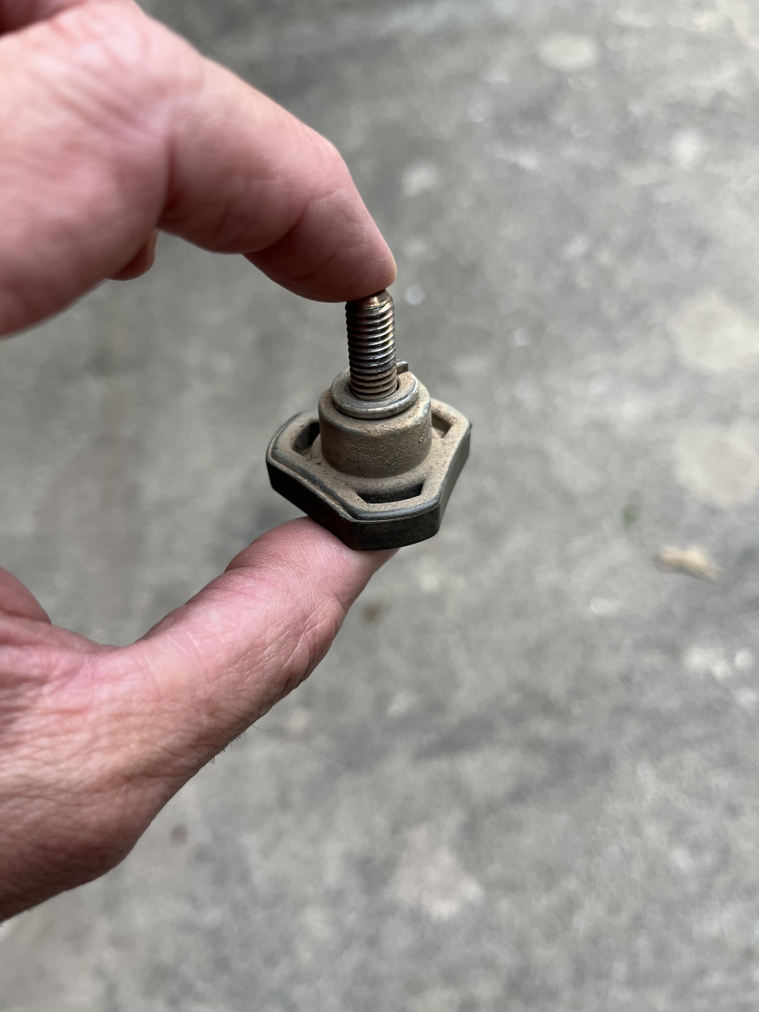

It looks like its only missing bolt washerWhat is yours missing? Not sure about the other poster that listed a part number and the diagram doesn’t match a L2800.
The radiator support is several hundred dollars. Something could easily by fabricated to hold the air cleaner.

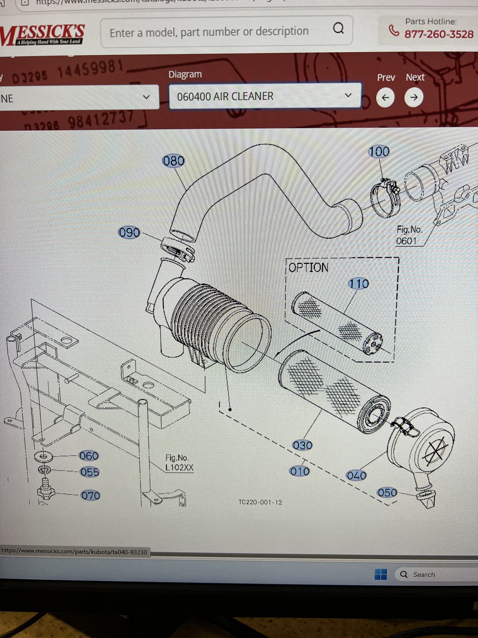

It looks like i only need #55,60 and 70 if thats all that keeps it in placeWhat is yours missing? Not sure about the other poster that listed a part number and the diagram doesn’t match a L2800.
2010 L2800That is what I had found when I went to the Kubota site. But I went back and looked it up again and came up with a different diagram. After running thru all the superseded by, the parts number I came up with is TC220-18350 Front support. It is number 50 in the diagram.

#70 is really all you need, and find some extra washers laying around:It looks like its only missing bolt washer
I ordered 2 and the little rubber piece on end of filter housing.Mine was gone.Shipping is what hurt...lol#70 is really all you need, and find some extra washers laying around:
