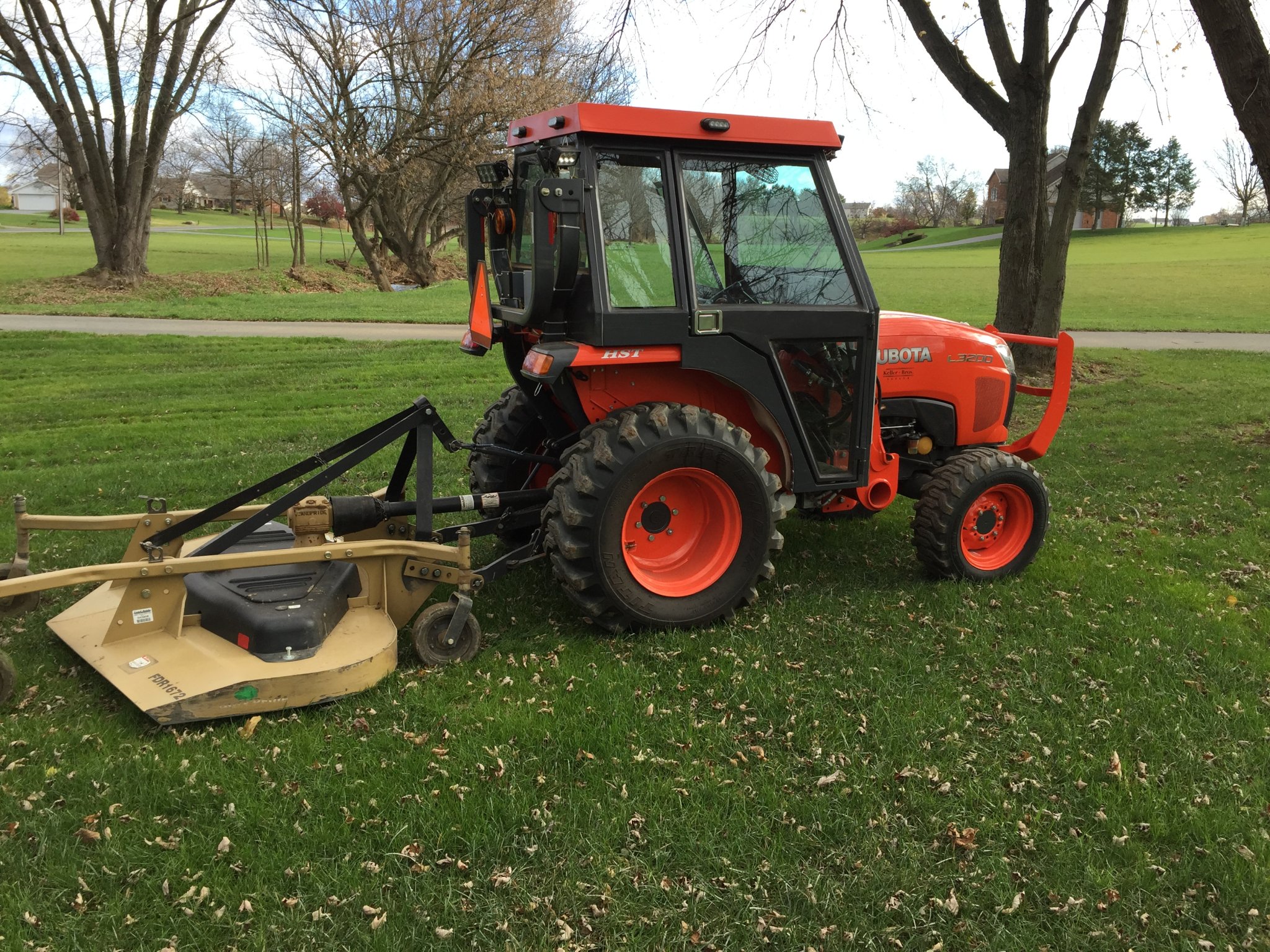

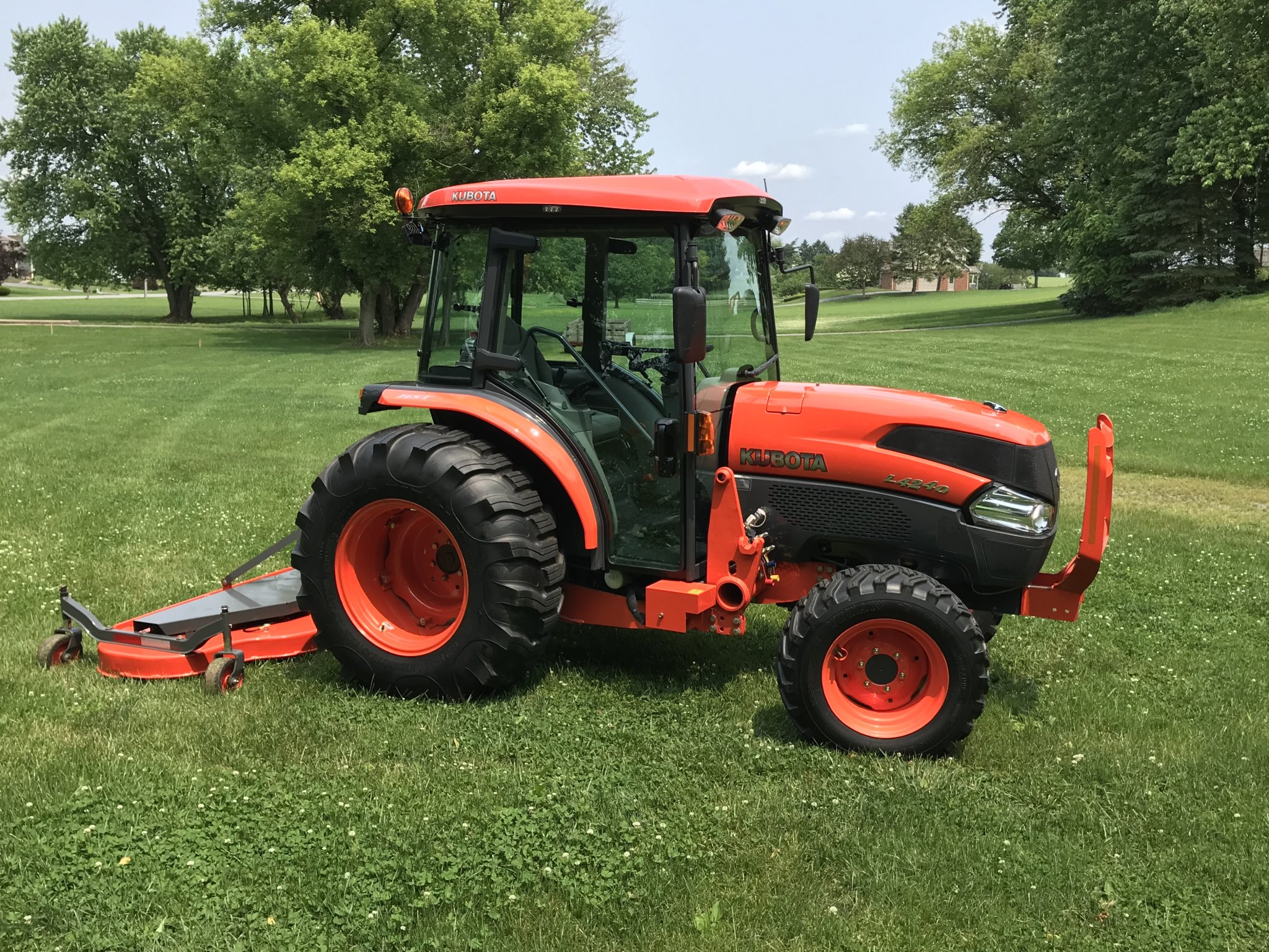

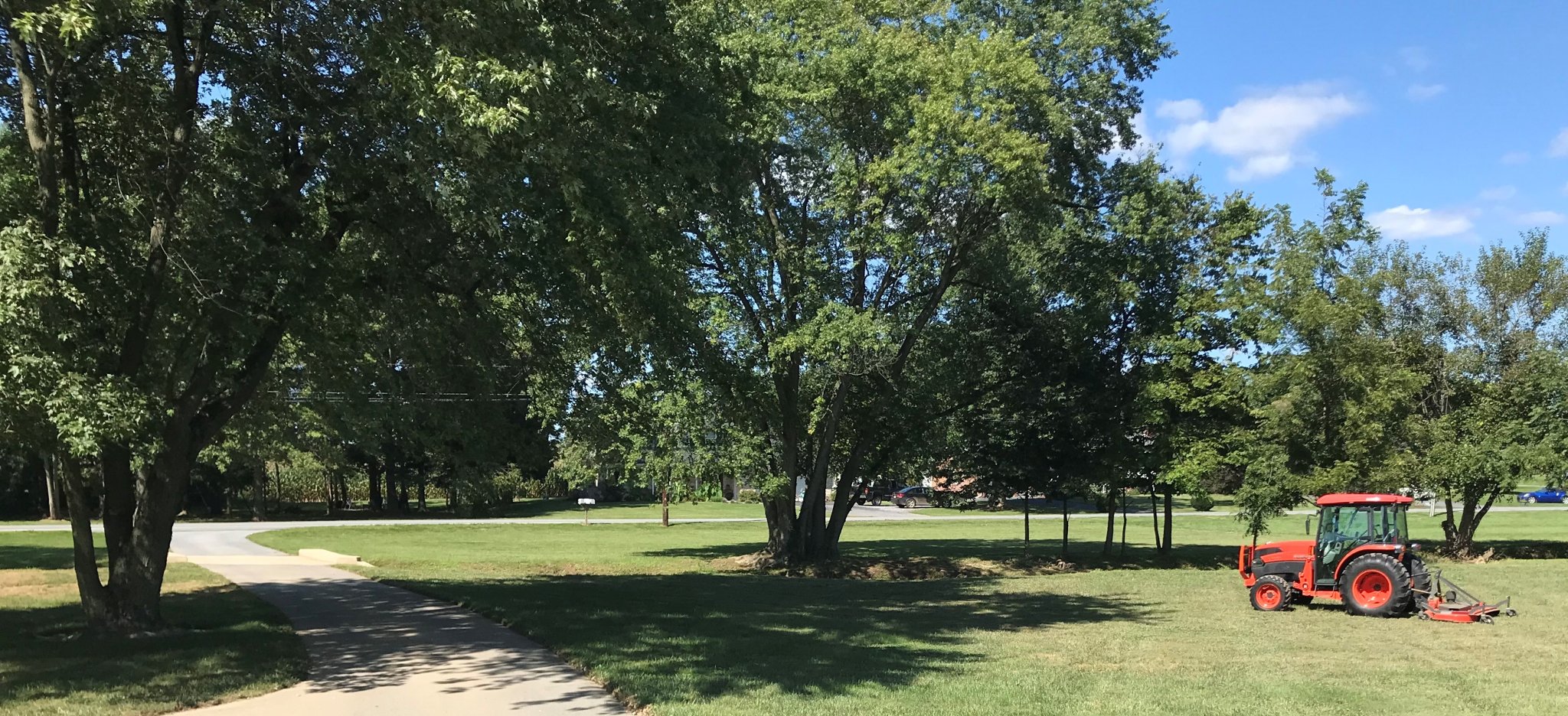

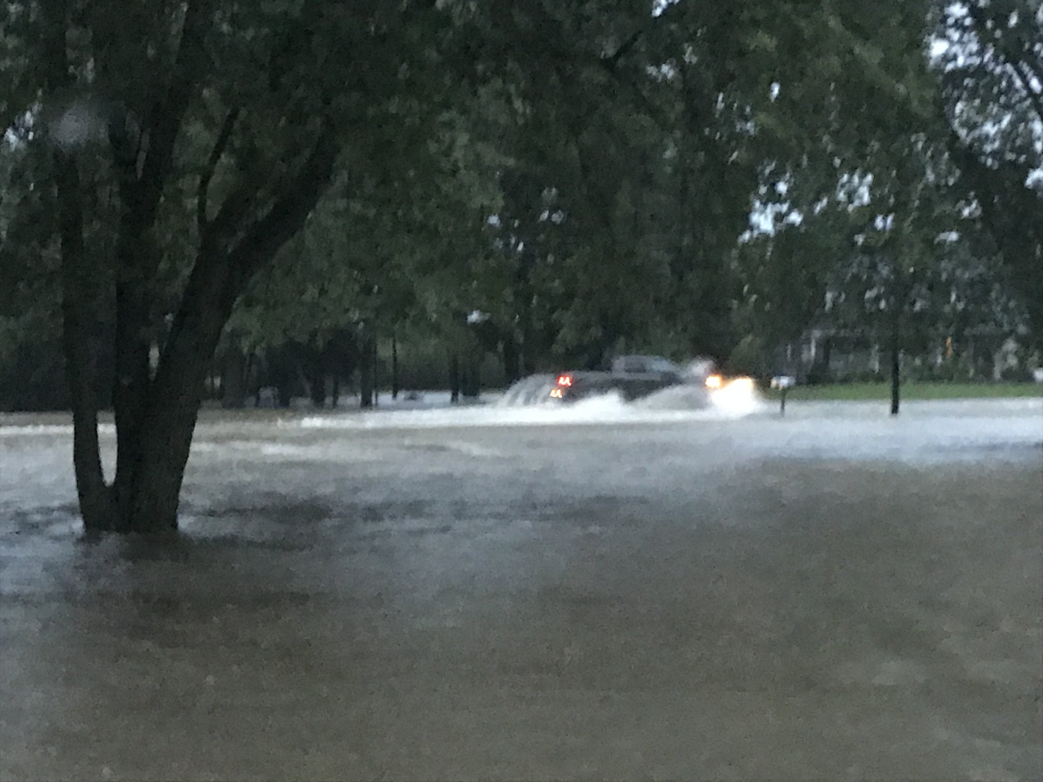

Everyone's land has its own characteristics. Tractors work great for me. The previous tractor, L3200 w/DIY cab had a 6' Landpride. Current L4240 has a 7-1/2' Caroni. Both with loaded rear tires. Loader and frame always removed for mowing. My little Ford 1210 w/ 5' Caroni and unfilled R1's leaves more marks. I can get on the lower yard within a couple days after flooding. The flooded and mowing pictures were taken on 9/1/21 and 9/4/21.
