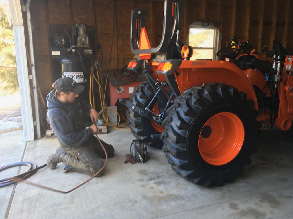

I had my rear R-4's filled on the new Kubota L2501 today.
The product used is Bio-Ballast. 30 gallons per tire and should give a weight increase of close to 600 lbs total. It will give me more confidence as my 56 acres is rolling hills.
I still plan on keeping either a box blade or brush cutter on the three point also which will be an additional 500 to 700 lbs.

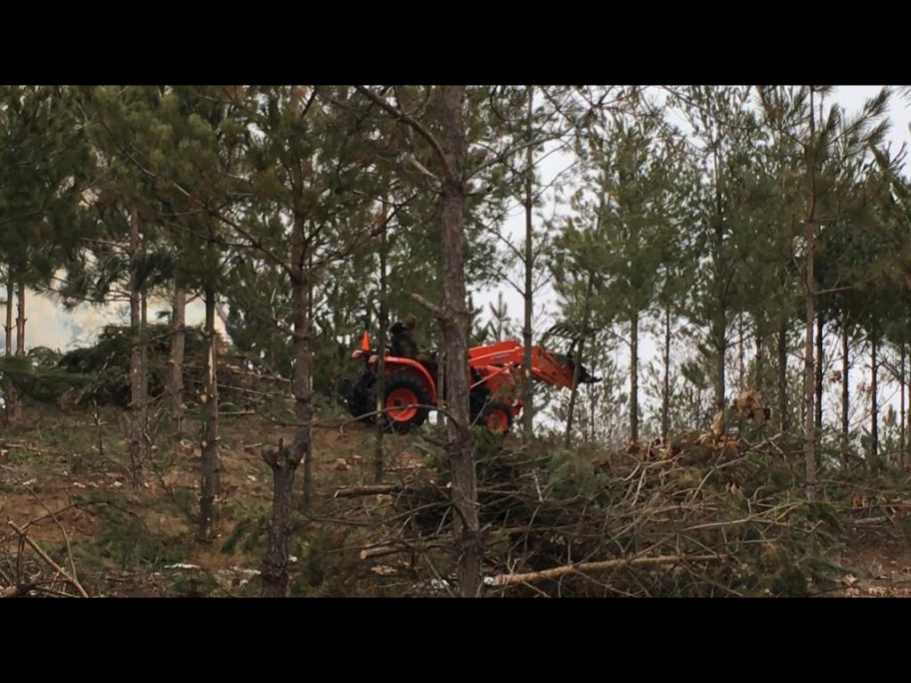

Put the new tractor with LP grapple and filled tires to work on my land.
I can not imagine doing this work without having the tires filled, and also looking forward to a box blade or other implement giving me even more rear ballast.
The photo really does not show the terrain very well. This area is also complicated by having stumps that are from 3 to 6 inches above ground level.
