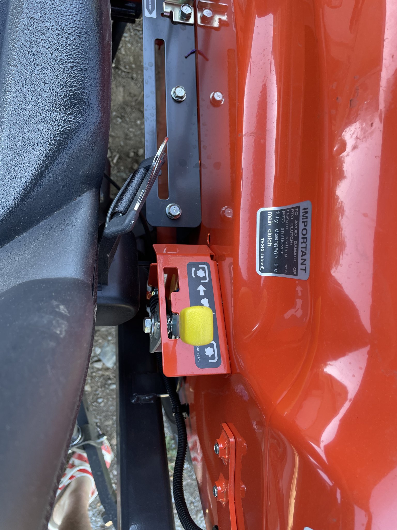

-The PTO lever that’s behind the drivers seat, im assuming is only for rear implements? I used forks and loader bucket for a couple hours yesterday and never touched that lever In the picture.
-the differential lock - does the tractor have to be in neutral before pressing down on this lever, and then back in neutral to release?
-is the tractor supposed to be in neutral before pulling on the FWD lever?
I have no experience with HST vehicles and just ASSumed that without manual gear selection, these things weren’t necessary but now I’m second guessing myself.

The PTO lever controls the PTO at the rear of the tractor. Depress the clutch before engaging or disengaging. It's the only PTO on the L2501. The speed varies with the engine speed which is why you have a PTO marking on the tach at about 2000 rpm. The tractor need not be in neutral to lock the differential but should not be moving when doing so. The tractor need not be in neutral to engage FWD but should be stopped. Depressing the clutch may help. It seems to get easier to engage over time. Like a manual transmission select a gear appropriate to what you're doing. Of course the tractor should be stopped when changing gears. I spend most of my time in M or L. If you use the parking brake remember to release it to move the tractor - it will save wear on the brakes. It's easy to forget.

I've owned an L2501 - never had any problem shifting into and out of 4x4 on the fly, so long as the front and rear wheels are not turning at different speeds (not spinning or turning). The clutch is required for engaging the PTO, which is the yellow lever on the side of the seat. You would only use this if you had a PTO-powered attachment mounted to the rear, such as a brush hog or flail mower, etc. The method that is easiest on the tractor is as follows: 1.) Lower RPMs to mid-level (not too low, not full throttle). 2.) Depress and hold clutch pedal down. 3.) Move PTO lever into "on" position. 4.) Gently ease off the clutch pedal slowly, feeling the PTO-driven implement spool up. 5.) Once clutch is released, bring RPMs up to PTO speed and begin operating implement.
