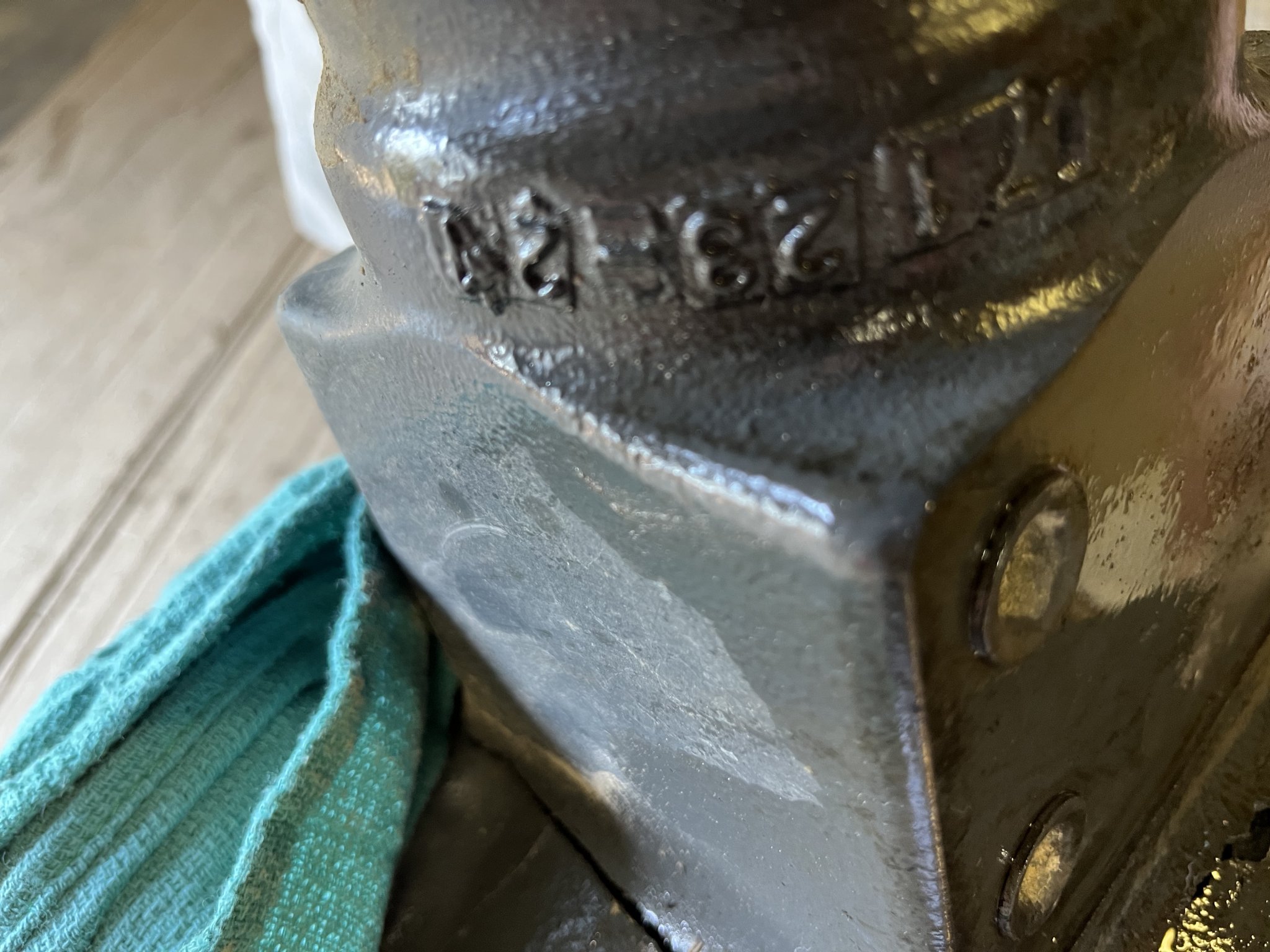

So what happened ? It would take a lot to break that.
yes it would.
I was clearing some brush and trees off property I had the tiller on it as a counter weight. I dug the root ball out and maneuvered to get the bucket against the tree and got in a tight spot with the majority of the weight on the left rear wheel. It popped like a stick of dynamite.

A new one is $560 canadian, pt# TC22027310. IF you get desperate, the old one could be welded by a good metal shop.

before you order the replacement part I would disassemble the tractor and check for internal damage. I had a Massey Ferguson 1528 and broke the rear axle housing. When we tore it down there was damage to at least two of the gears. The bottom of the transmission had shavings in it.
