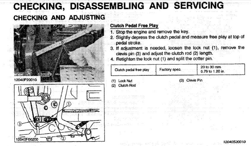

First try adjusting the clutch. See attached page from the WSM

Out of curiosity, is there freeplay in the clutch pedal or is it at the very top of the travel?
If you have freeplay, I'd say the clutch is toast. If not, it needs adjusted.

there is no free play in the clutch. When I did remove the pin and disconnected the pedal I could move the lever in and out of the transmission housing a little. If I push it tight to the housing the lever doesn't move at all. Bearing maybe?

You need to have free play in the clutch pedal.
No free play means the clutch is not releasing and thus the problem getting into gear.
Any test by hand is meaningless as the pressure plate springs are very strong.
The pedal linkage provides a lot of leverage and at the clutch pressure plate the necessary movement is small to effect the release.
