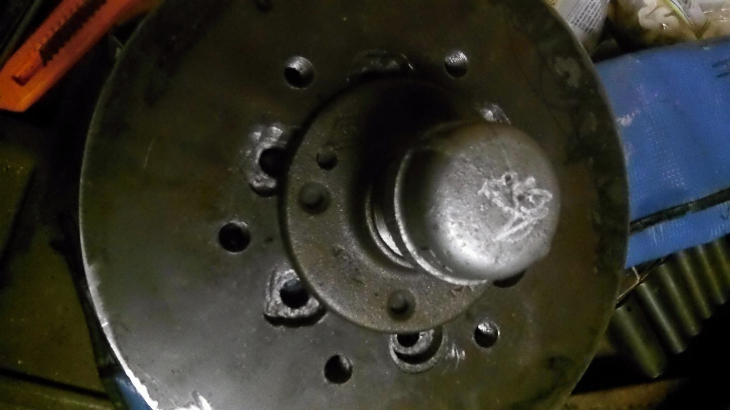

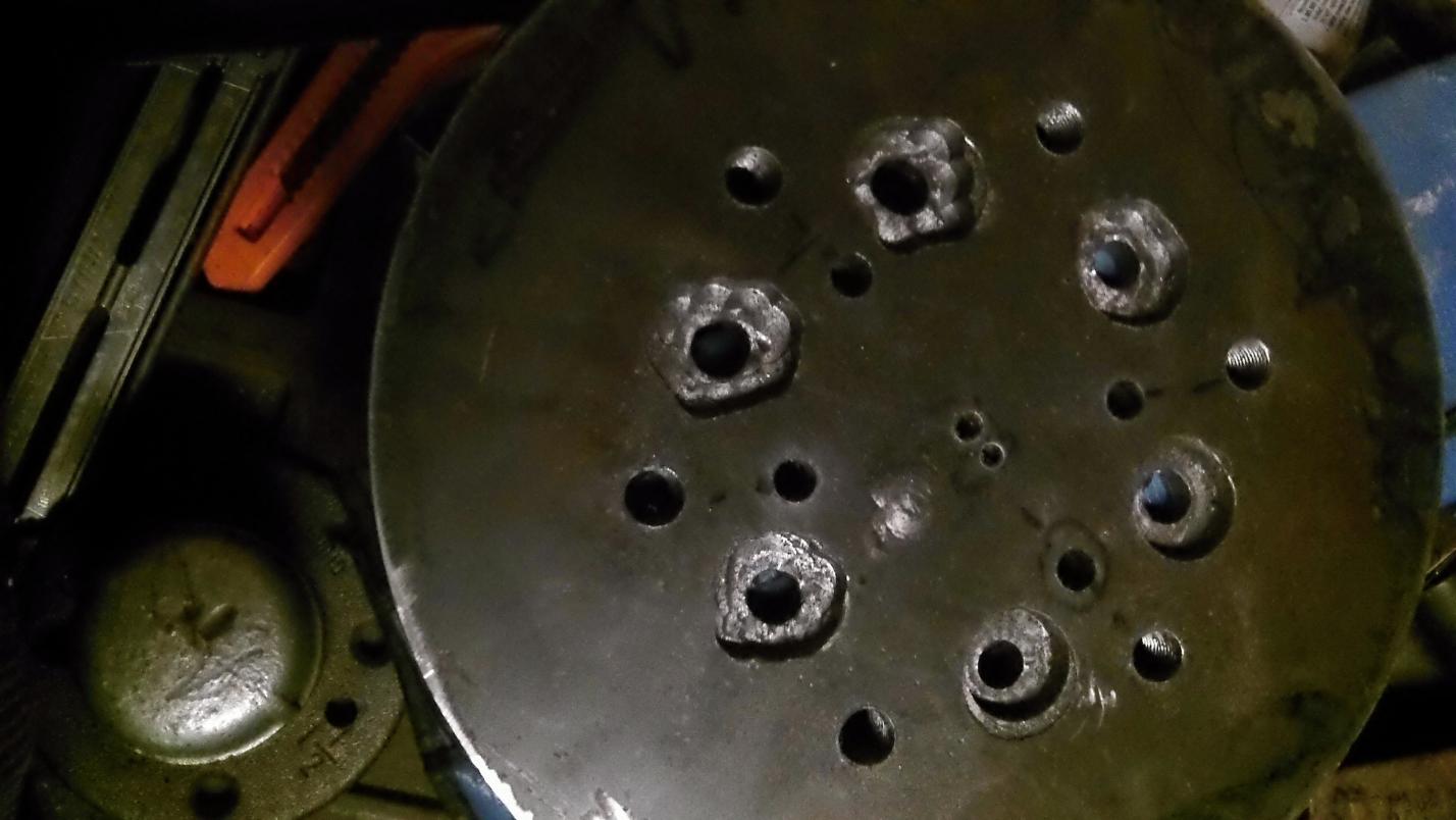

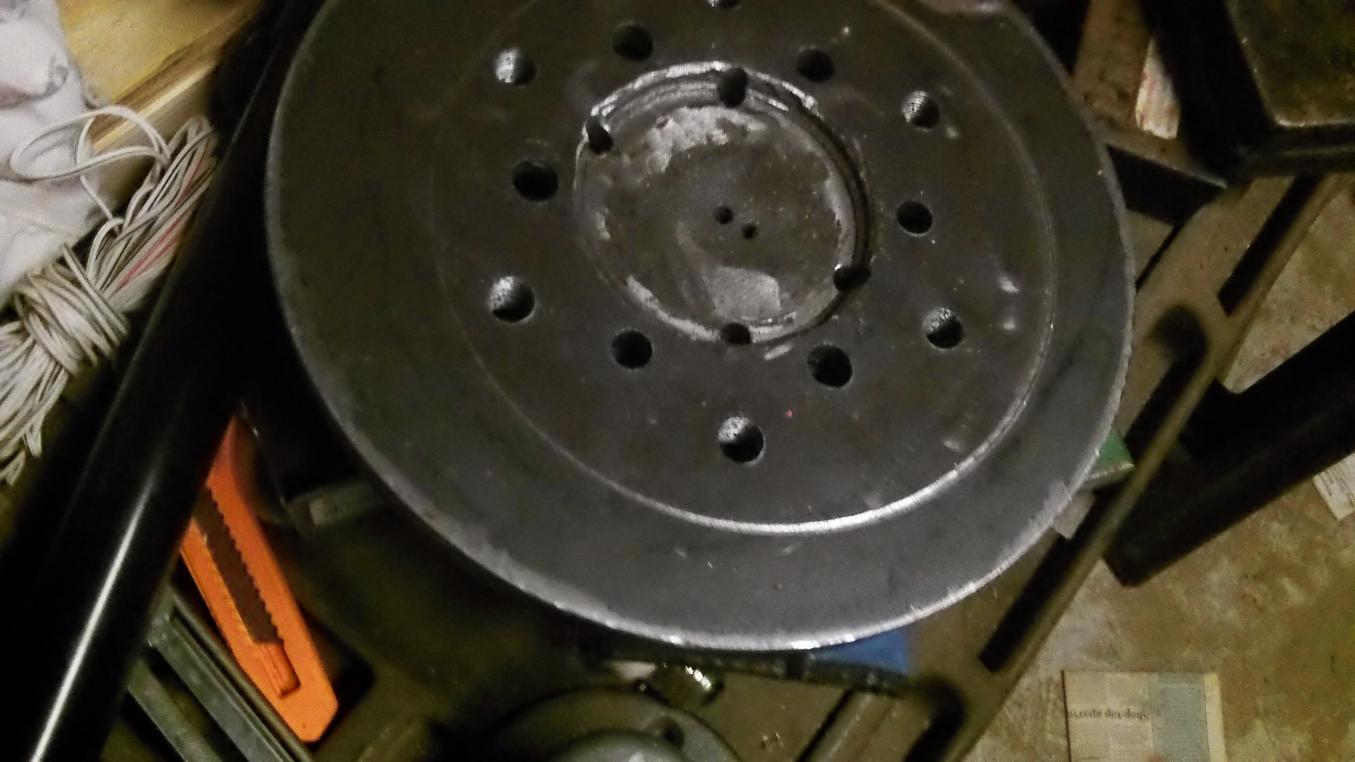

After researching the lead lag ratios and deciding what size tires i could use i made my own wheel adapters. My front rims were a cobblejob when i first bought it and new rims were too expensive and almost impossible to find anyway. I bought 3/4" steel plate drilled and tapped everything to fit and today finished at last. I have a brand new set of tires and rims that were takeoffs from another newer kubota. They have the 6" on center bolt pattern and the 4 and 5/8 pilot hole. In the spring i'll put new shoes on my orange baby.:)

Heh break an endmill drilling out those pockets? Looks good. Though what goes into those threads? My gut says a bit more thread would be a good idea. Maybe stick some nuts on the backside?
almondjoy1955
Mar 8, 2012
20
Au Gres Michigan
The threads are for the lug bolts for the new rims. 14x1.5. I did use a 1" end mill to start then had to go to 1/2" after dulling the first one. I finished the second plate with a new 1" carbide end mill. The pilot hole piece will be held with 4 roll pins and then weldedThe large bore holes are for countersinking 12x1.25 bolts onto the tractor hub.

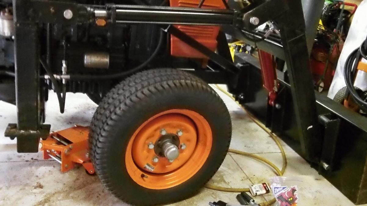

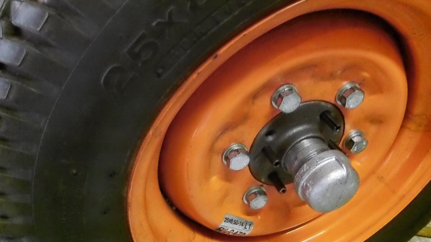

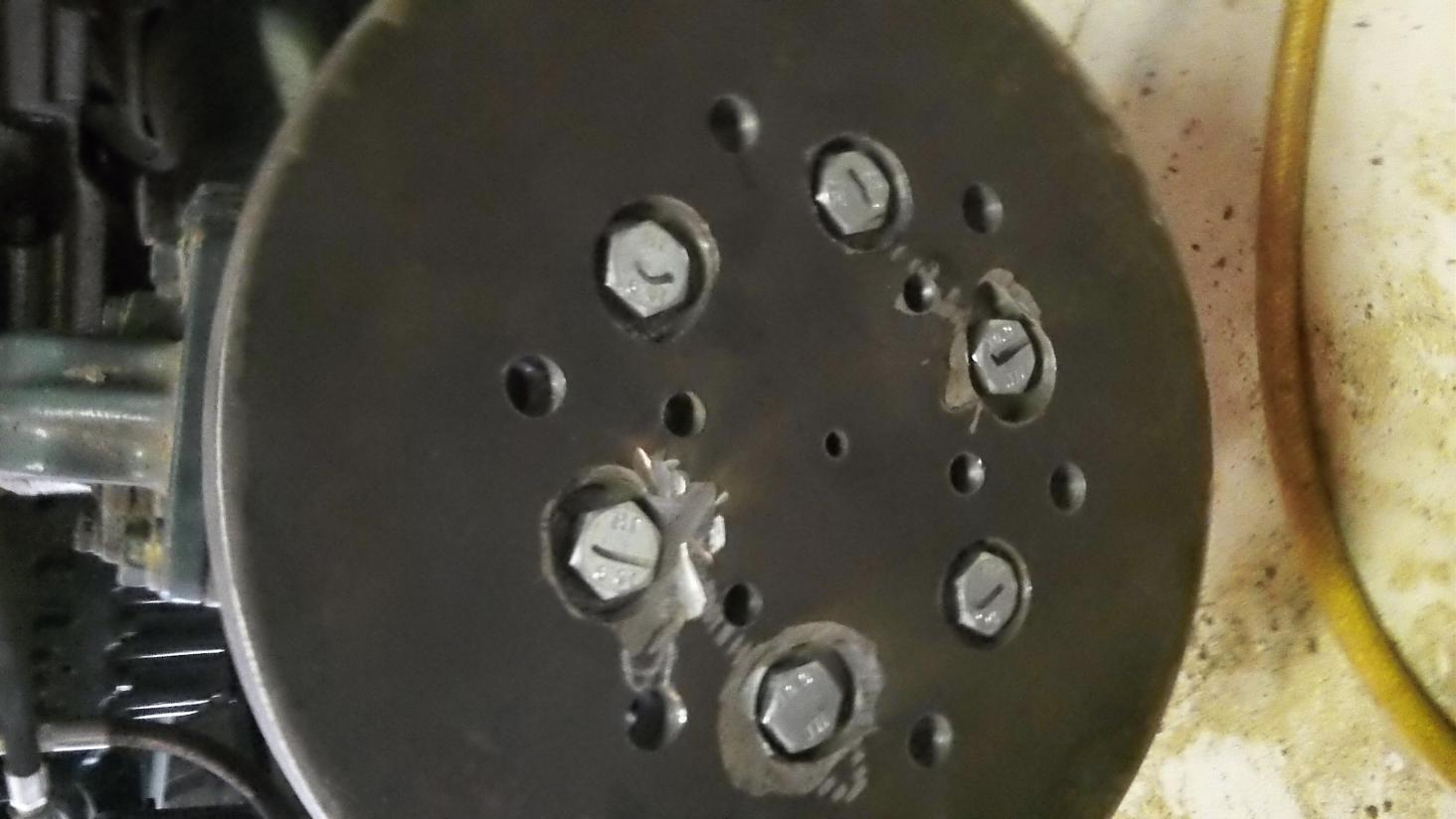

Baby got new shoes today. Here are a few pics. I made adapter plates for the new rims and tires. The l245dt was so hard to find rims for so i made plates so i could use most any Kubota rim. The old rims were in bad shape. The pilot hole and the lug pattern were almost impossible to find. I still have the same size tire and my lead lag ratio seems to be within spec.. When I get more time i'll double check. So far all is well that ends well.
