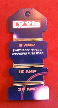

I have everything rewired now but my headlights don't work. The grey fuse box on the dash has three flat metal wire things that are 10 A and 5A fuses. The two 5Amp wires are broken. If I cross the poles my lights work, so I obviously need to replace the two 5 amp links. I've looked at tractor supply stores and auto stores with no luck.
Where do you find those flat 5 amp fuses? Can I just buy the 5 amp fuse wire off ebay and make my own connections?

Post a pic or a link to the ebay item you found so we can see it.

This is what I've found on ebay. I haven't been able to find a single picture of the actual fuse online. I'll take one of my tractor and post it. I guess I could wrap this in place of the broken ones.

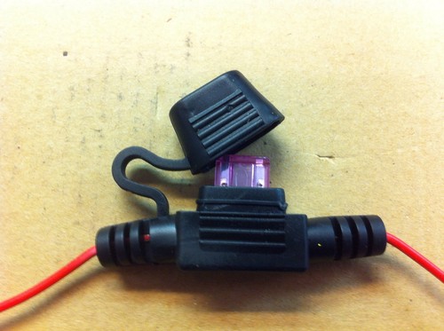

I wondered about that too. Given the apparent rarity of these crazy fuses, this is probably the way to go. Thanks

Are you sure they are not just regular fuses with the glass tube broken away?
I have a L185 and have not looked at the fuses lately but could almost swear they are the older style (1960 - 1980) fuses (glass tube with the flat metal that is wide at the ends and thinner at the middle). Sounds like what you are saying without the glass...
hope this helps and I am not too far off base but I have never seen a fuse without some insulator around it.

I ended up buying some foreign car fuses and taking the metal off and screwing them in place. It worked fine. I think taking the wire from a glass fuse would work too, but the 5 amp glass fuses have tiny wires, so these worked better. My tractor is all re-wired from the melt down and everything works. Good thing, because I had about 18" of snow to plow today!

It's not nice to be bewildered.
Wire is cut, wrapped post to post, secured.
Not a fuse encapsulated in glass.
