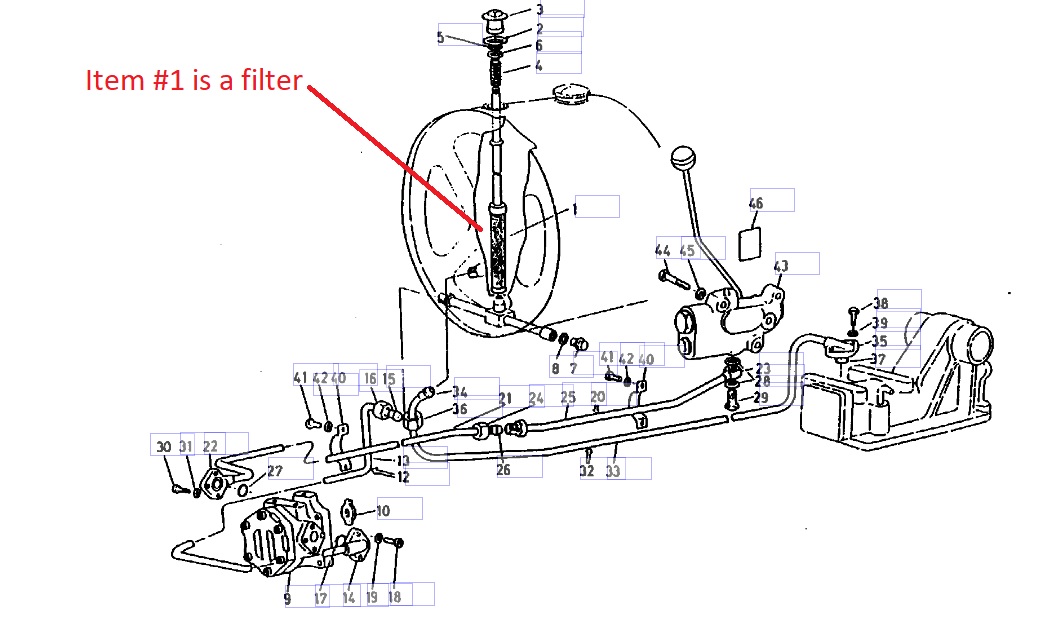

Parts info for a L200 seems scarce.
I see it has a suction filter as I have marked on the parts illustration for a L210 which I believe to be similar..
I find the illustration to be confusing but with the real tractor it all may make sense.
Follow the large pipe/hose from the hydraulic pump and you will find the filter.
It needs to be cleaned or replaced.
If there are rubber hose sections along the suction line for the hydraulic pump these would be highly suspect to be allowing air to be drawn into the hydraulic system.

This is helpful, thanks! Do you have this as jpeg?
Or perhaps entire manual? I've been piecing together some images of the hydraulics, and a manual would sure help!
There is a low quality workshop manual on Kubotabooks.com that claims to cover the L210 among other models.
Kubotabooks.com
The image from my first post is a jpeg.
First click on the image and it should then appear as an indiviual page with nothing else, next you right click on & it a menu should pop up saying Save Image.
