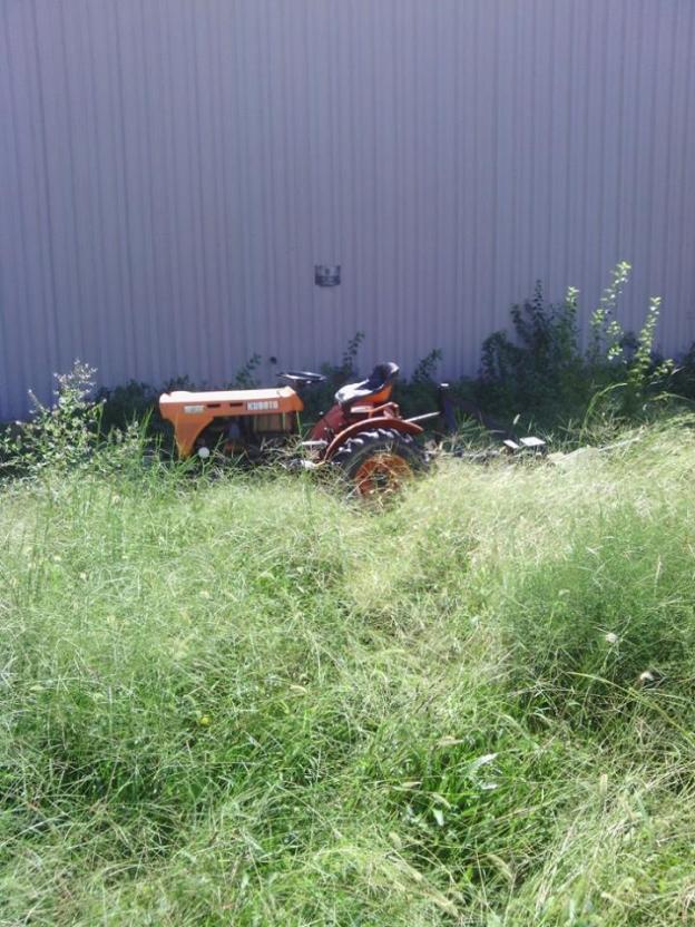

L185 w/ 4ft cutter seems to struggle to much?????

now i cant say about the L-185 but my L-210 as a throttle limiter screw/bolt that limits how far the throttle can be moved. the other guys on here will have more knowledge of this for the L-185. but i would suggest looking at the movement of your throttle linkage to see if there is anything adjustable limiting movement.

You may need to adjust the engine valves. When I got my L175, I didn't really have a problem with the RPM's, but did have a lack of power.
Once I adjusted the valves, I had plenty of power to run the belly mower.
