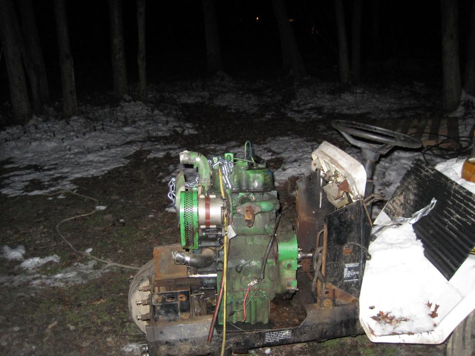

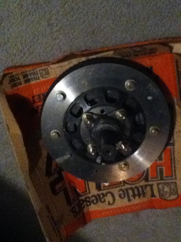

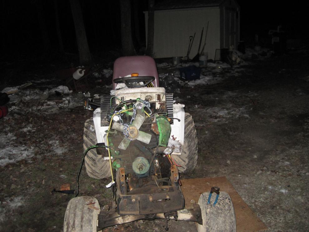

ok it doesnt sound as bad as i thought. some people make it sound like you need to remove the head and do all other kinds of stuff that doesnt sound like much fun. i figure the glow plugs shouldnt be too old since the tractor was owned by a NJ state prison and ive heard they are pretty strict on who does the maintenance and how often. so im sure the 2k hours on the engine is well maintained. also bridging the engine and driveshaft wasnt hard, for me. i had someone make the stub shaft fit the flywheel. he used a brake rotor for the job and it seems to be working well. some people told me the brake rotor would never hold up, but at almost full throttle ripping up the packed gravel on the top layer of the driveway it sure didnt break. heres some pics. the pic of the tractor is after my first weekend of engine hoist rental.

Ah it's a hydro that makes things easier. For a while there I thought you'd managed to rig up a new throwout bearing and clutch linkage. I like the brake rotor setup, already well balanced and plenty strong enough to handle this. Is it just me or are the outer bolt holes in the brake rotor just drilled at random?

they are somewhat random but there evenly spaced in a star pattern. it seems to be working well.i havent got to ru her today because of having to work and helping my buddy get his jeep started but hopefully tonight once the jb weld on the radiator hardens ill fire her up.
