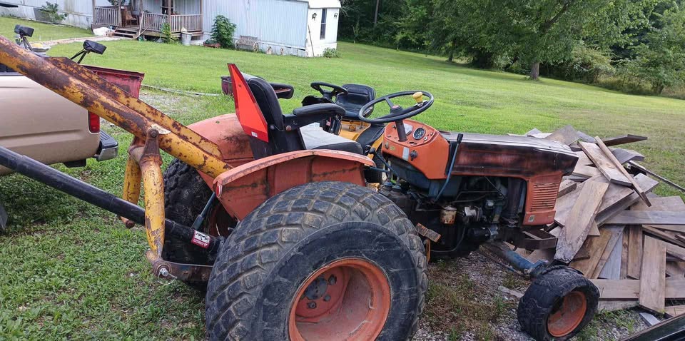

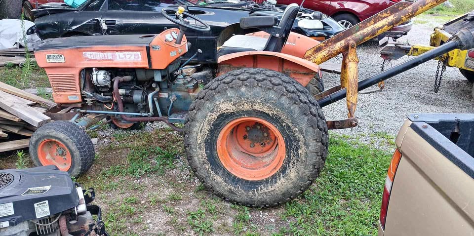

I found this L175, and even though I probably won't buy it, I am curious. The seller says it needs brakes, and I know that could mean a lot of different reasons why it needs brakes, but what is the usual culprit on a L175 brake problems?
As you can see it's in rough shape and the right front tire is shot.

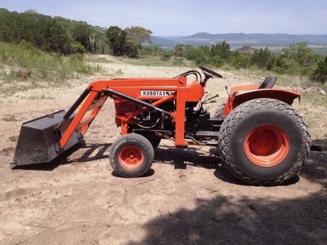

Nothing unusual about the brakes. Only problem I had with mine is the "0" ring on the backing plate wore out and that let dirt in, that led to the brake pedal not wanting to return after the brakes were applied. Cleaned it all up, replace the ring, problem solved. At the time it had turf tires on it which I replaced with R-4's. Brakes themselves had plenty of life left on them.
