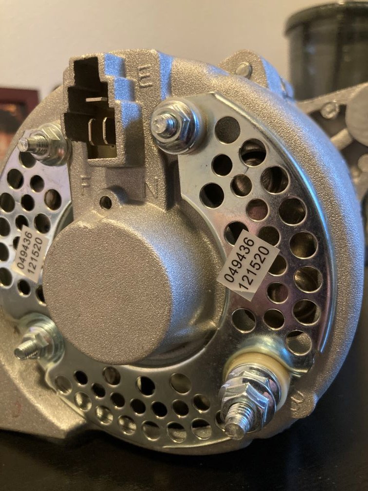

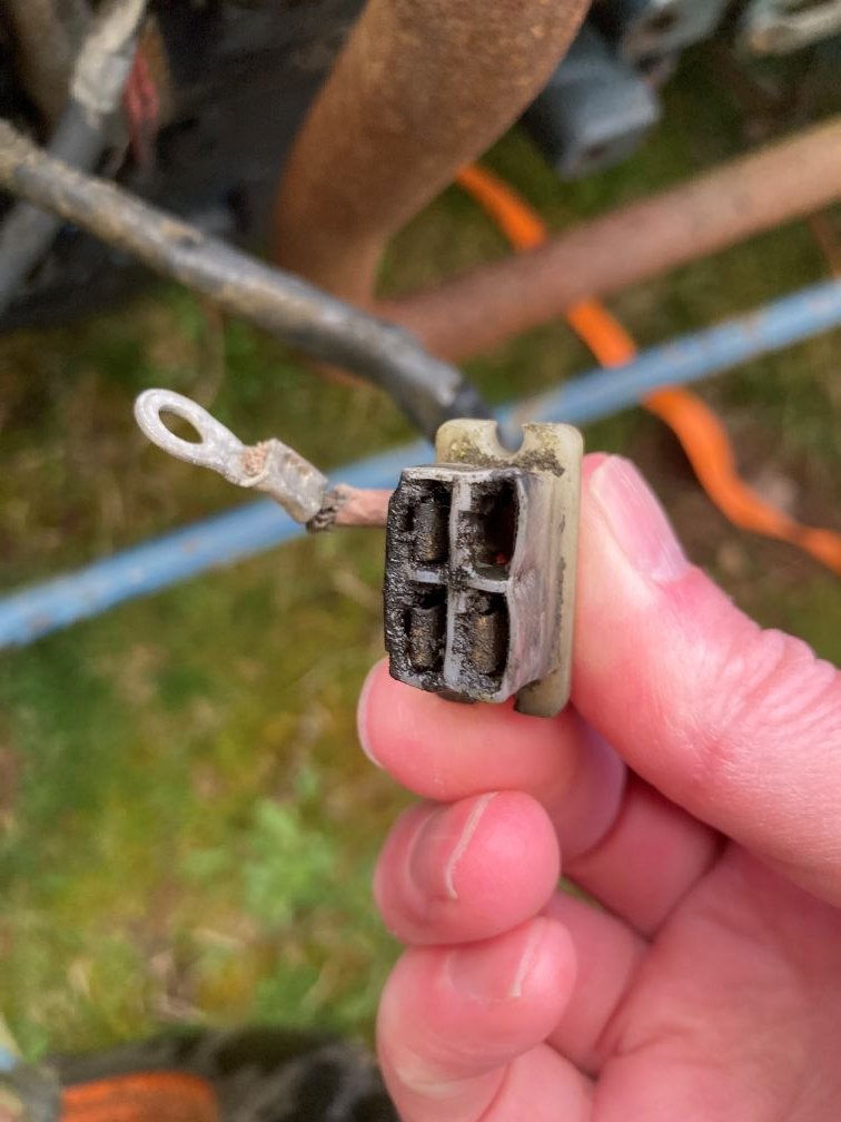

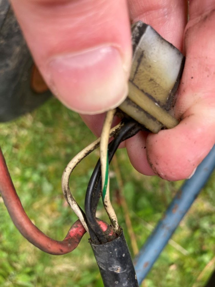

I inherited a Kubota L175 without an alternator attached. I also inherited a new alternator which cannot be returned. The problem is, as has been mentioned other places on this forum, the new alternator requires a 3 prong plug and my wiring harness has a 4 prong plug. I have read a lot here on the forums about this issue, but I'm really trying to land the plan on this wiring issue and being new to tractors and have not worked on cars for many years I'm wondering if there is concise description on how I wire this:
New alternator 3 prong labeled E, F, N with another bolt on the back labeled B. See picture
Old wiring harness with a 4 prong plug, only 3 of which are used: White with a green stripe, white with a black stripe, a black wire that appears to loop in and then out of one of the prongs. See pictures

the regulator is up underneath the dash. It is attached to the curved skirt section and is fairly easy to get to IF the steering wheel is easily removed (not stuck).
you do NOT need the alternator working at all to start and use the tractor. You would just need to have a way to charge the battery so it will crack the engine over.
White with green is F
White with black is N
Black is E
Heavy gauge Red is B
After you get the tractor running and operating then you can worry about a alternator repair or replacement.

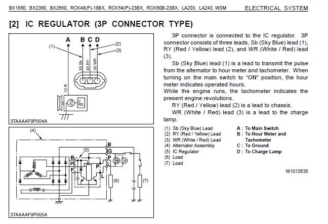

The alt has an internal regulator and it has a 3rd small wire for tractor models where the alternators internal regulator sends pulses to the dash tach.
I think you could just leave it unconnected.
