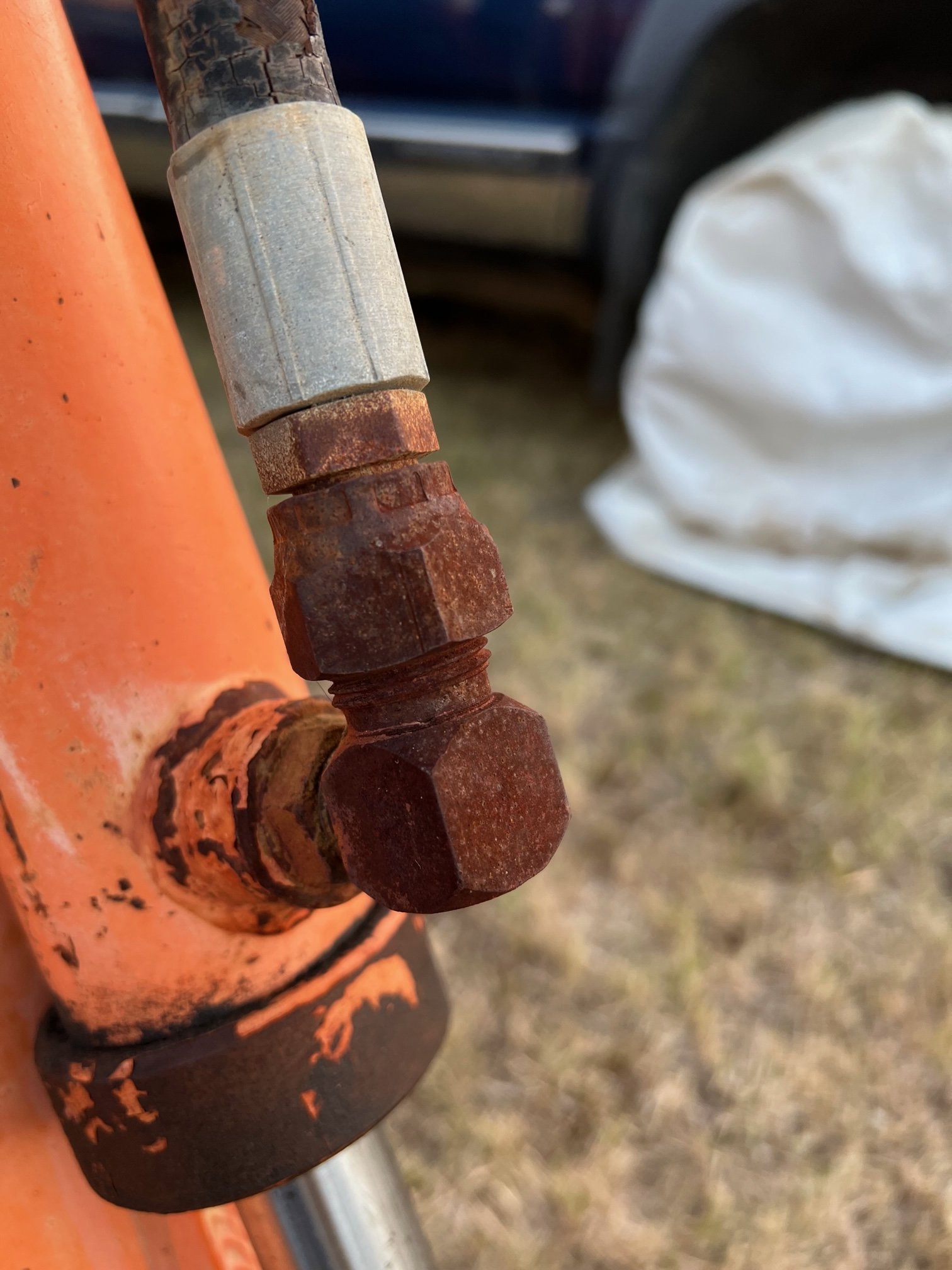

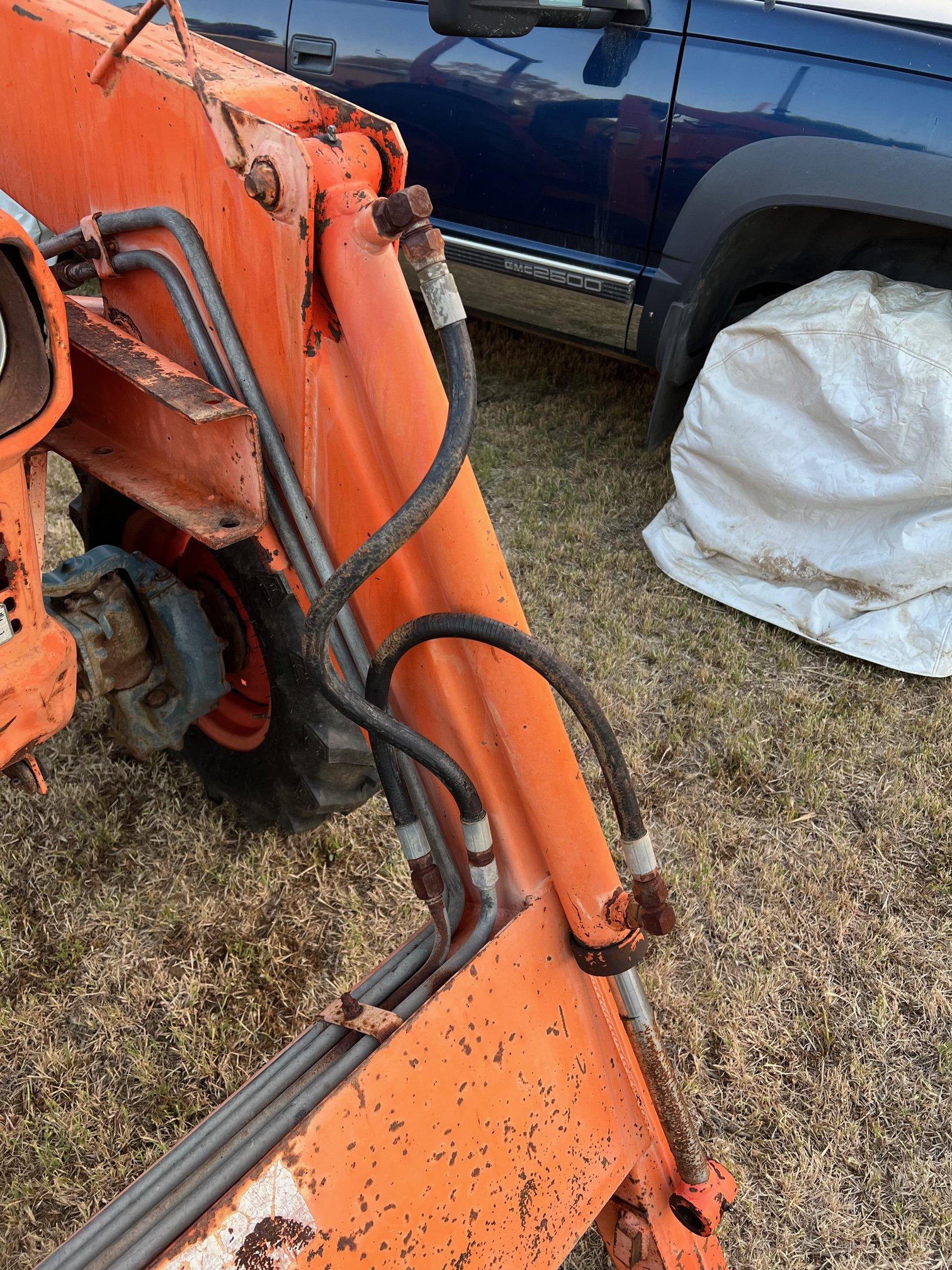

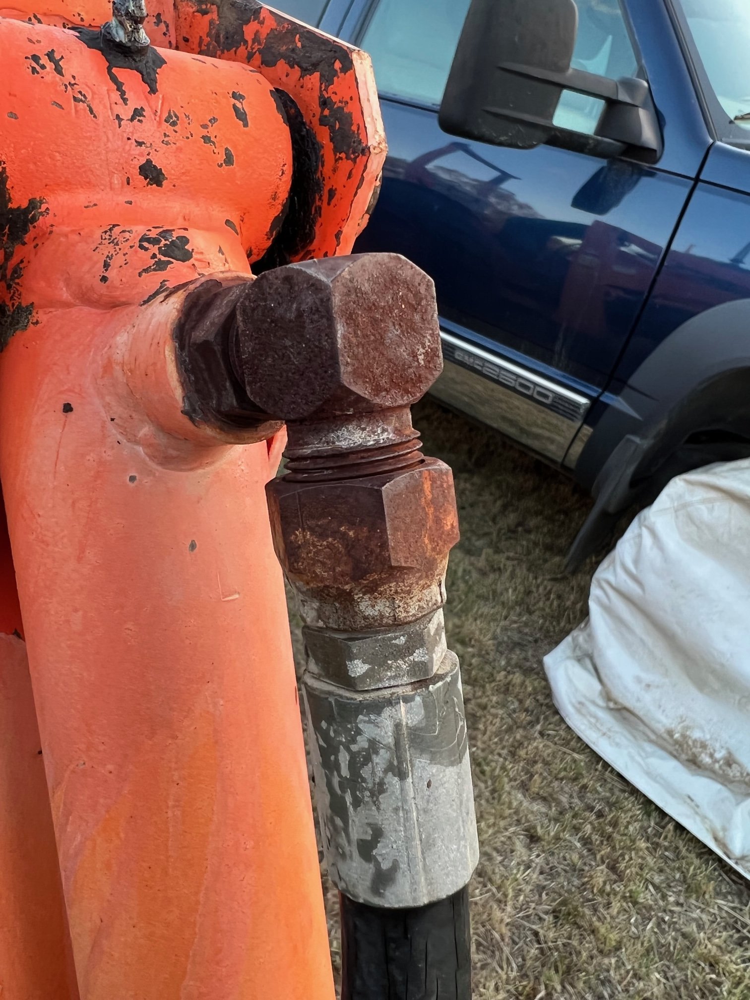

Kind of a simple/silly question, but reading through the manual I have and also scouring the internet, I cannot find any info on the fitting type or size for the 1720 hose to cylinder connections. I want to take the cylinders off for a rebuild and want to have caps & plugs on hand before doing any disconnecting. The connections from the hose to the 90 elbow at the cylinders appear to be a JIC type of fitting as there are only 3 threads showing on the male part of the elbow (hose end is female). IME, if these were straight pipe threads, there would be more threads showing, and I also cannot see any taper to the threads, but kind of hard to eyeball that with only 3 threads....
If anyone has any info to share on the type of fitting, it would be greatly appreciated. Not as concerned about the size, but if someone knows off hand, that saves me from breaking out the calipers.

View attachment 101985 View attachment 101986
The hose swivels could be JIC or NPSM. IIRC they were NPSM on my B1730 loader. Remove one and size and type will be obvious.
EDIT: Quick look at the manual says ports are JIC-8 (3/4-16 UNF). Its pretty safe to assume the hose swuvels are the same.

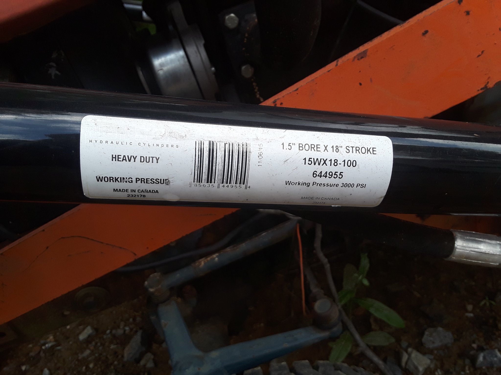

What makes you think the cylinders need rebuiilt? If they do I would chuck those rusty relics and stick brand spanking new ones on. I think these were roughly $150 each and were quick pin on replacement for the OEM cylinders on a B1730.
Thanks Dan. The right side attachment cylinder is leaking from the head. Makes a mess. Was thinking to just rebuild them both while the bucket is off. I hadn't considered new, probably not a bad idea given the condition of the rods. I'll do some research on that.
I wasn't aware of NPSM threads, so read up on those this AM. Will grab both JIC and NPSM caps & plugs so I am covered when it comes time to remove the hoses. Appreciate the input.

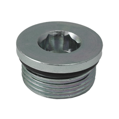

Buy two of these and never look back.
The ports in the cylinders are SAE-8 - just get four plugs. You can use the plastic thread protectors from them as caps for the male SAE end on the elbows.
i have never seen an NPSM cap.
6409-8
