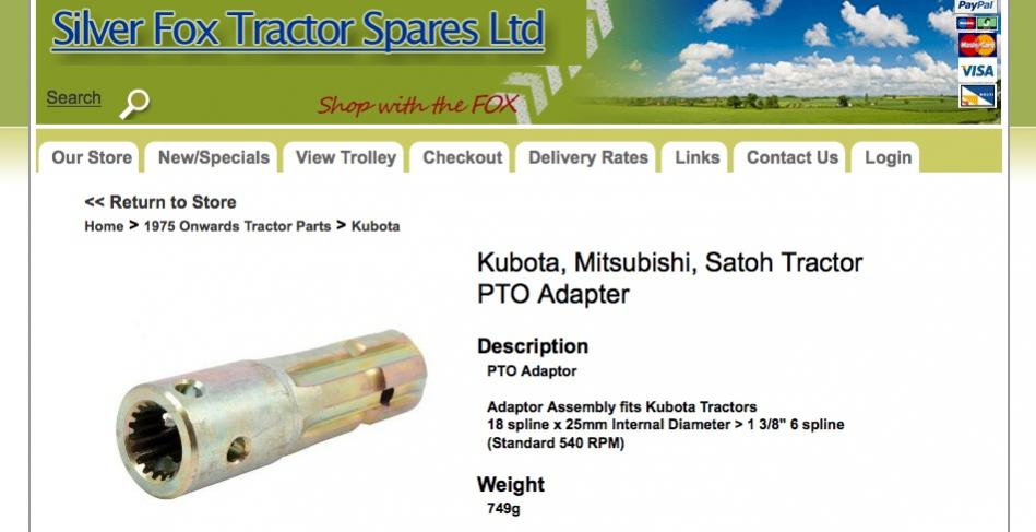

Are you asking about a power take off drive shaft yoke or an internal drive shaft on the tractor. If you are looking for the power take off drive shaft 18 spline yoke their are adapters that will convert it to a normal 6 spline.
