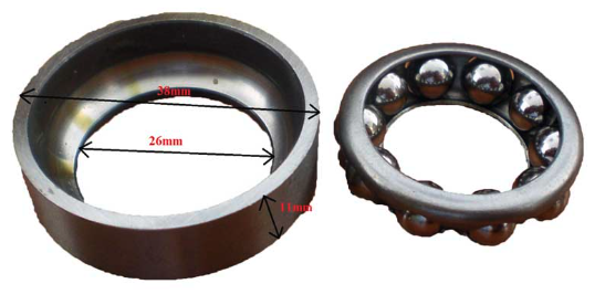

In the steering box I've already replaced the shaft bearings (x2):

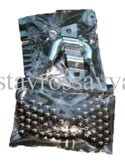

And replaced the 60-odd little ball bearings and guides in the shaft. (What a fiddly job that is!)
