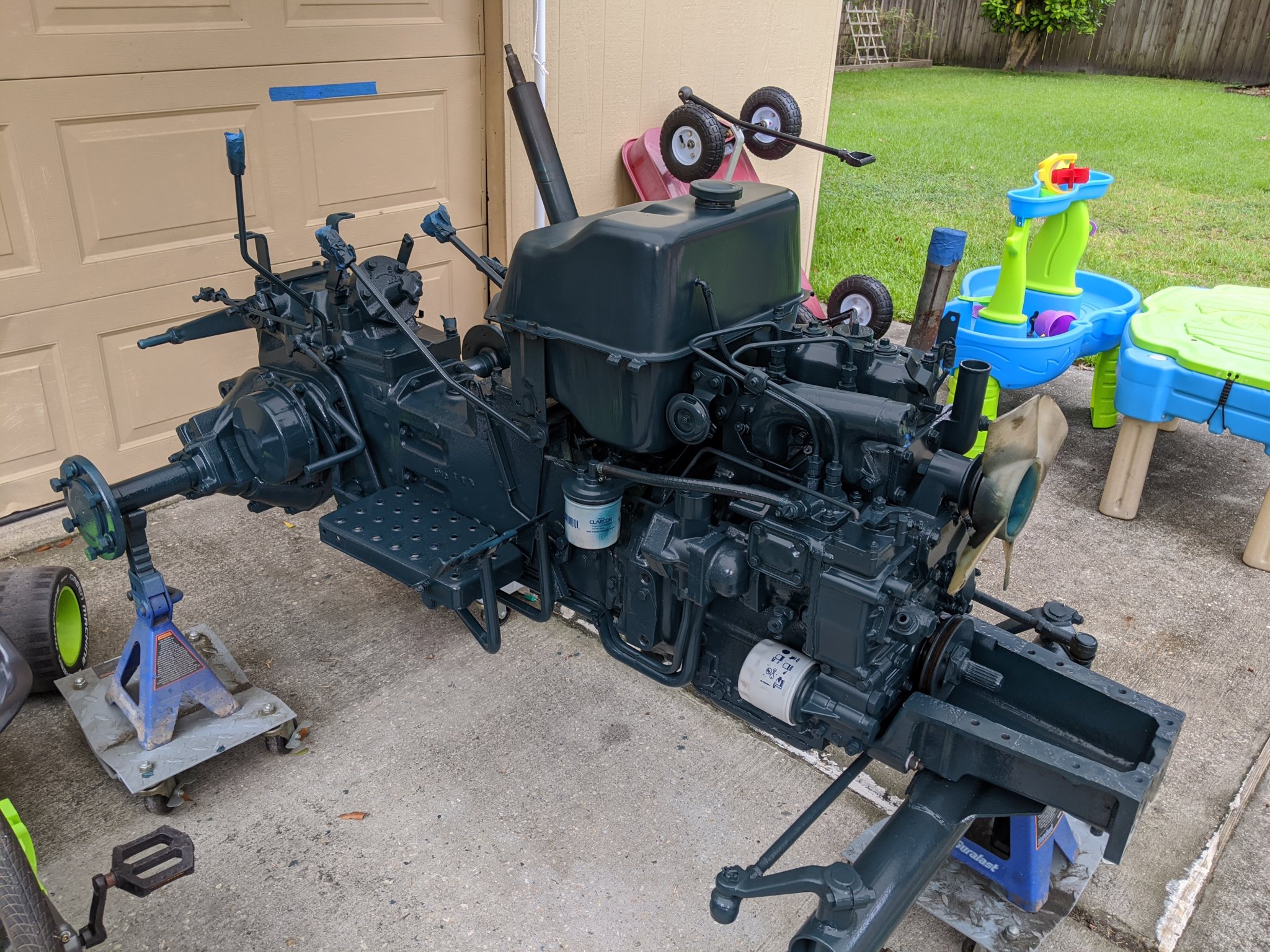

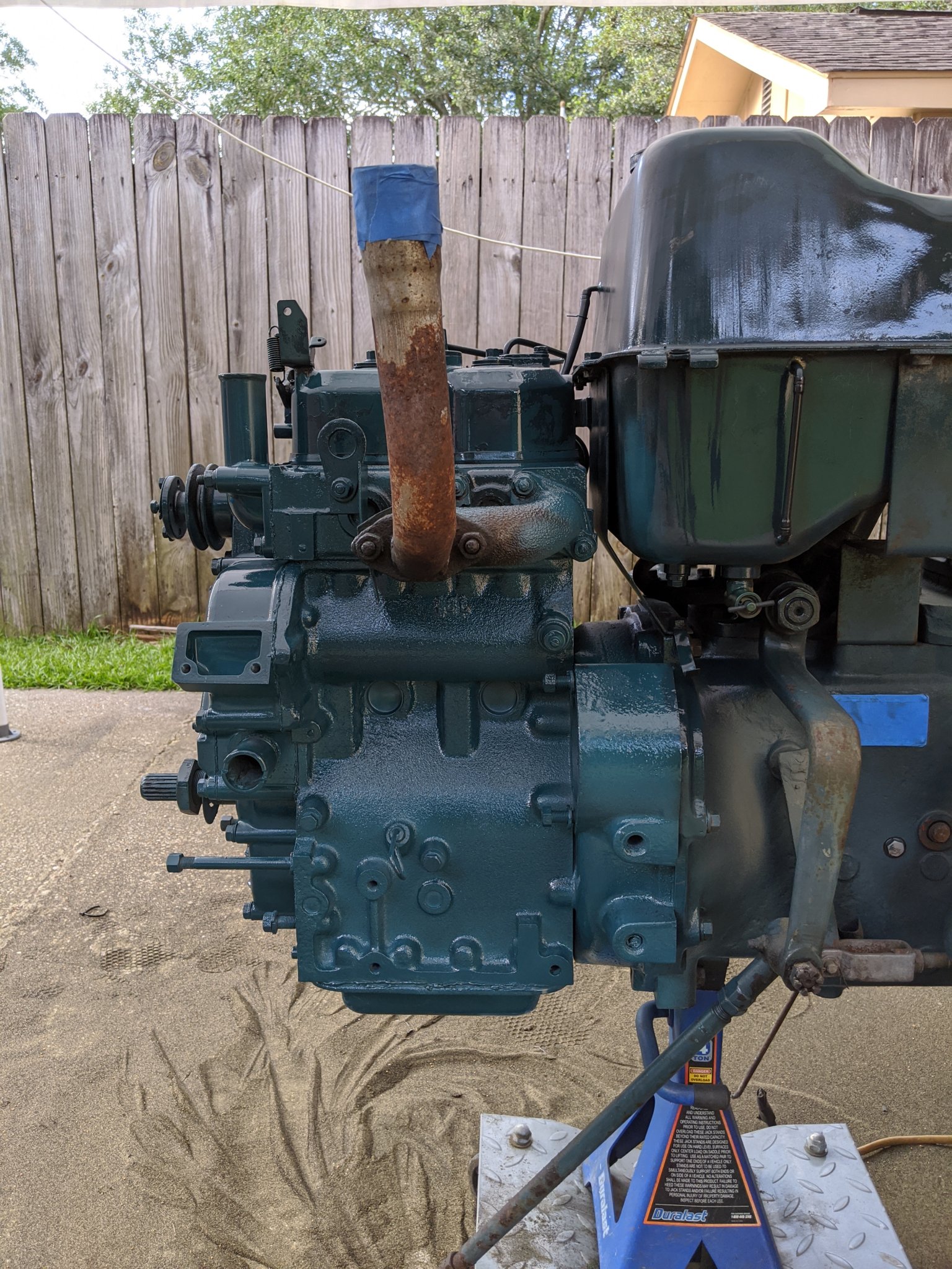

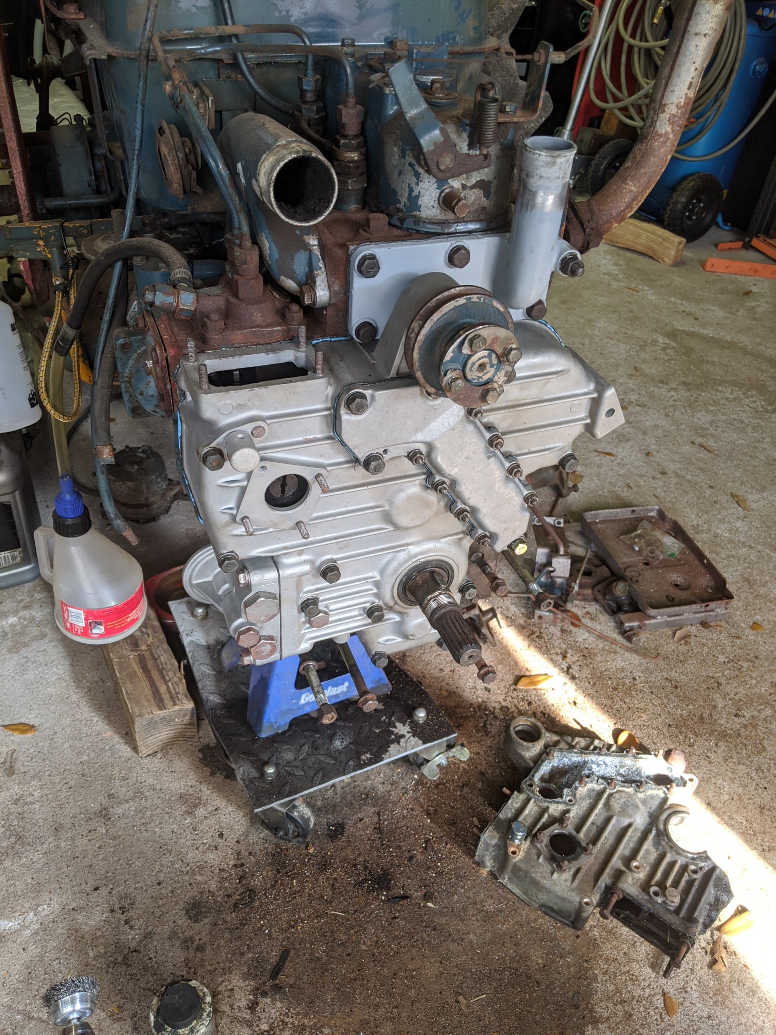

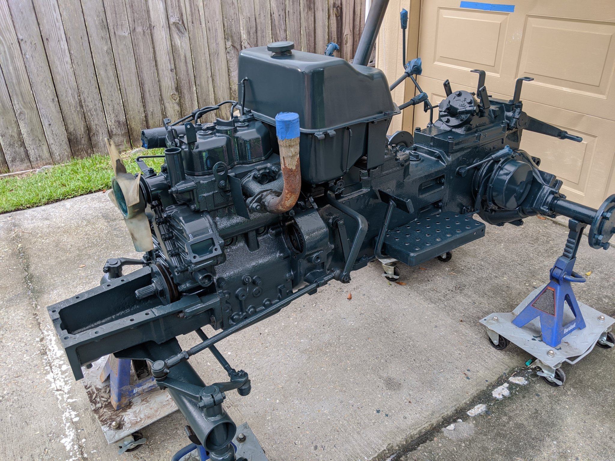

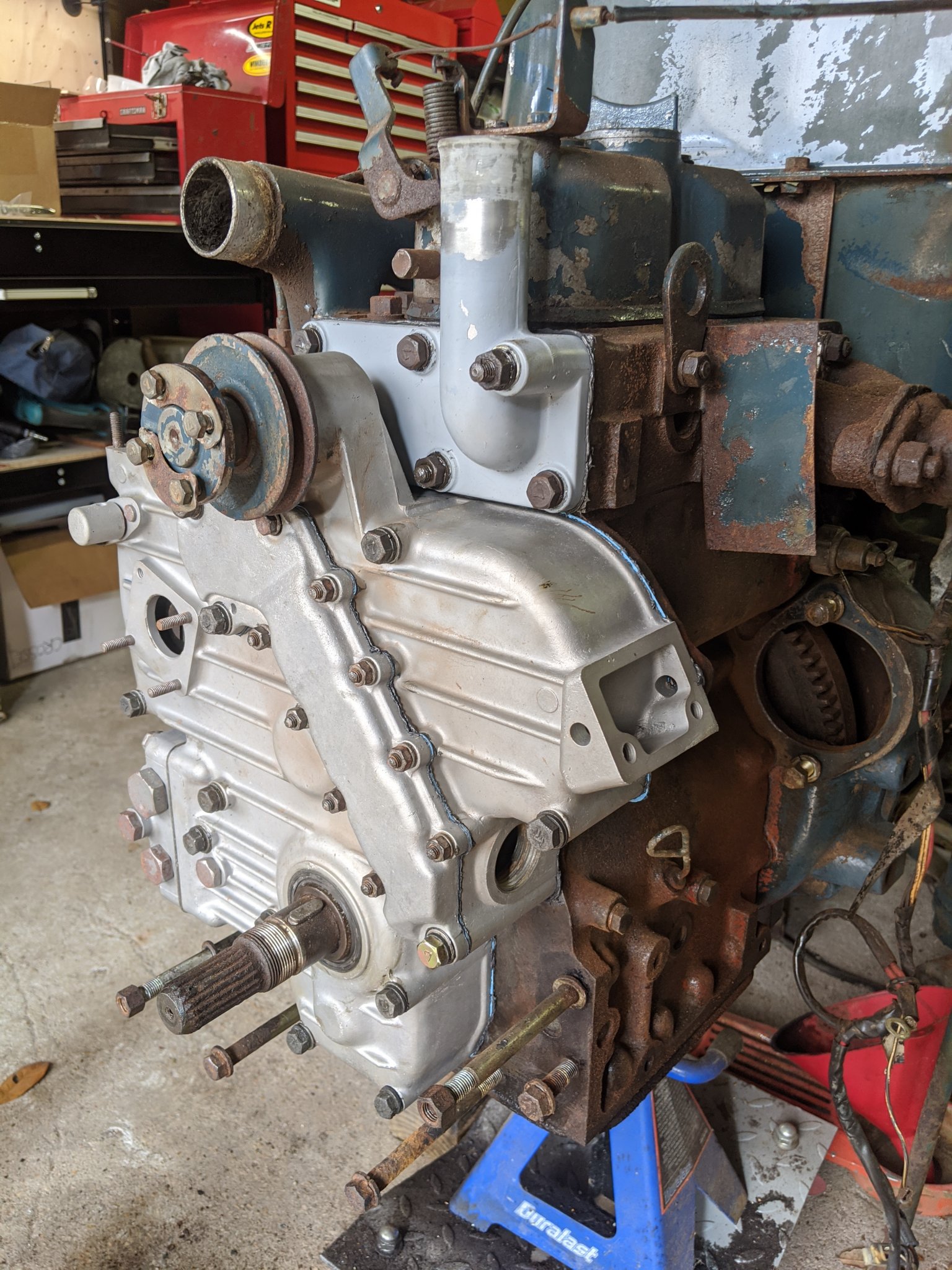

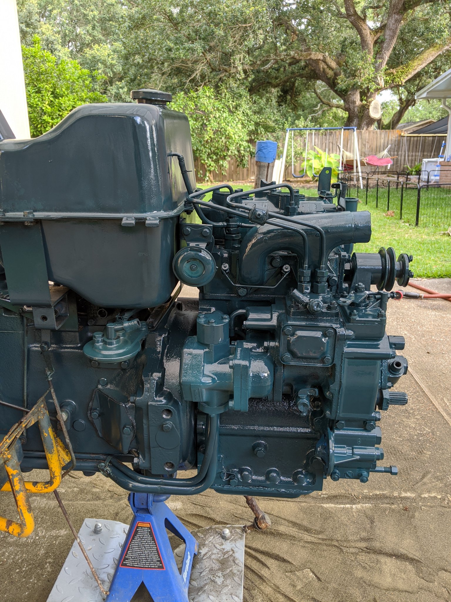

Sorry it's been a while since I've updated everyone on this but I've made good progress.
I've replaced the gear cover and water conver along with blasted everything and painted the chassis. I've installed a new (used) radiator and am waiting on new hoses and an alternator to arrive this week. As soon as I get those I plan on firing it up for the second time since I've owned it.
View attachment 48303 View attachment 48304 View attachment 48305 View attachment 48306 View attachment 48307 View attachment 48308
Coming up I need to rewire most everything and paint the body pieces. I was also able to score some used rear turf tires on rims. I still need to figure out fronts.
On that note does anyone know if there are any common wheel hubs like from a trailer that for the L1500 spindles to get away from the 4.5"x4 spindles on there now? I'd like to get it to the more common 4"x4 spindles if I could as it gives me more wheel options at more reasonable prices.
