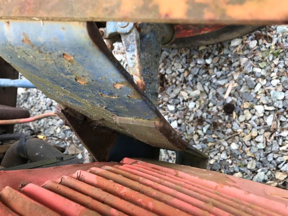

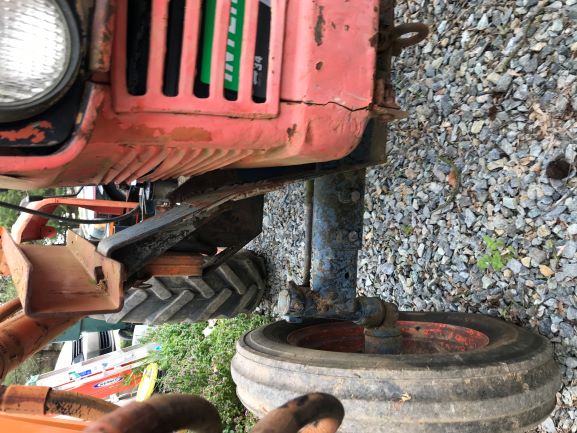

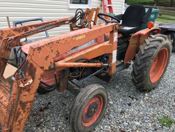

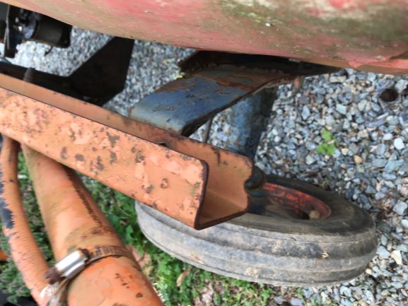

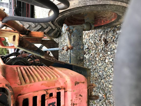

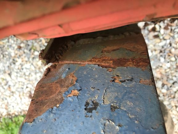

A previous owner cut the bumper off and cut back the sides of the subframe (see attached pics).

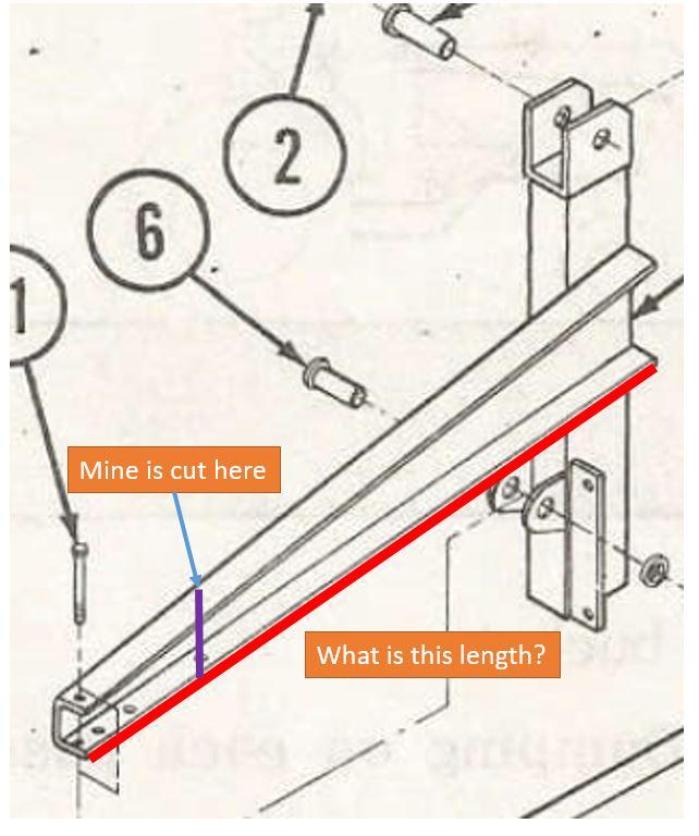

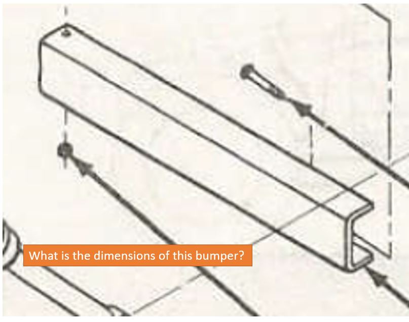

Can someone help me with the dimensions of the subframe arm lengths and the bumper size (see attached pics)? I have watched a lot of YTube videos and have searched a lot of pictures so I have an idea of how it should look and function when done, but I don't know the sizes to fabricate the missing pieces.
I have some structural work to do to this loader's front mount as it has been broken several times and crudely fixed. The loader itself is in great shape - just needs paint.

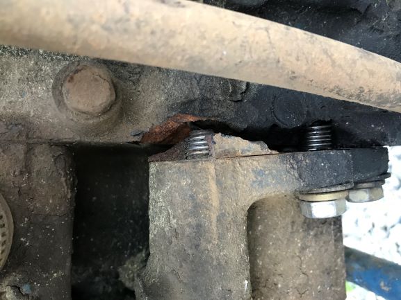

The previous owner was back dragging and caught a tree stump with the bucket and broke the front axle to engine block mount (see attached pic). The tractor is in rough shape, but it has a plate where the engine was professionally reconditioned at some point. All the parts are there so it will make an excellent parts tractor for mine. I bet the motor would run if I tried starting it.

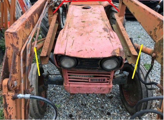

The two cut off frame rails are not sitting square to the tractor. See the exaggerated yellow lines I added to your photo.

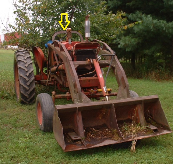

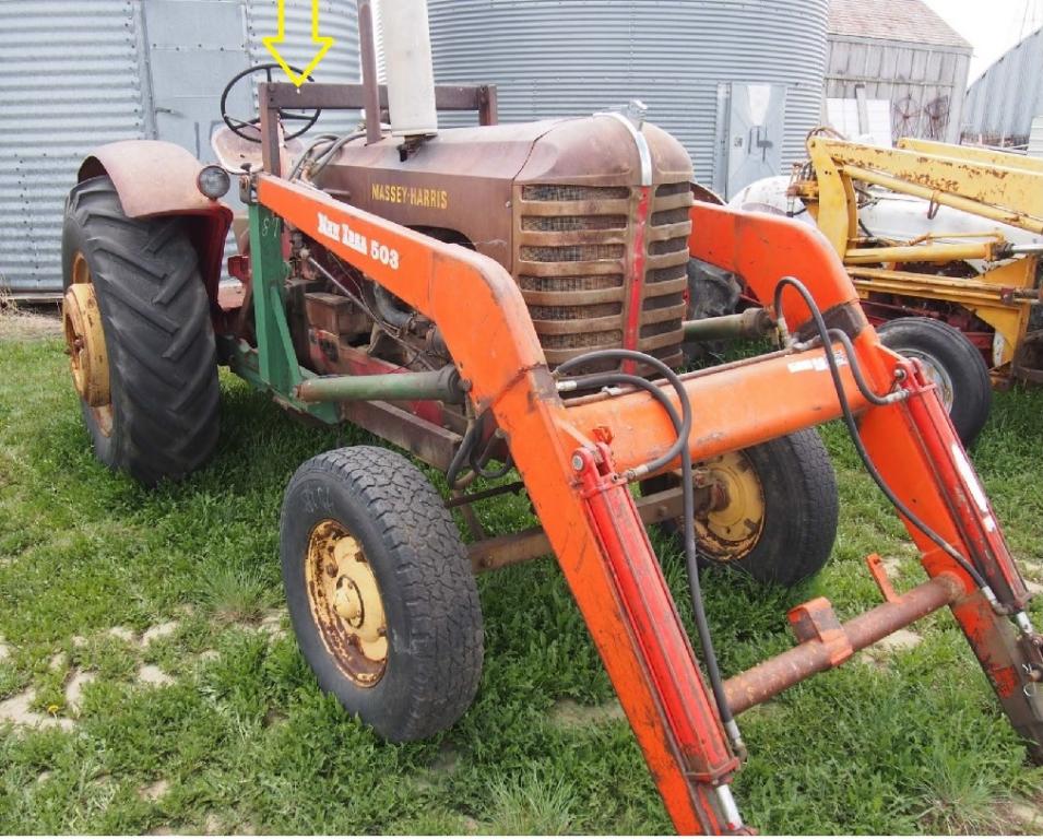

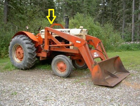

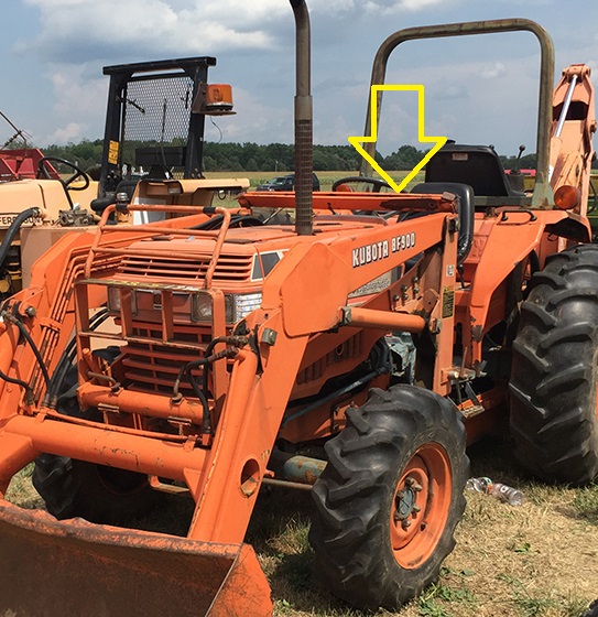

Many small tractor loader installations incorporated a stiffening arch where I have added red lines.
See photo of tractor with this feature.
As it looks right now, the two loader frames are tilted out at the top and this will compromise their lifting action.
The purpose of the front bumper is more to stabilize the two loader frame rails so they remain parallel and square.
I suggest you focus more on getting and securing the major parts together than exact dimensions. Common sense will guide you to the sizes and lengths you need to fabricate.

Yeah, I have some things I need to fix. I plan to re-engineer the braces. Without that bumper I can see where the loader arms bent and broke the front arm mount several times and it has been poorly fixed.
I'm working on some new designs for the front mounts - it has a hinge point that I think is a weak point (obviously) Where the arms attach I want to add some additional bracing from the back mount to the front mount so there is less stress on the engine block.
I see your point about adding something in the back across the top. I'm going to add that to the list of things to deal with. I did notice that there are only a couple bolts that hold the loader to the brackets.

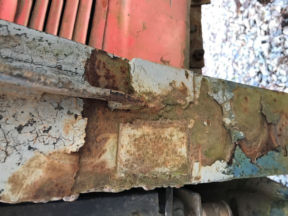

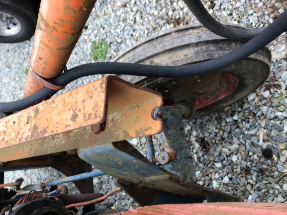

Attached are a couple shots of the front mount that has been repaired time and time again. Obviously there is a cause there that needs addressed - thus why I want to fix the loader frame and bumper.
Thanks for the input!

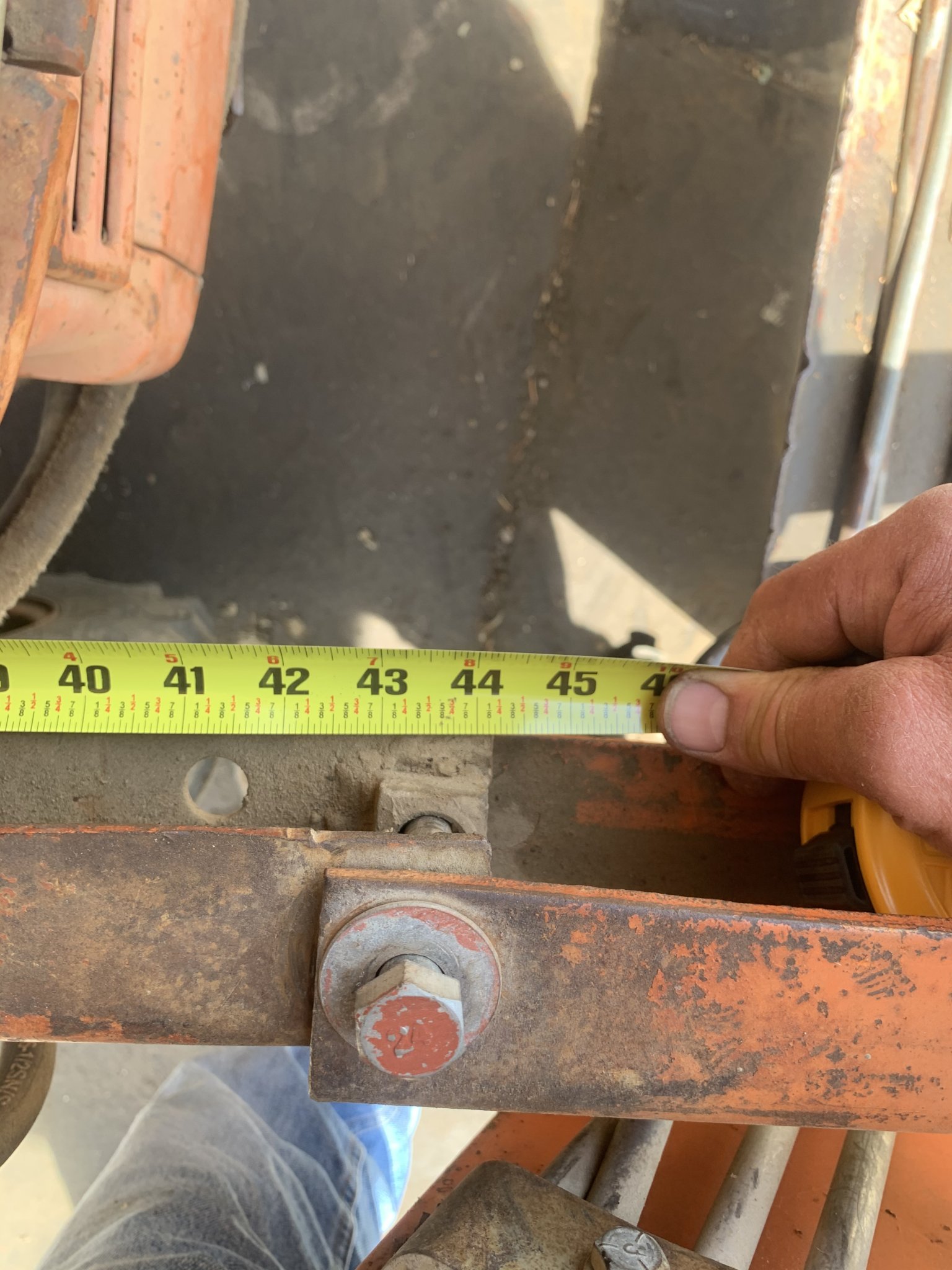

And these are the dimensions I need.
Hello Hello,
I just read your post and measured my 1200 loader, in case you were still working on it. My two pictures show the measurements you asked for. Maybe it can help someone else as well. As also said in this thread, I don not think these dimensions are critical.
It is my opinion that the left and right frame rail bars are meant to support part of the additional forces on the front axle from using a loader to pick up heavy items. I am not a fan of the way the casting that supports the front axle is mounted to the front of the block. It can either damage the block or snap the fasteners off in the block. I switched to grade five studs and put grade 2 nuts on the studs. I would rather the nuts strip off the studs than either of the other two failures.
I also think the frame rails should be beefier and have some diagonal bracing if the loader is really being taxed. I think they deflect too much before they would pickup much load.
