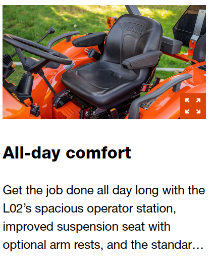

I for sure don't know first hand, but the driver for this post was this snip from the kubota site. How relative the term "improved" suspension is, I don't know lol.

At least it has arm rests. Otherwise the seat itself looks similar. If I see a L4802 on a dealer lot, maybe I’ll see if they’ll let me test drive it so I can run it over a curb or three to test out the “improved” suspension. If it will run over a 4” curb at 3mph without bottoming out and sledge hammering your spine, that’s an improvement.
One good thing about the stock seat on the 4701 is it probably increases the durability of the tractor. If you’re about to run through a hole or over a log, etc. that seat is strong encouragement to do it slowly and smoothly.

I did test out an L4802 seat a few months back, and it would be an upgrade. Much cushier.
I inquired with Messicks a while back..the part would be $542, but they couldn't confirm the bolt pattern is the same/it's a simple swap. Would love to confirm if it is.
