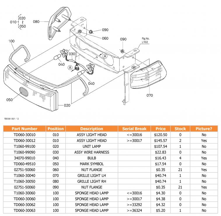

I'm just curious if anyone knows if there is any updated head light version other than the original?? The original bulbs are not very bright, and the retainer does a poor job of keeping the electrical contacts in place. I'm about ready to fashion an H3 bulb to retrofit it to a single beam that you can actually see something with. Rather than pay $17.00 a piece for bulbs, plus the retainers!!!

Don't know that I would use halogens, could it melt the plastic? But I am entrigued by the thought of LEDs. Sound expensive though. I agree, the headlight is weak. I've been thinking about some way to put floods on top of the guard, sort of like a snow plow. If you do a conversion, post it up. Not seen any in my searches.

I like this idea. Since my tractor is in my shop right now, I'll take a look this evening and see what the bulb bases look like. If they're standard auto style bayonets, a swap would be easy.
All I could find on the head light for my L3830 was the part diagram. At $16+ per bulb times 2, I'll consider LEDs.:D
