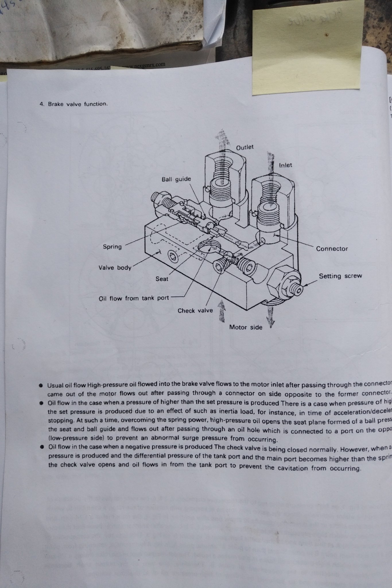

Here is a pic of the brake valve. My WSM covers kX 36 up to the kx 151. What are you missing in your ism?
Thank you for that. Actually found that page after posting my question to you. I need to take the time to try to understand what that brake valve does. At first look it appears to be some kind of check valve assembly. I take it there is no actual physical brake involved.

I think some refer to the brake valve also as a counterbalance valve. I was speaking to a mechanic. His recommendation is to install a test T on both lines on the right side and a then left side and compare the pressure values. Will give that try tomorrow. I have the manual on a stick from Kubota Canada so if you need anything I can try to send it in a zip file.
