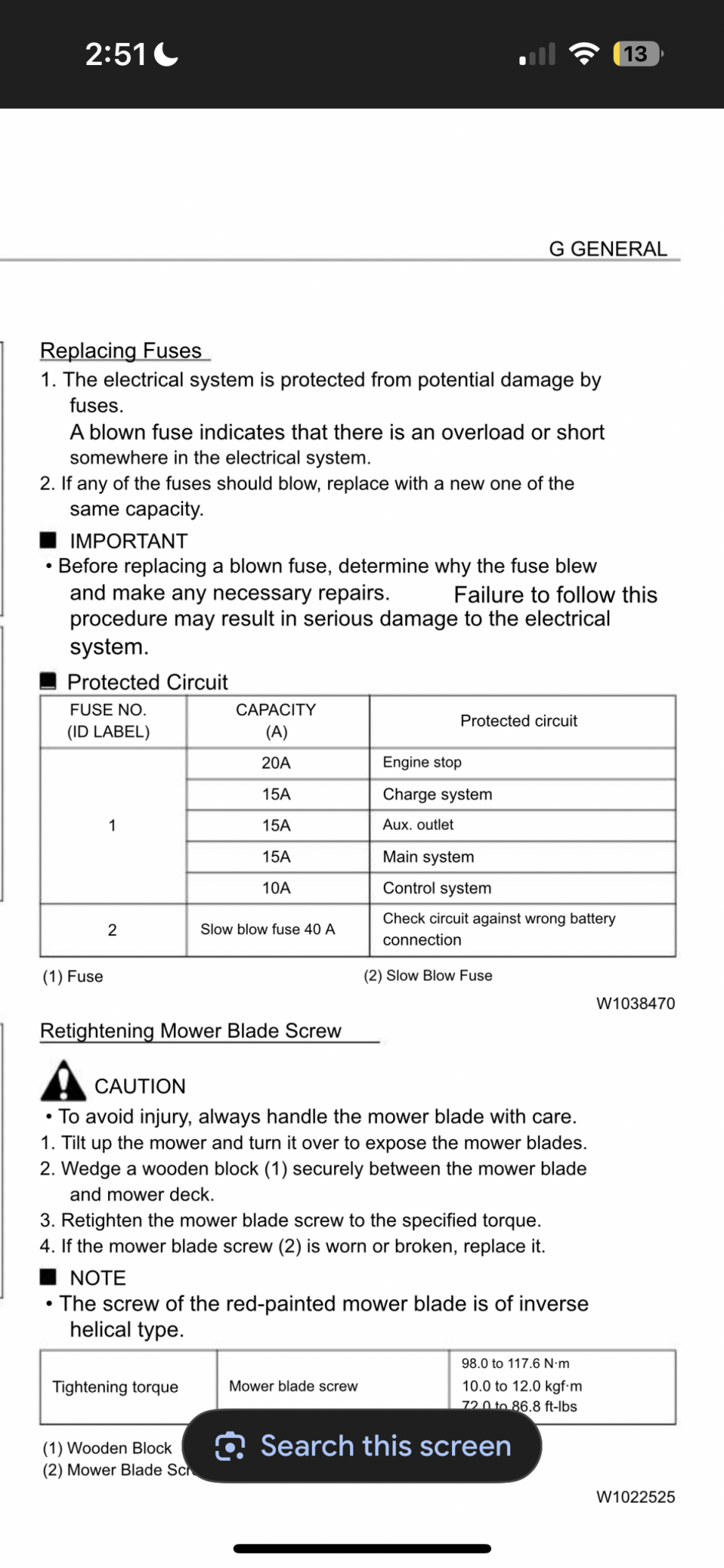

Anyway. We looked over all fuses, wires, groundings and all seemed fine?

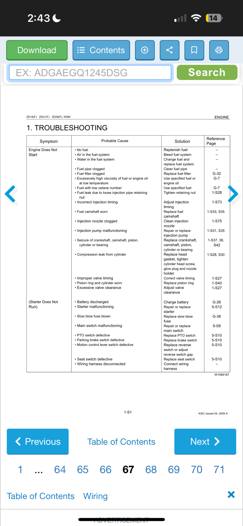

What you need is schematics which may be in the operators manual or in the work shop manual.

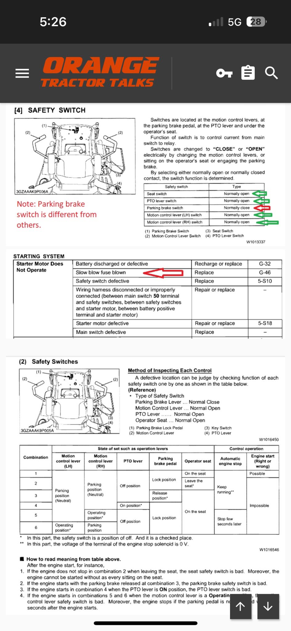

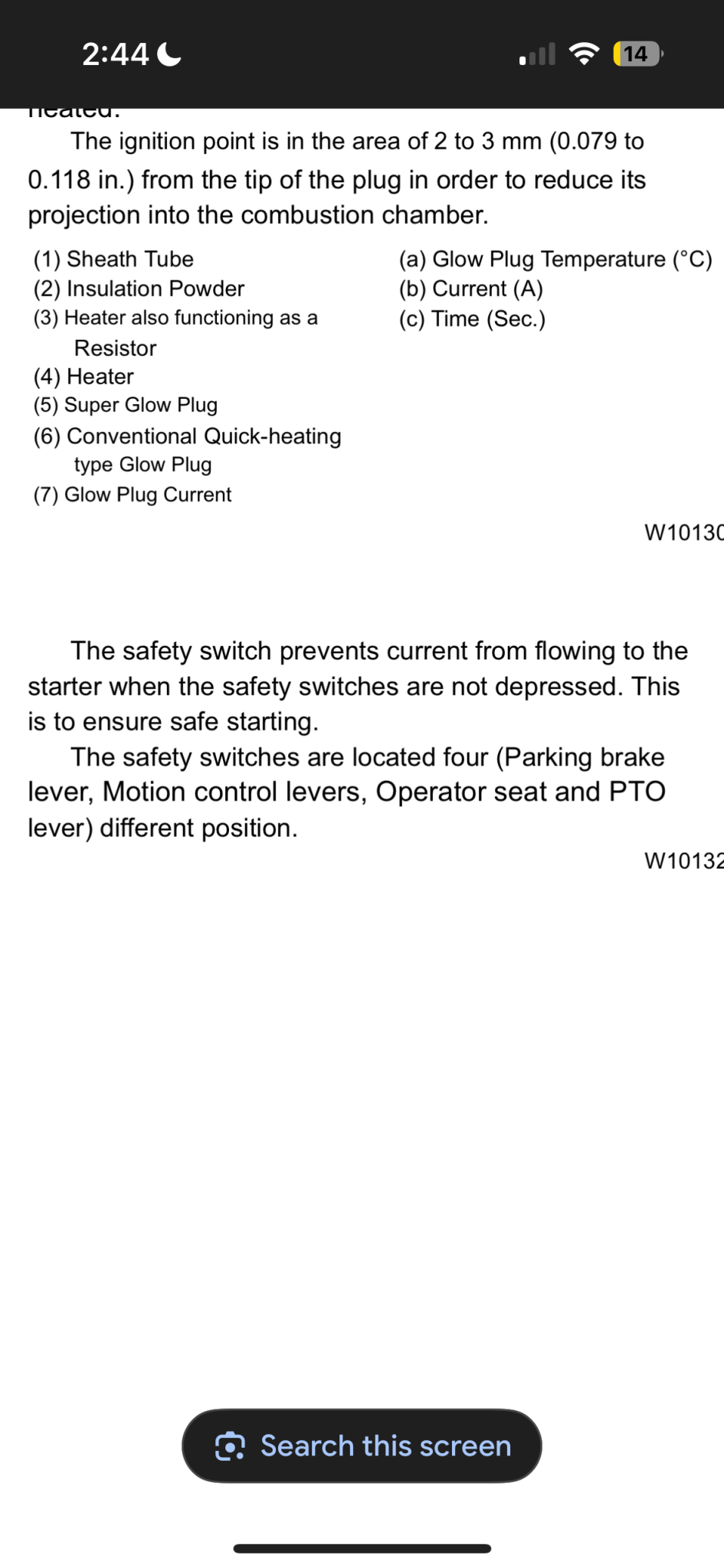

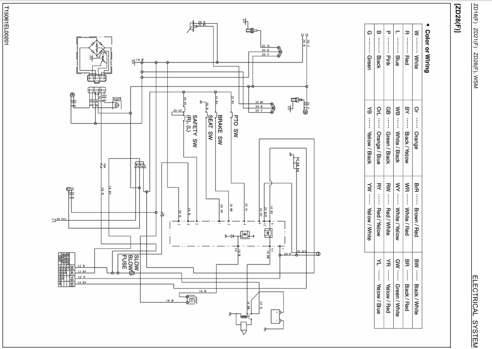

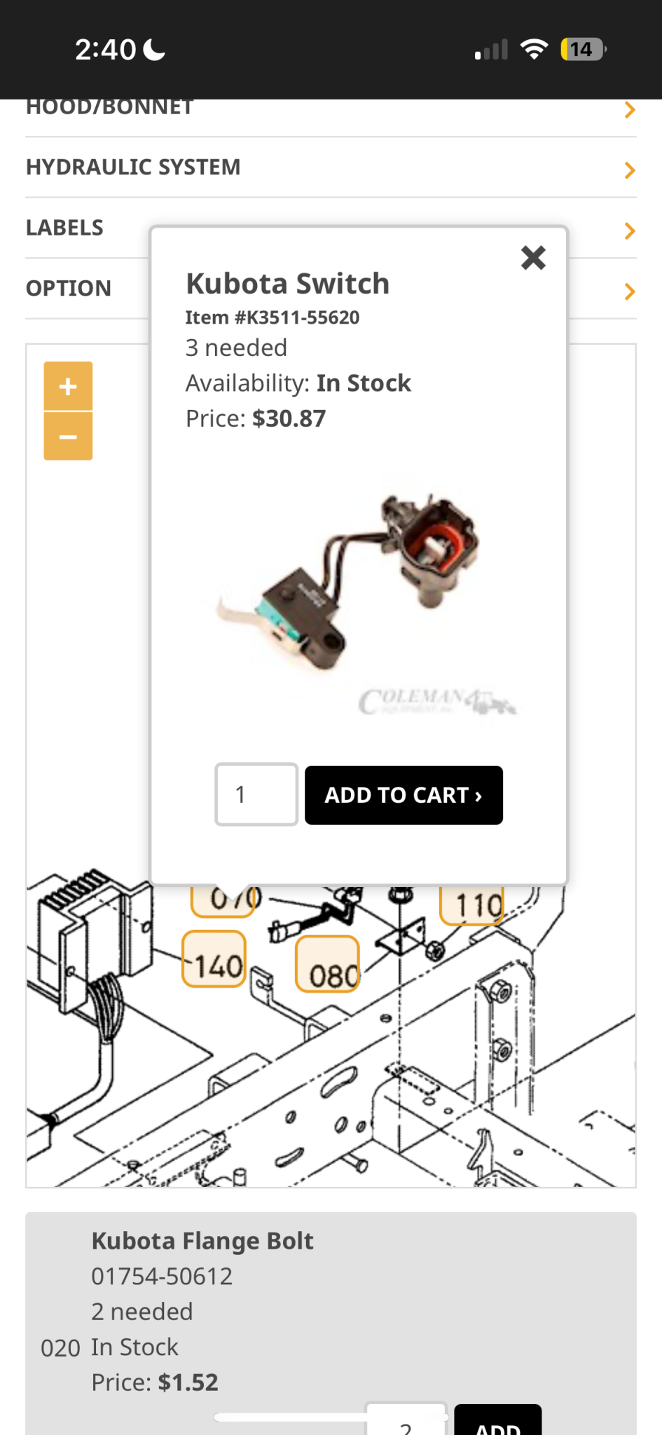

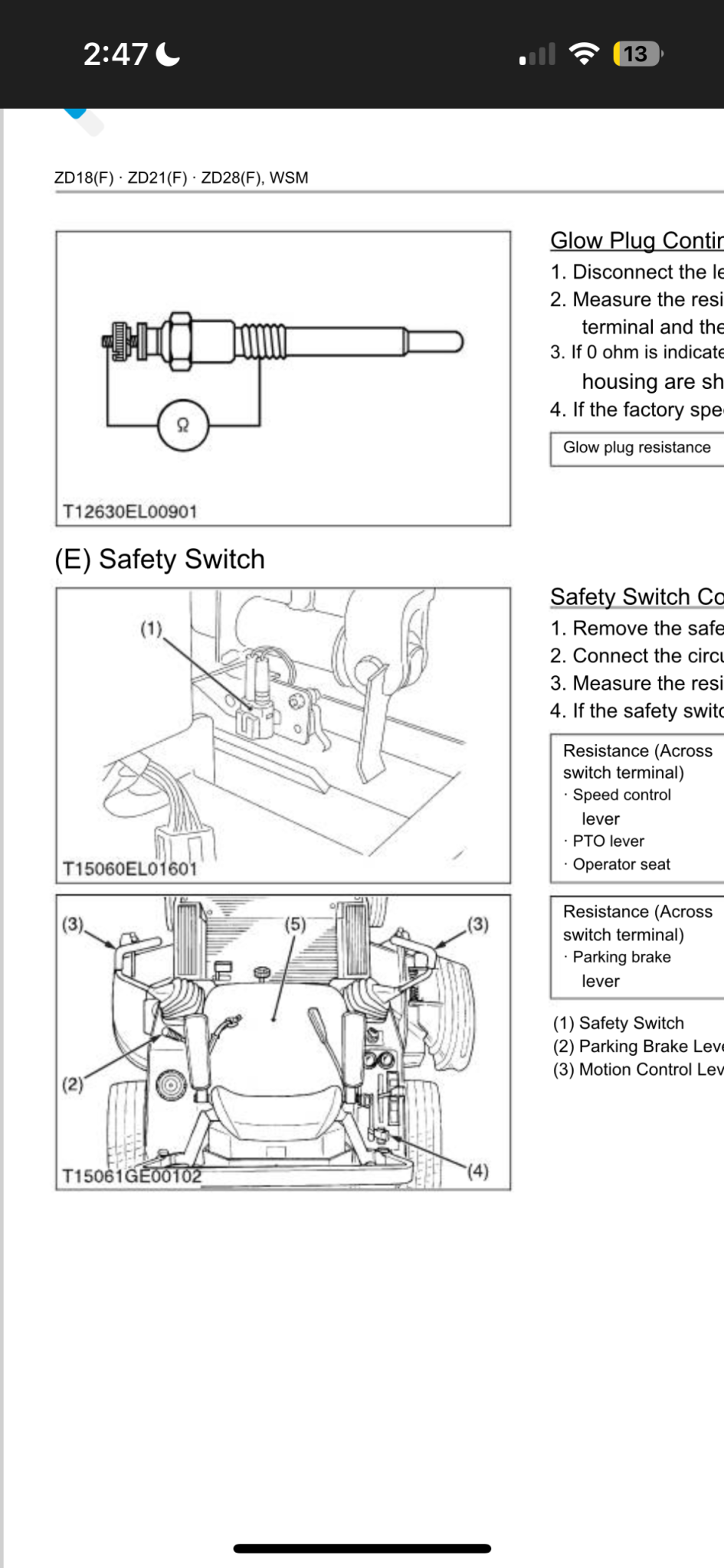

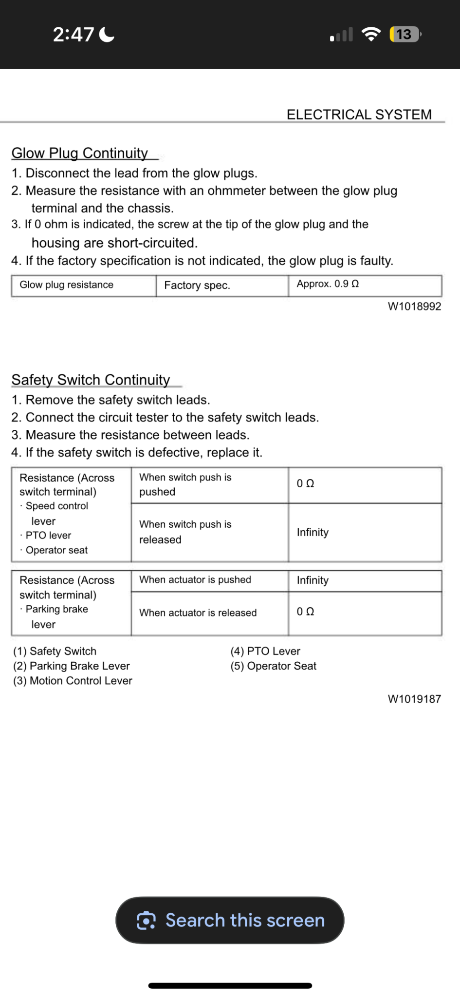

Attached are the images I was going through and using for diagnosis. It’s got to be something simple I’m just over looking. (I hope)

Do you have a multimeter? If not buy one, a cheap digital one can be bought for under $20 and they are pretty good. Just unplug the switches and test the resistance individually, lowest Ohm range.
And the switches I know need adjusting mechanically, so you have to put them in that the switching point corresponds with the mechanical movement. Check that since after replacing the PTO switch it never started any more.
And make sure there is enough margin in it. So PTO released there should be low resistance (switch closed, close to 0 Ohms) but when you engage the PTO make sure the switch stays closed for a bit of lever movement, not that it opens when you barely touch the lever, otherwise you may get intermittent faults again.
12,948
5,680
one test to do.
remove connector on PTO lever
connect DMM to the switch (need to make extender cables for meter of course...)
set DMM ot 'beeping OHMS'
move PTO lever on-off-on-off
DMM should beep when switch closes.
If it doesn't ,then you'll have to bend the 'tab' on the lever to push the plunger on the switch or adjust the position of the switch

Here is a wiring diagram for your ZD28.
