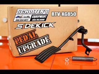

I have been working with my dealer on this issue but haven’t gotten very far. They ordered a replacement part, the bracket that holds the gas pedal arm, but it was identical to the original bracket. It was my understanding from reading all the posts on this issue that the fix is a redesigned gas pedal arm that is longer then the factory pedal arm. Is this correct and does anyone know the part number? BTW, I found a dealer in Washington that sold a redesigned pedal arm but they had to stop selling it because Kubota sued them for patent infringement, see attached image. So where is this part Kubota?
