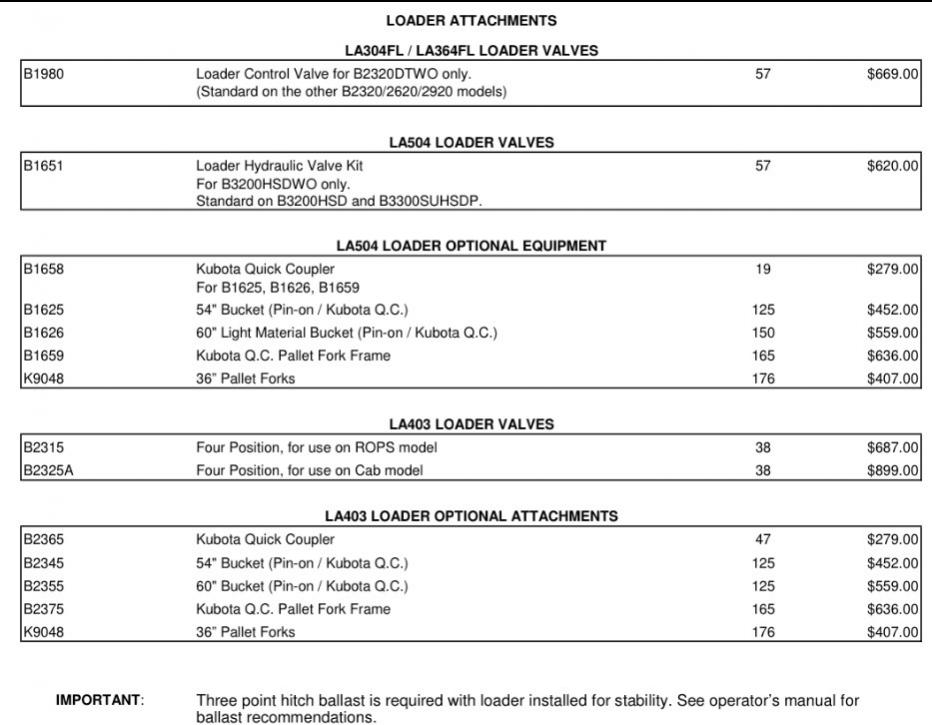

I've got a B3200/LA504 loader with the Kubota OEM Quick Coupler. I want to to get a pallet fork attachment but I don't want to use the skid steer quick attach. (It's $700+ for the adapter)
Does anyone know the model number for the Kubota OEM pallet fork attachment? I searched all over online and couldn't find it anywhere.
Thanks

B1659 is the frame and the forks are K9048 according to this price list.

Before I forget, Burtonbr, thank you! That's the exact info I was looking for.
