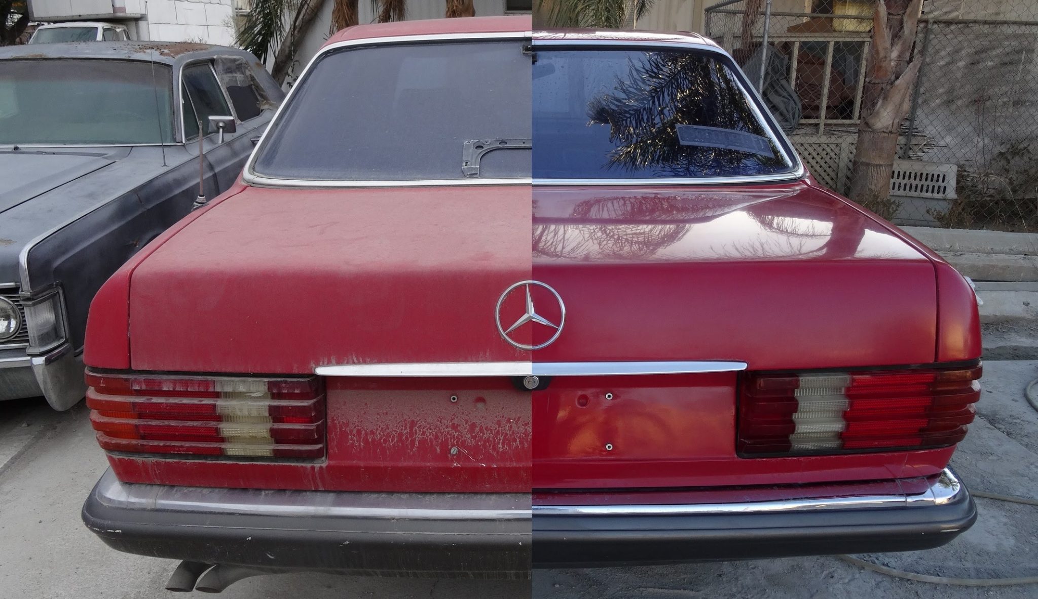

You are correct - the topcoat has oxidized from sitting outside in the sun, buff it out with a polishing compound. Don't over do it being too aggressive and burn down into the paint, use a mild compound, if that doesn't work then ramp it up to a heavier compound.
Give it a good waxing after. (picture is an example off the web - not my car)
