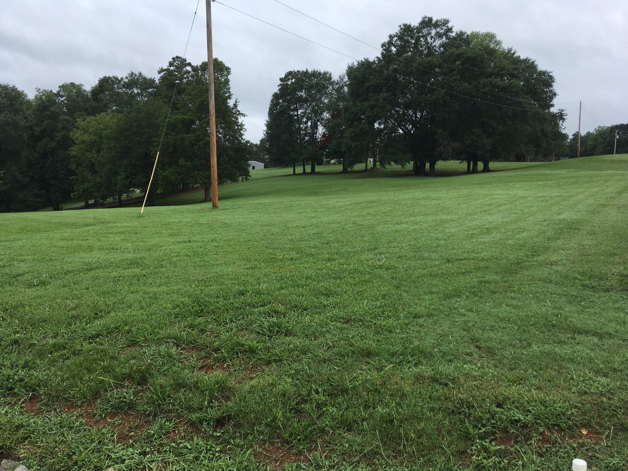

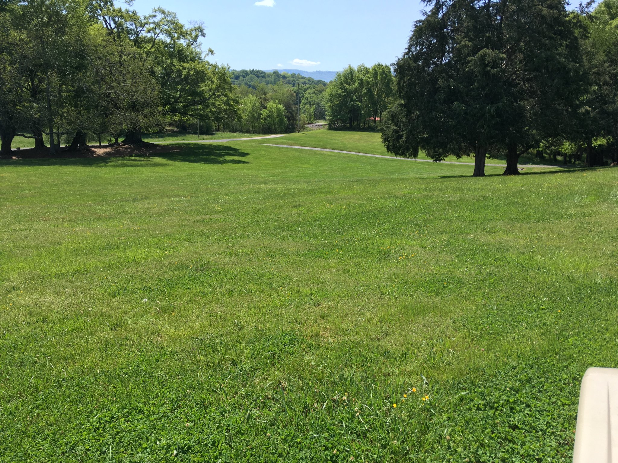

I use a 60” deck on a 2601 which is a suspended deck and the place looks like a golf course. Until the drought shows up. IMG_0935.jpeg IMG_1072.jpeg
I don’t mow wet grass either and I can’t use a zero turn here due to some steep areas. I have r 4s and they don’t tear up at all. It’s a little heavy though so I try not to follow the same tracks all the time.

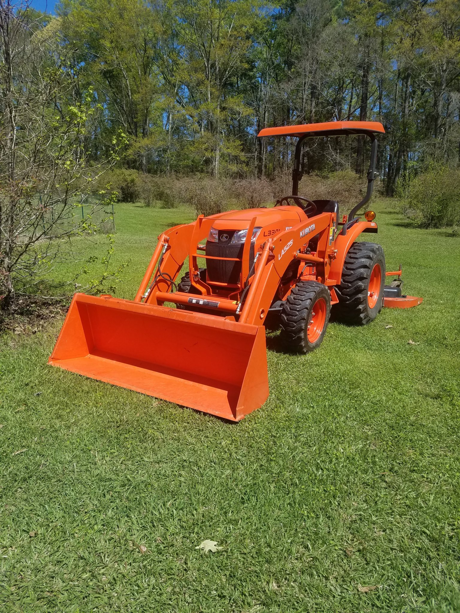

I cut with a fdr1672. Always looks great. Got R4s on my 3301 and 3560. Never have any issues tearing up grass unless its too wet, or turning too tight with 4wd engaged.
Also, I generally cut with my loaders off. Here's a terrible pic but the grass is still mostly on point.
